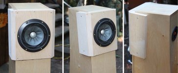

If you do decide to add a supra-baffle, you should consider hogging out a bit of the existing baffle to allow "breathing" room through the material of second layer - something like this - new part for our flat-pak kits - allows for attachment of supra-baffle plates via threaded inserts ( excuse the nasty camera photo)
Cool - the supra-baffle is fitted directly on top of this, or a layer of weatherstrip foam goes in between?
Also can you post a pic of the supra-baffle also please? (assuming it is ready)
Yes, some sort of gasket goes between the sB & the baffle. It should be thing,
I was going to take pictures of the prototypes today, but ended up going out shopping for sexier M4 bolts to hold it in place.
There are some not so close-up shots in the VI diyFEST photos, to shoehorn FE138eSR into FH3 we had to add the sB
Maybe pictures tomorrow.

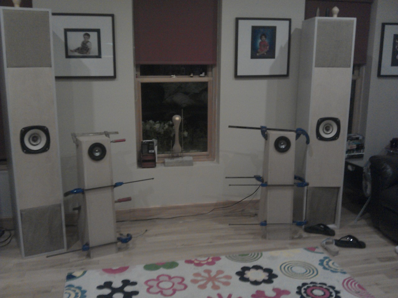

Alpair 7s arrived yesterday and hopefully we'll have a test assembly tomorrow night!!
Those alpair 7s certainly look the part, very nicely made indeed, although somehow smaller than I expected. Lovely looking though. And the grey is actually a metallic grey colour, not at all unattractive.
Fran

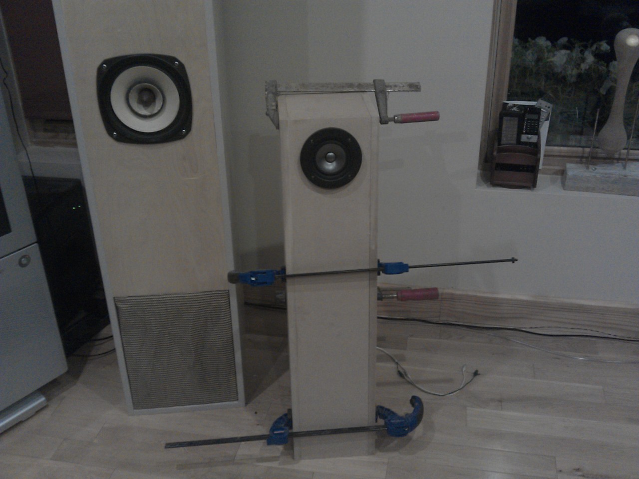

Anyhow I got my set hooked up tonight!!!
Sound is very impressive for drivers out of the box and given that its a quick lash up. Specifically, the bass is very good, tight and nicely textured. I imagine I will end up playing a bit with the stuffing, but just as it is, its pretty much good to my ears.
My only gripe right now is that there is a very slight edge to some treble. Example: rimshots or cybals sound a bit "splashy" if you know what I mean. However, as I said, these are drivers literally cold out of the box, and no doubt they will improve during run in (alpair 7s).
I'm impressed!!!

...a very slight edge to some treble
Are the drivers rebated? And the backside of the cutout?
Breaking in won't hurt either...
dave
In some of the 3rd party measures you can actually see the reflections caused by both of those, so they are likely audible.
dave
dave
Mmm. I can rebate the inside edge easy enough, but it will probably be easier to make a superbaffle than cut a rebate to seat the driver flush. I need to read up on your experiences on this so far!
