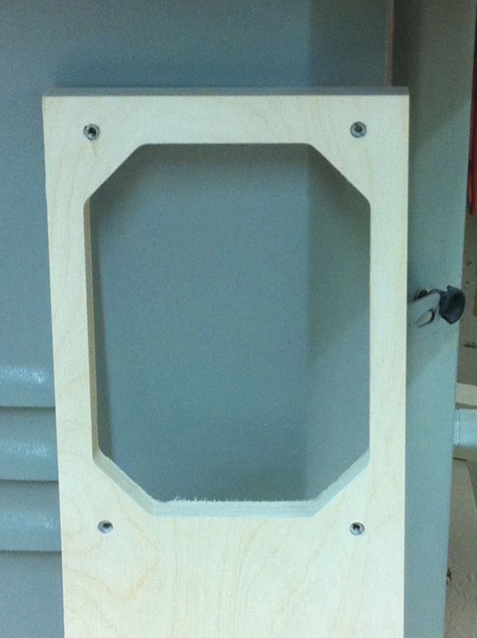

The issue I ran into when test-fitting the CHP was that I had sized the cutout for the Fostex just liberally enough that the CHP's mounting holes are necessarily far too close to the edge of the hole -- there is not quite enough material to screw into. This shouldn't be too challenging to fix, especially if a supra-baffle is employed.
If you do decide to add a supra-baffle, you should consider hogging out a bit of the existing baffle to allow "breathing" room through the material of second layer - something like this - new part for our flat-pak kits - allows for attachment of supra-baffle plates via threaded inserts ( excuse the nasty camera photo)
