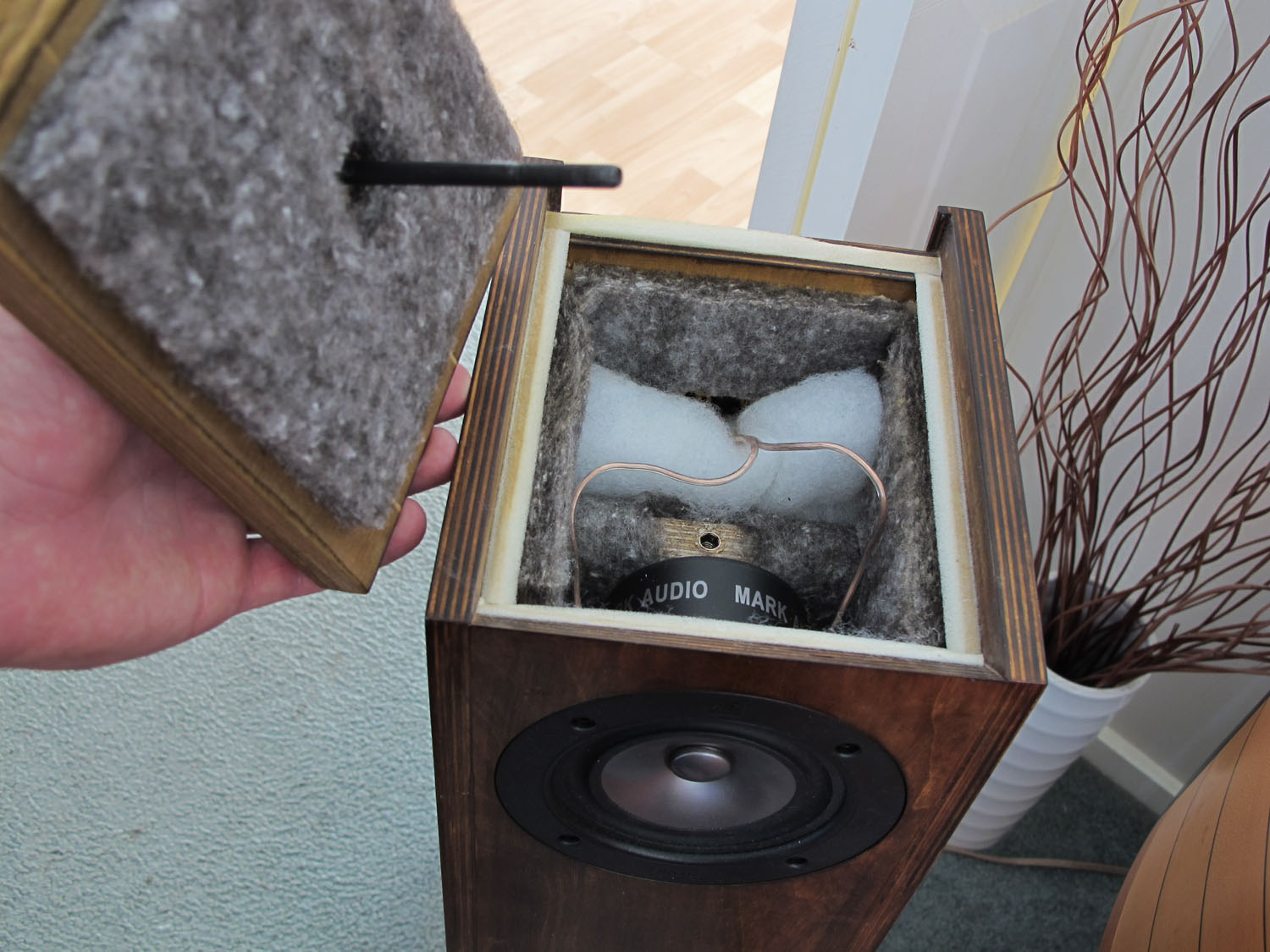

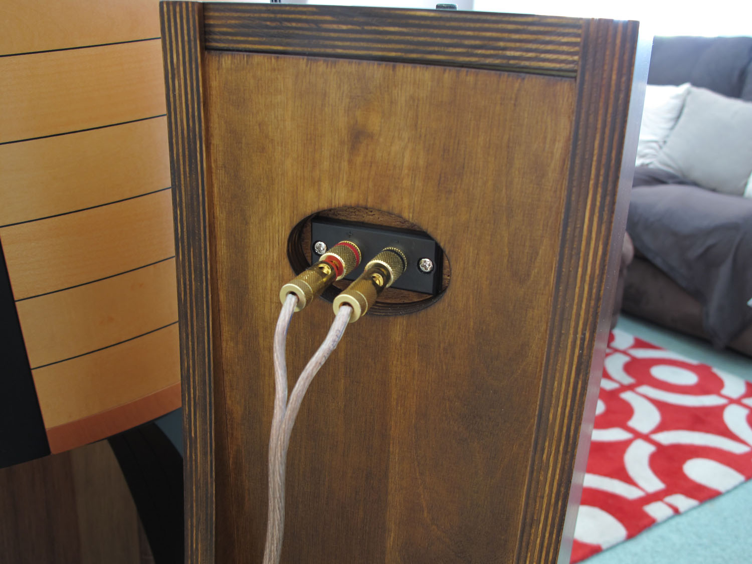

I've had my pair going for a few months now so it's about time I posted some pics and feedback.

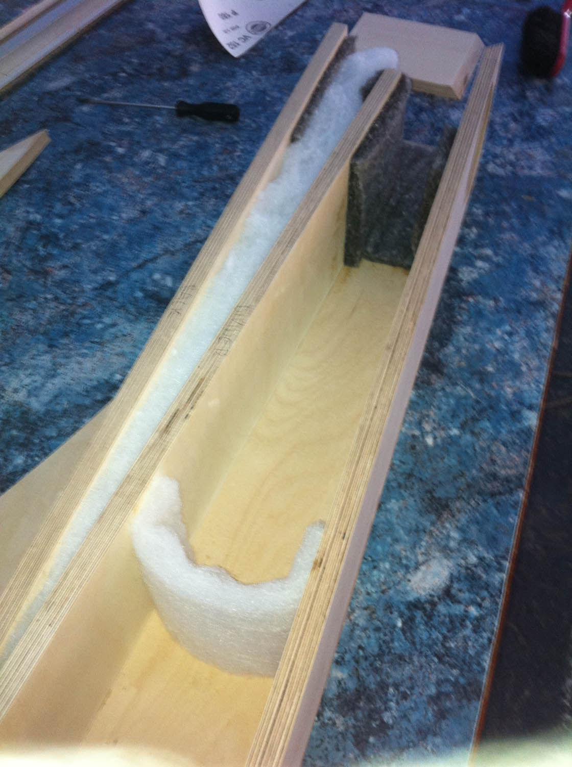

Although I did all the stuffing as per instructions and post #424, with the removable lid I ended up taking all stuffing from the front chamber so it's left looking like my first pic here. I dont find it's too boomy at all, the bass now matches the mid/highs just nicely. In saying that, they are not in the perfect listening position just now. I'll soon be moving them to my back room where they'll be sitting a good distance from the wall and nicely in a corner. This may require some stuffing placed back in, but thats why I made the top removable hay 🙂

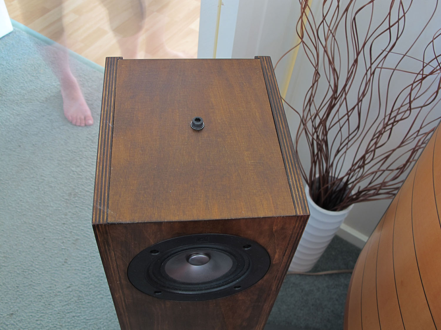

I'd recommend the method I used for the top lid removal. One M6 bolt into a self tapping timber thread insert. You need to do a bit of sanding till the lid fits snugly, but then it's access in seconds. I used self adhesive foam strip designed for door draft sealing to form a gasket. If you glue a "gate" of stuffing across the base you can just drop in or remove stuffing quickly and easily (you do need to remove the driver first of course).

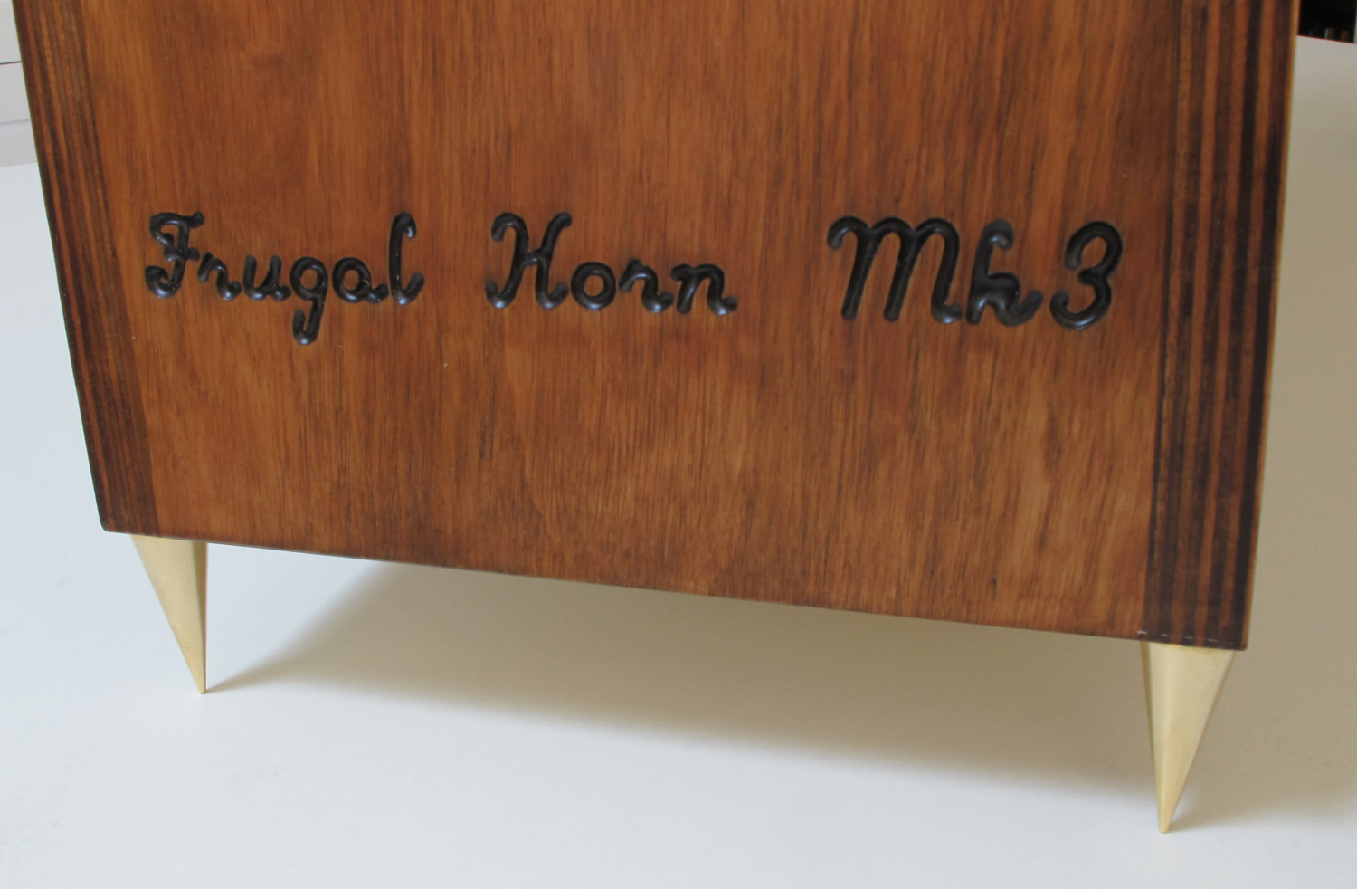

I was going to make some feet coming out for the floor spikes but ran out of time. They're very steady with them just fixed to the four corners how it is.
