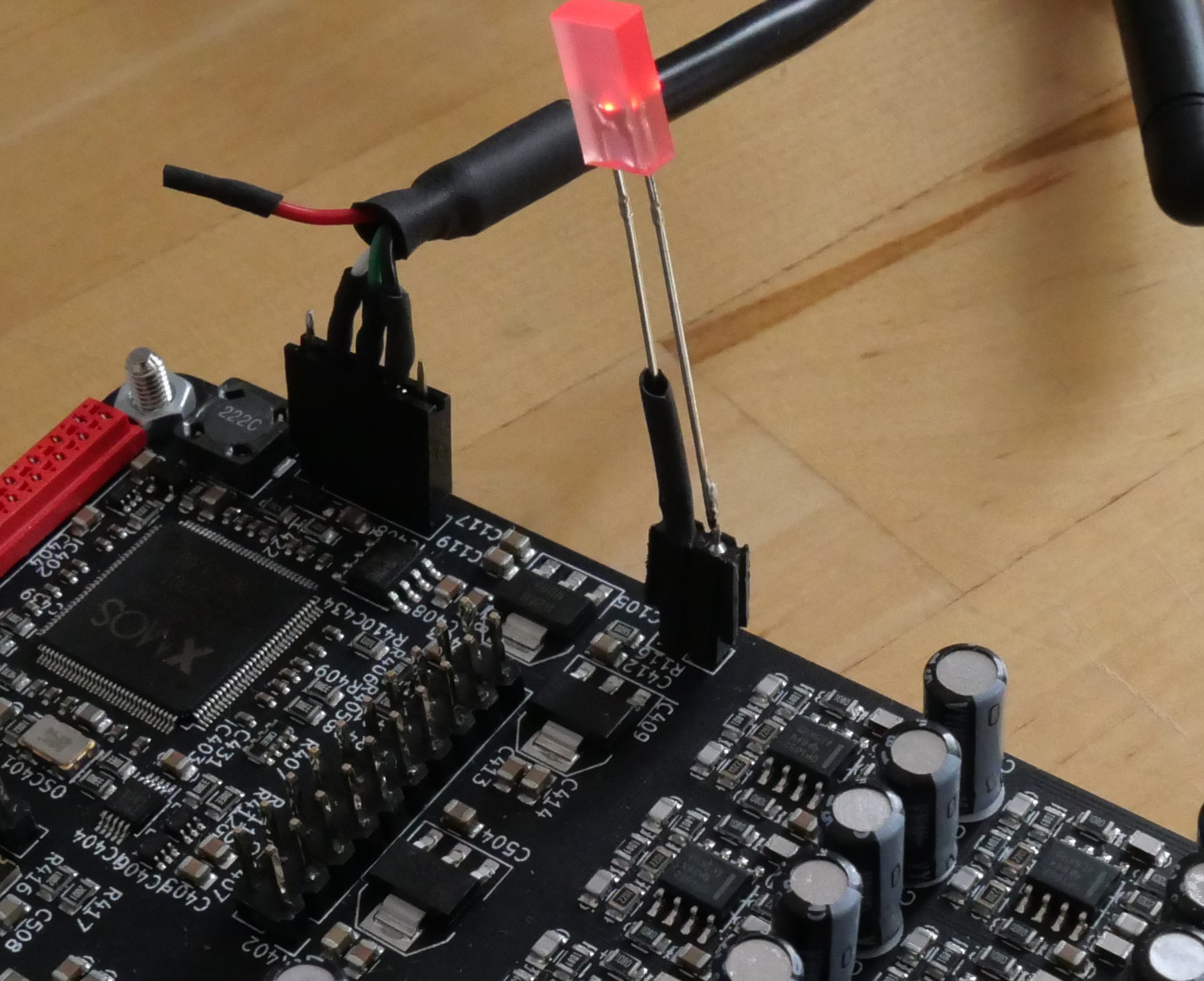

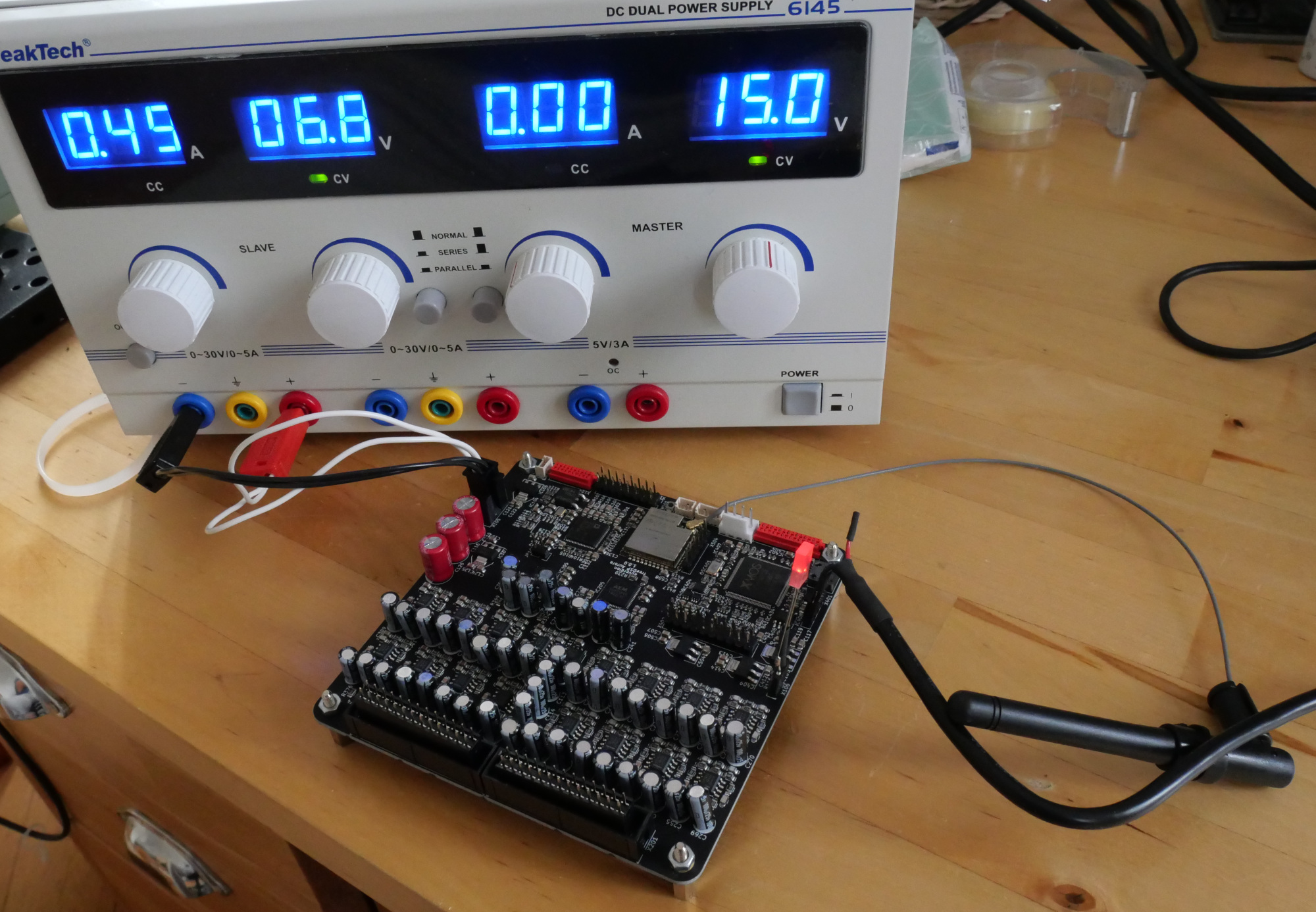

2 problems
Hi Raphael,
I received your board - thank you.
I have/had 2 problems with the board:
1. My first connection attempt via Wifi Access point worked.
Then I tried to put Aurora in my Wlan network, without sucess.
Maybe I have entered wrong access datas.
I then tried to connect again via Access Point.
But this connection always broke off so fast, that I could not connect to the program anymore.
After a day I tried it again and then I could still connect. Now Wlan works to.
Can it be, that with entered Wlan Data the access point connection time is set to short?
2. Till now I'am not able to connect USB to the board, not in Win10 and not in linux. lsusb recognizes no new device. I made a photo of my adapter cable to your board. Do you have an idea, what is wrong?
I think you should connect the red cable.
Regarding the wifi: Please double check wether the antenna is really connected. Or move the cable a bit. Sometimes radiation from other sources like SMPS Power supplies are picked ups by the antenna cable. But usually unstable wifi connections are caused when the antenna cable is not well connected with the ESP32 module.
