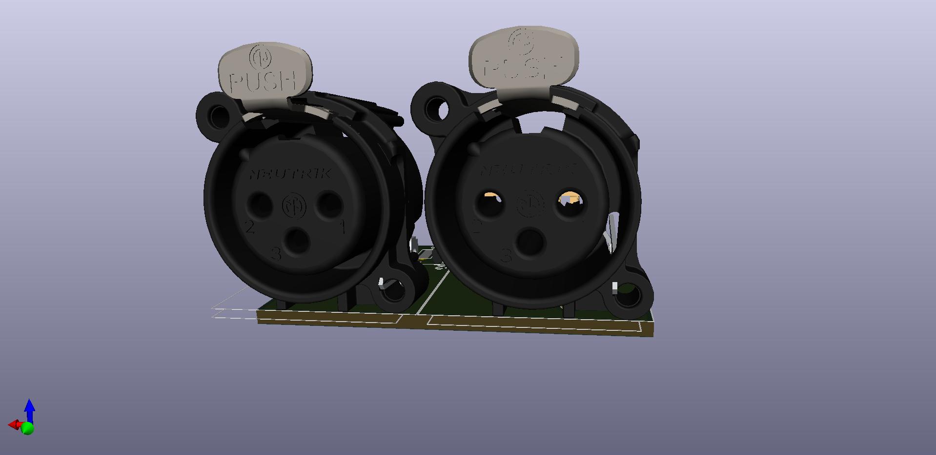

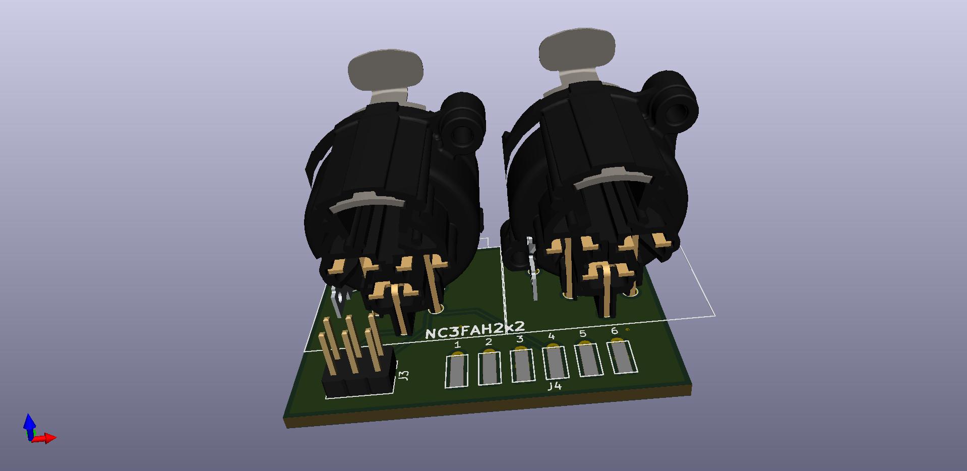

Here is my take on a simple and (hopefully) cost effective way to build a "custom" input and output solution based on the "FreeDSP_analogIO" type connector found on the FreeDSP Aurora.
Yes this is very simple. Yes it's somewhat pointless because you could also purchase chassis mounts. You could also solder directly to the pins and bypass the PCB altogether. But I think this is more robust. I also think that the PCB connectors are cheaper than the chassis connectors. I hope that the cost of the connector and the PCB is less than the chassis mounts, time will tell.
The concept offers a header pin for a 6 pin IDE, or you can solder some bulk cable to the board directly via the solder pads, and then on the other end of the shielded wire lead you can put on some "pololu" crimp connector housings. Use either 2x3 pin or just straight up 1 pin housings.
I didn't include any EMI filters on the board but it's pretty straight forward to add though, this is just version 0.5 in order to get my idea out there. The idea is to cover most of the main connector types that users would come across, and make these boards all open source on github.
PS - the addon boards on the aurora use NC3FAH footprints. There is an NC3FAH2 that just adds one more hole. It's worth adding that hole to the footprint in case you want to use the v2 models.
Thoughts?
