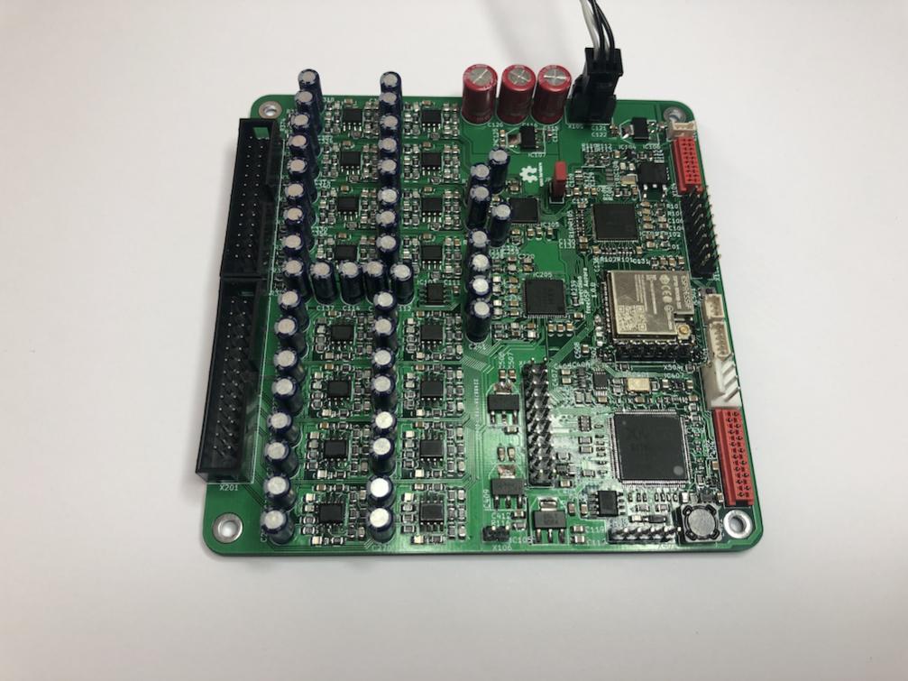

Good news: The pre-series sample arrived this week and it is working as expected. Now waiting for the money transfer from kickstarter and then we can go into production!
Regarding the Add-Ons: They are still under development. As soon as they are ready I will shout it out loud, very loud. 😉 Atm the DSP board has the highest priority. For the preliminary specifications of each Add-On please visit the kickstarter page.
Keep on rocking!
Raphael
