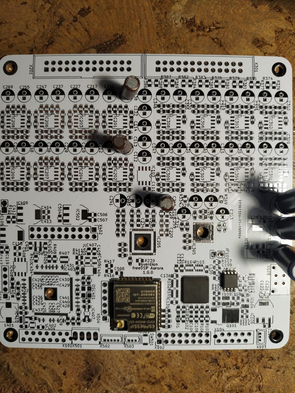

Hi
im trying to get my self build free dsp aurora working i have succesfuly programed the ESP32
but im not getting any audio trough
i did run it for a bit on 12v (old documentation)
when i try to program it from sigmastudio and i press the link compile download button i get a comms failed error
if i mesure the 3.3v line i get 3.12V
the SDA and SCL lines both get pulled to 3v
any suggestions ?

I was using a freeusbi programmer I bought on ebay.
I mesured my clock with a scope and found that I didn't have one so I replaced my crystal and dsp.
im going to mesure again when I get acces again to the scope. becous at the moment i still can't progam the dsp.
Arne
Arne
After mesuring i now have a clock on my adau1452 and see i2c communication.
But wen i try to progam with the freeusbi programmer i dob't get anything on the i2c bus so i thinking at the moment it is a driver related problem.
Im using win 10 1809
Usb2connetion
As far as i know the jumpers should stil be on
Sigma studio sees the programmer but gives comm fail when try to program
If you have any suggetions let me know
Arne
Usb2connetion
Arne
