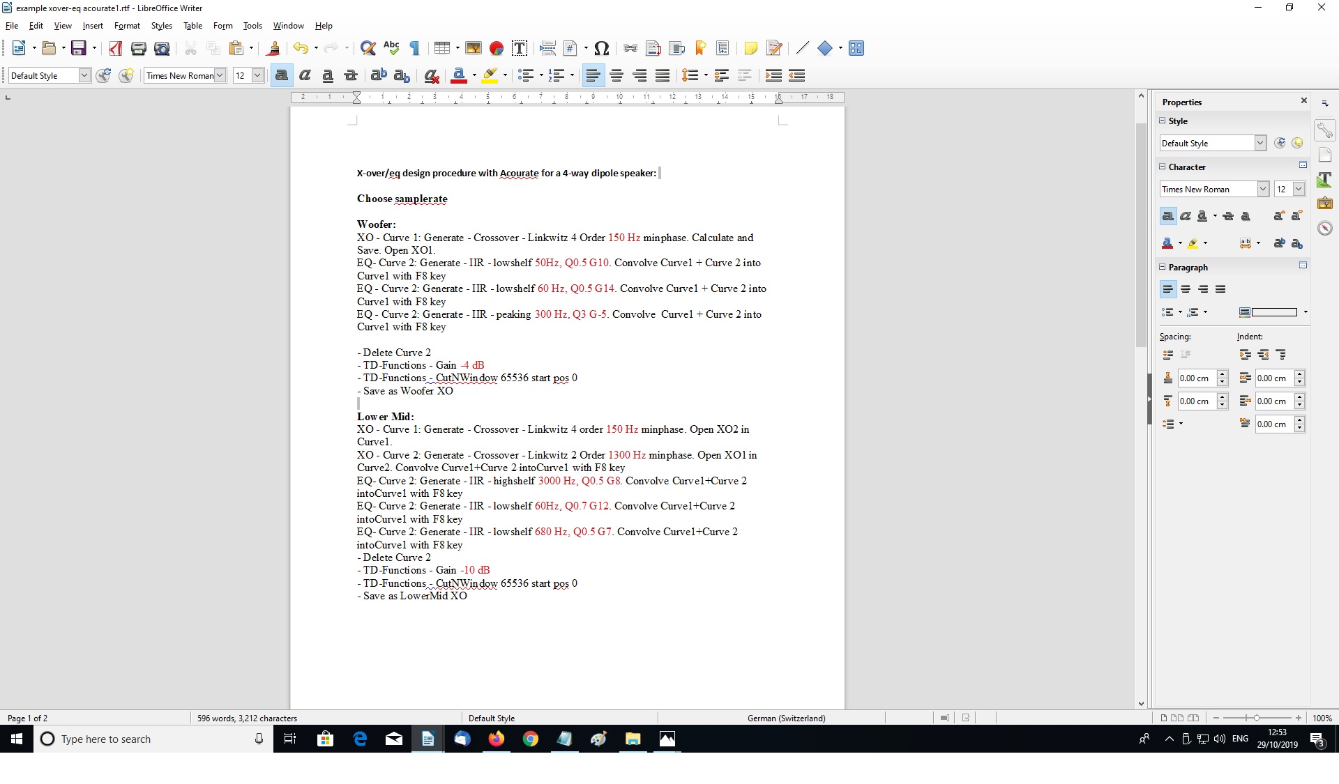

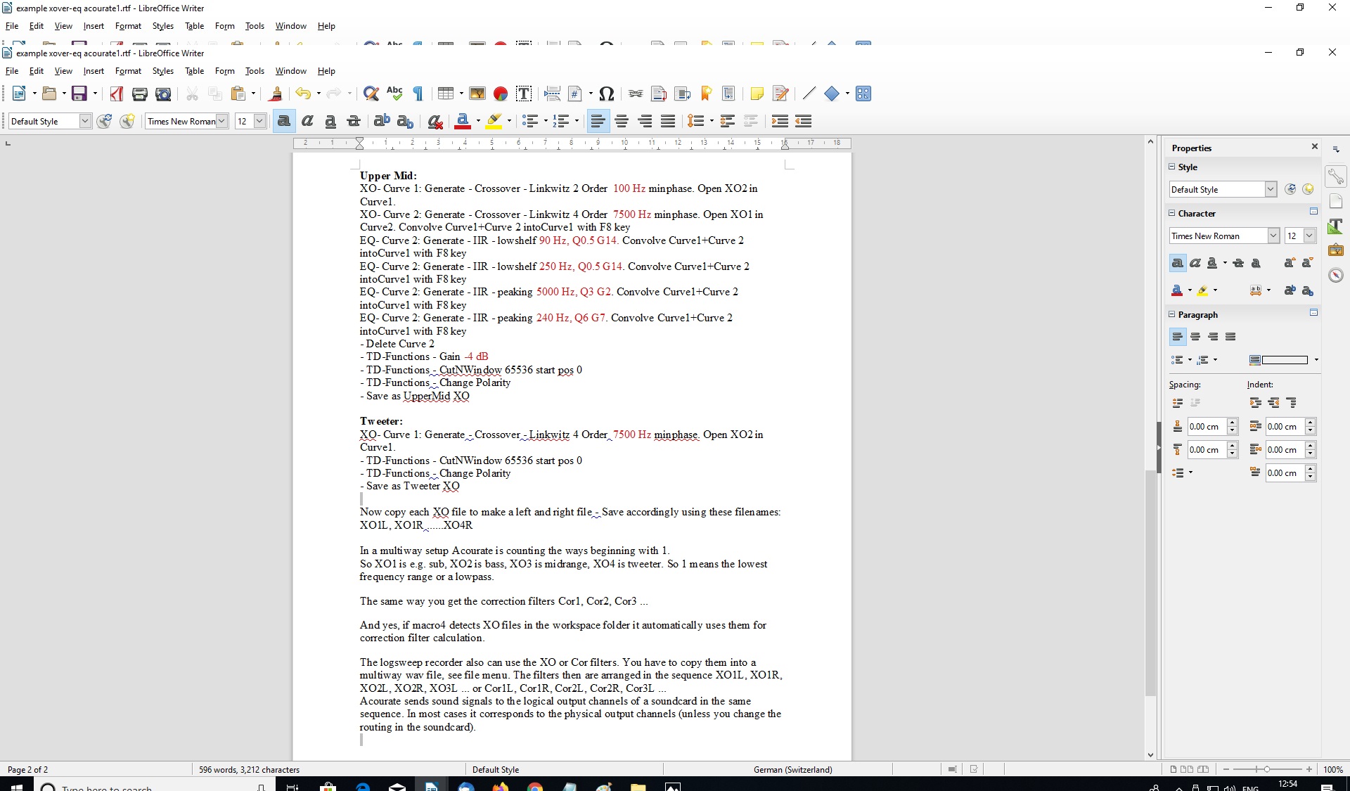

@stretchneck I don't really understand the output from acourate but to me it looks like that it basically configures IIRs only. That you can do with Aurora. For FIRs it would be important to know the filter length (taps).
Gain can only be reduced because 0dB is full scale output for master volume and I wanted to keep it the same on all gain/volume settings.
