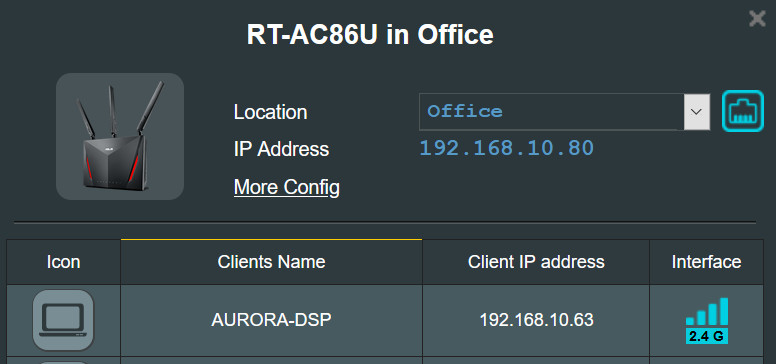

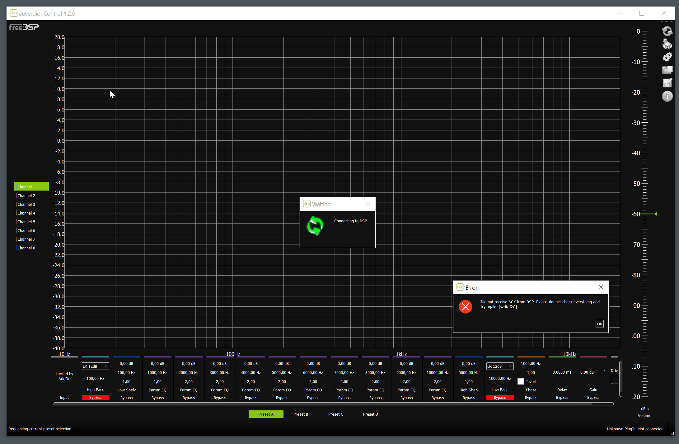

Hello Raphael,
Today, I can't connect to my dsp anymore via wifi local access !
The wifi signal is good and the dsp is connected to my local network (Aurora wifi signal.jpg)
And here is the message I received from AuverdionControl (Aurora error message.jpg)
I'm not a programmer, and not familiar to github either. I'm just a long time user of active digital processors with an acceptable knowledge in electronics...
So stuck again
Jean Claude

Hi everybody,
Here are updated news on my sample:
- First I have upgraded to both firmware and software 1.21. I must say that I have absolutely no problem at all with webota either via access point or local wifi network. It always connect immediately and firmware upgraded almost instantly.
- But beside this, I have tremendous problems to connect reliably with Aurora even via access point mode (192.168.5.1). On 10 attempts, I have 1 success connection and for a short time before it stops working again. The signal strength is perfect on both mode but it's just unreliable at best to get the board connected enough time to do whatsoever.
In short, not any use for the time being. I don't know what to do next
Any idea anyone ?
Best regards from France
Jean Claude

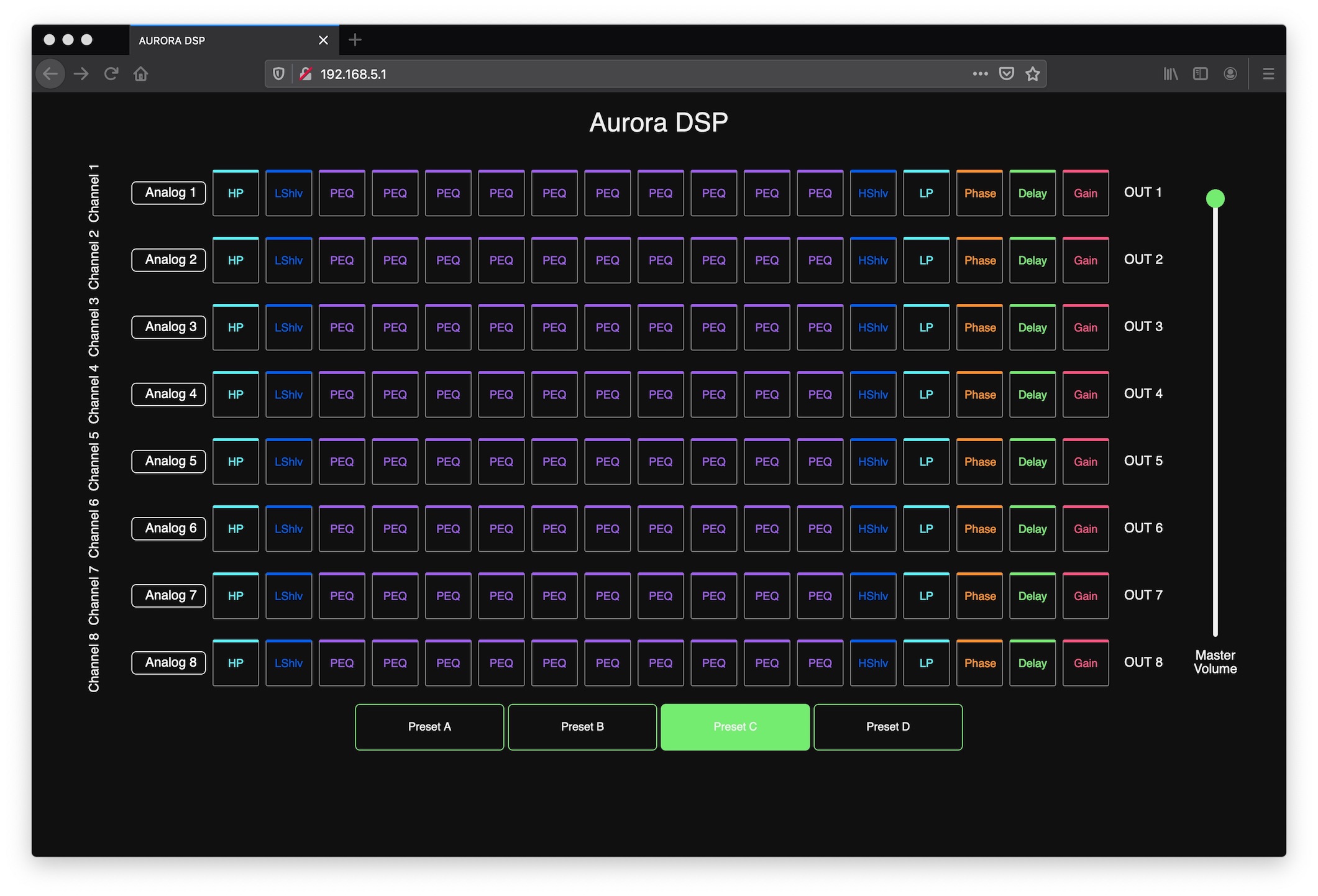

Looks like the dev is going to switch to a browser based interface due to ongoing issues with the software - might be worth holding out until that's released? There's a German language thread here just started:
Yes that is true. The decision was made last week and I have spent the last days with proof of concept.
The last weeks have been terrible. There are some users having trouble with the connection from auverdionControl to aurora. There is no pattern. Sometimes only uploading parameters works sometimes connecting at all fails, sometimes only when switching presets. The only common thing is, they are all using Windows. And to make it even worse: The same board works with one Windows PC and not with the other standing next to the previous one. I saw issues with firewalls and defender. E.g. Kaspersky tends to block the traffic from the board but does allow the traffic from auverdionControl to the board.
After nights of support and trying to solve these issues I decided that I don't want to waste my time with supporting the ugly Windows OS anymore.
Interestingly Mac and the Linux beta have been working fine so far. I did not get any bug or error report from these systems like I have seen on Windows yet.
Therefore, auverdionControl will be replaced by a web app. That means, there will be a web server running on the aurora board. You connect to that board via your browser and do all the config through a web interface. This removes the dependency on Windows and enables all major platforms at once. You only have to make sure, that you browser can access a web server. Well if it cannot you have a serious problem with your PC that you should solve first before playing with DSPs. 😉
Raphael
P.S. Checkout the feature branch web app on GitHub to follow the current development. I have attached a first picture of the new web app.
