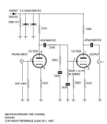

In case anyone feels more comfortable with passive RIAA stages:
Let me know what you think of it.
Ciao, 😉
P.S. The loss of the cathode bypasses reduces the gain, introduces some local degenaritive FB, all in all this circuit should sound faster and more open, I expect bass to be tighter too.
This is my choice for a MC cart combined with the MC Hammer headamp it has a lot going for it, if I may say so.

Hi Frank
Interestingly, i am not a big fan of unbypassed cathode resistors. Don't know if it's the feedback or the resistors but even a high quality cap bypass, with the unavoidable added colourations sounds more open and dynamic to me. If i had to improve this circuit (according to my taste 🙂) i'd replace the first cathode resistor with a nicad and have fixed grid bias on the second stage. Of course this will change the output impedance of the first stage and slight adgustment of the 210k will be in order. Another interesting aspect is whether to implement the RIAA before or after the coupling cap. As shown the circuit has the advantage of using potentially low votage riia caps but they are obviously not biased. I wonder if you have tried both positions for the coupling cap and whether you find a difference.
regards
peter
Whenever possible, I try to avoid bypass caps.
They slow down transient response and, depending on the animal in use, definetely colour the sound. No amount of bypassing electrolytes ever worked to my ears, all that did was disrupting coherency.
In my OTL amps, no bypass caps at all and just one coupling cap per signal polarity...naturally I have the PSU caps in the signal path too if you must but that doesn't seems to have much of an impact on the sound, probably due to the PP and CF topology used.
I'd rather use local NFB by not bypassing the cathode Rs than using global NFB.
All of these measures sound more open, faster and dynamic to me, usually bass is tighter too.
If i had to improve this circuit (according to my taste ) i'd replace the first cathode resistor with a nicad and have fixed grid bias on the second stage. Of course this will change the output impedance of the first stage and slight adgustment of the 210k will be in order.
Sure, you could do that...never tried it though.
What I have tried is tie the cathode of the first triode to ground and bias the grid through a 10M or higher gridleak, worked great when combined with the MC Hammer headamp.
No, I haven't tried it but I follow you on this one.
I should try this, good idea...if anyone wants to try make the voltage rating at least 400VDC for the RIAA caps and I hope you still find some nice copperfoil polystyrenes for it.
All coupling and RIAA caps are precision matched both on value and between channels in the case of my own preamps.
Actually, I do follow that philosophy throughout the entire system, even for the PSU caps, resistors and wire lengths and xformers....up to the x-overs in the speakers...
Friends call me "Le Puriste"...
Cheers and thank you for the contribution,😉

Hi fdegrove
I'm interesting to build the phono stage plus the buffer line stage.
But you post two phono stages.One with passive riaa and the other with the feedback network.
Which from the two is the best?
The one with the passive network hasn't been built by me so I can't tell you what that sounds like.

And if I remember well you said the volume control effects to the riaa filtering.I'm planning to use an other volume control so I'm thinking to build a phono with passive riaa network.Any good schem?What about Bob Danielak's phono stage?What the other experts say?
12 xformers?Ok the filament xformers were small right?
Actually, only six. Four for B+ and heaters for the regulators. Two more for the heaters of the preamp proper.
In the preamp the value of the volume control is the same as g'.
This value can't be changed and needs to be 1M. You can still use a regular potentiometer but it has to be 1M.
The Danielak should be a good preamp too.
