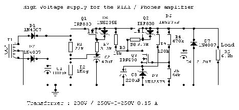

My supply.
Hi Fdegrove,
My supply is a two stage unit and I simulated and got a very low ripple on it. But it does not show up low frequency noise. Sounds like a motor running in the distance.
The circuit is attached. I simulated it with two signal generators for the supply and a 100 ohm transformer coil resistance. This drawing just shows a transformer. The 3k3 resistor in the gate of the MOSFET with the 6.8V zener is to protect the MOSFET gate source. Without these the gates get shot everytime I power up and down.
Can you figure out if the circuit is OK or over done ?
thanks,
Ashok.

Re: My supply.
I think your circuit needs modification or at least very careful tuning around the actual MOSFET used for Q3. The feedback loop created by R4, R5, and Q3 looks to be very marginal and I wonder if it is workable at all at DC. Depending on the threshold voltage of Q3 (have you measured this?) and the zener current of D3, you might have a circuit which requires Q3 to switch on and off to give you the average voltage you want. I suspect that the noise you are hearing is related to this switching behavior. A simpler, non-feedback circuit, as suggested by Peter/Analog_sa is a good suggestion and one that is much easier to build without careful parts matching.
---Gary
Ashok,My supply is a two stage unit and I simulated and got a very low ripple on it. But it does not show up low frequency noise. Sounds like a motor running in the distance.
Can you figure out if the circuit is OK or over done ?[/B]
---Gary

Frank and Gary and Brett -
I used the circuit shown ,as I wanted the S/N ratio at 100Hz to be better than -80db by a wide margin. I hate hum artefacts in a Phono stage. With modern opamp stages with decent supplies being 'dead silent' I had to try and cut down supply generated noise. I was aiming for 100Hz ripple to be below 0.1mV. Note that the final SRPP stage that I used has a ripple rejection of
just about -12db.
That's why a capacitance multiplier in the first stage and a regulator in the second stage. Our mains voltage is not stable at all-even by the minute or second ! So regulated it has to be.
I have built many similar regulated stages over the years in SS.
The bottom resistor ( 64K) in the feedback is small. I used 68K and I will look into it again. But I think it is OK as the output DC is quite stable even with a fluctuating incomming voltage. I must check this on a spectrum analyser. Will post results. The noise issue should be clearly visible there. Will try the gate stopper and filter there. Last time I put a cap across the 68K ( 64k in the diagram) the regulator started to oscillate.
Thanks for your feedback. Will get back soon.

They're only non-linear high-transconductance VHF valves without heaters
It's just a thought, but what are D4 and D5 doing going directly to the gates of the MOSFETs? I always understood that MOSFETs needed gate-stoppers between their gates and anything else, and that you could not pass go before that was done. I'm probably barking up the wrong tree, but you might like to try it.

Diodes.
Hi EC8010,
These diodes prevent the gate source from breaking down due to excessive voltage. Without it the MOSFET's will breakdown every time you power up and down the circuit. I lost 5 MOSFETS before I realised that I had forgotten the diodes.
Ashok.
Note: There should be one across Drain/Source also. But in this case this diode is built into the device.
Hi EC8010,
Ashok.
I wasn't questioning the necessity of the diode's existence, but I was wondering if they should go directly to the gate.
Direct connection.
Hi EC8010,
I read your earlier post again. Yes you seem to be confused about the "direct connection at the gate".
The gate stopper resistor is to tame the hf response of the device to prevent oscillations. In an application where the tendency to oscillate is reduced , you may not find the resistor. You will however find other resistors in the circuit which will do the same job.
In this case the zener is for protection and keeping it on the side of the resistor as shown will also give the zener some protection. A resistor will prevent any high voltage ( with a low source impedance) from blowing the zener itself. The resistor will limit the current and voltage. If the external resistance is sufficient for this you could avoid using it. In my case I also had hf oscillations and so it does a double job.
cheers.
Hi EC8010,
cheers.
I know that the resistor is to damp the Q of parasitic oscillations, and that it has to be as close to the gate as possible. I also accept that the resistor protects the Zener. What I am getting at is that having the Zener directly connected to the gate might just be setting up the external resonant circuit that the resistor was intended to damp.
Ok , here is what I think.
Hi EC8010,
I am now going to step into unchartered waters. I have never worked on the exact simulation on this to figure how exactly it works. But I think the resistor in the gate drops the HF gain of the device in conjunction with the input capacitance of the device.
With another device across the gate source we could be only increasing the capacitance and so it will still roll off earlier with the resistor. The values are not "exact" and so will work over a range of values. We are talking about the RF frequency range I assume.
Does this look any better ?
Cheers.
Hi EC8010,
Cheers.
