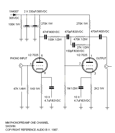

Is there a typo in the drawing of Post #85? Should the series resistor from the first stage to the second actually be 100k rather than 100R?
The MC step-up seems familiar. Did I see an early version in Wireless World donkey's years ago?
TYPO!!!
Oh dear, I do need a pair of glasses...🙁
EC8010 is absolutely correct the 100R resistor in the phono pre goining from the anode of the first triode halve just after the 47nF/400VDC must be 100K not 100R.
It is of utmost importance for the RIAA correction.
I'll update the circuit asap and repost it.
Actually it was inspired by Eisenson of Audio Dimension, a similar cicrcuit was published by Christer Oehrnell in HI-FI news & RECORD Reviev in the June 1983 issue.
Quite likely it was published in other magazines as well.
Thank you for spotting the error.
Cheers,😉

I seem to be a bit confused. Could you please let us know how you calculate the values for the riaa components. It seems to me the output resitance of the first stage should not matter for riaa accuracy in a feedback arrangement but i haven't really given it a good thought. If it does indeed matter than the cathode bypass on the first stage cannot be optional as it changes the output resistance of the stage.

I'd love to implement Allen Wrights' RIAA idea into this phono stage, it's probably simple enough even for my non-mathematical mind but I fail to see how to implement it correctly here.
Frank,
Its actually pretty easy to implement Allen Wrights suggestion of an extra pole (or is that zero?). I don't have his article handy, but I believe his suggestion is to flatten the curve out at 50khz, instead of letting things drop forever.
To do that in your circuit you need to put a resistor in series with the 0.0033uf cap. A value of around 965 would do the trick. I believe the nearest standard value is 976, which should be fine for most folks.
---Gary
First and foremost, it's been ages since I looked at all that RIAA stuff.
Still, the first pole is formed by the 47nF and series R 100K, the next two are frequency dependent networks as you would do in a classic circuit, say a la Dyna or Marantz, the difference is that the signal is fedback from the anode of the second triode.
It does matter and in this incarnation of the circuit the cathode bypass is not optional.

CORRECTED CIRCUIT:

am very uncertain about this. Can you please throw some light?
Truth be told, I am not remembering all the details myself.
Fact is though, this all pretty complex to explain mathematically.
This RIAA correction was done way back then together with a good friend of mine and it took us several months to get it right.
From what I remember, every component matters for the RIAA correction to fall into place, even the 1 Meg attenuator of the linestage...in short, not the kind of circuit you want to change component values with without upsetting it.
Almost everything is interactive.
From that perspective it is best to look at the whole circuit, the phono and line stage as a whole.
Taking all that into account a passive RIAA stage is peanuts compared to this.
We used an inverse RIAA network a la Hagtech to check it for accuracy and it came within +/- 0.2 dB.
I still have the diagram for that one, if you like I can e-mail it to you.
One person I can think of is able to refresh my memory is EC8010 or GaryB and no doubt other wizards.
I've been out of this kind of math for too long to be really helpful to you.
All I can say with certainty is that it works.No doubt in my mind there.
Any particular reason you want to reverse engineer it? Or are you just curious?
Expert comments are welcome,😉

The algebra for a feedback network is unpleasant. The paper to read is:
"On RIAA equalization networks" Stanley P Lipshitz. JAES. 1979. June. Volume 27. Number 7. pp458-481
What makes it even more unpleasant is that the equalisation is applied over an inverting amplifier with limited gain. Lipshitz gives equations for dealing with this problem, but they're not for the faint-hearted.
This is one of the reasons why I favour passive RIAA.

BTW, the 10 x 4.7 uF bypass caps are just my folly, 22uF will do fine if you want accurate RIAA from 20Hz upwards.
I've been playing with this circuit to get rid of the bypass caps and still maintain RIAA accuracy, no success so far...
Doing away with them speeds up transient response no end but at the expense of bass reponse...
No free lunch and way over my head there...
Cheers,😉

I agree with EC8010 - calculating the RIAA curve in a feedback network is a pain and I would never try to do it. I much prefer passive RIAA equalization.
I should also point out that my comments about adding Allen Wrights extra zero at 50khz applied to the RCA phono circuit that Dave included, not Frank's phono preamp. Analyzing this circuit is relatively straightforward.
For those who are really interested in more details on calculating RIAA eq, I scanned an old article from Audio Amateur and posted it on the following website:
http://joelist.free.fr/riaa_tube.pdf
