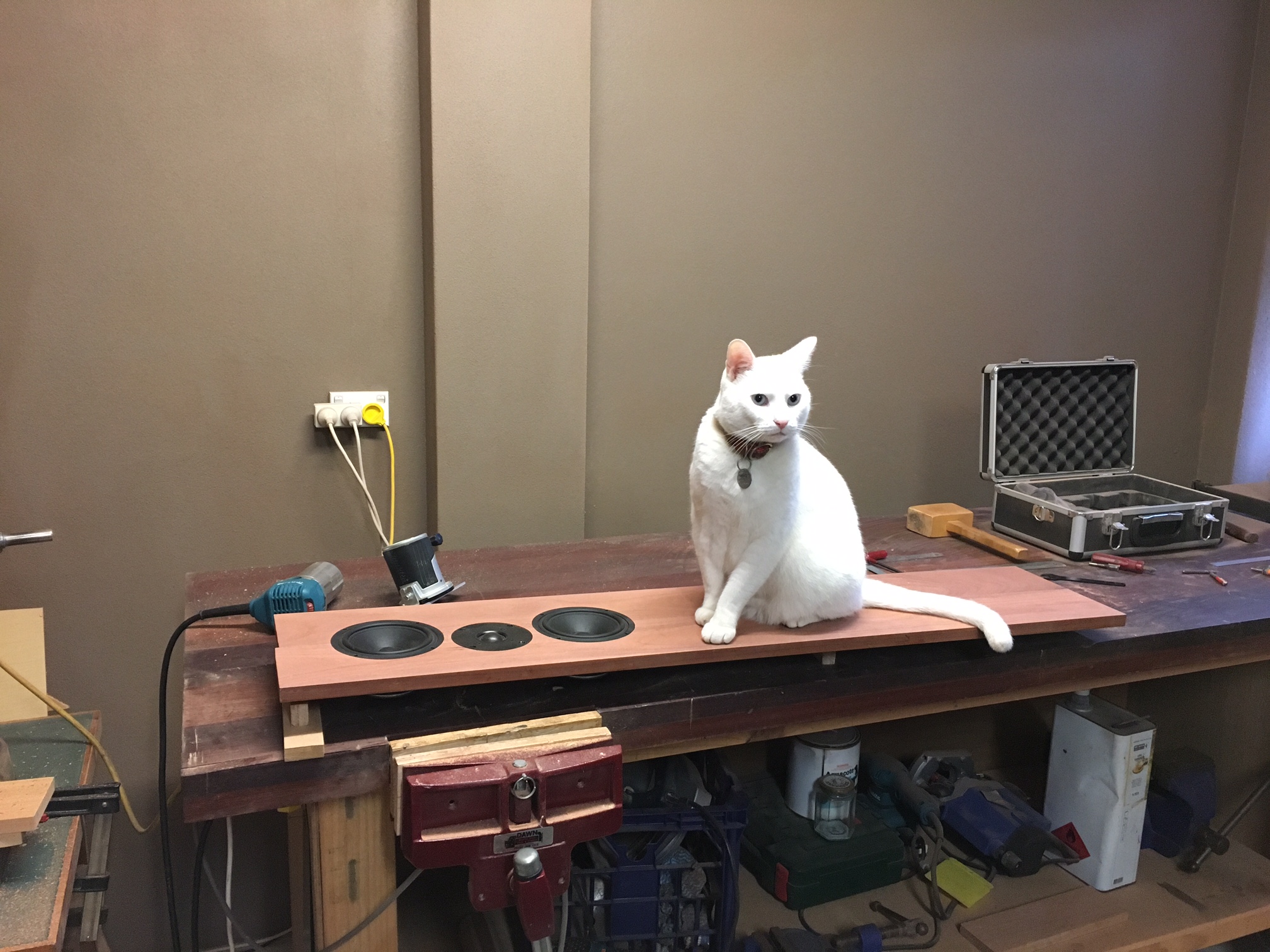

Here's a couple of photos to show how the second speaker is coming along. I haven't yet glued the component pieces together (sides, baffle, rear, interior) as I still need to do some routing so I can attach a top and bottom.
Our cat is always keen to check out whatever I'm doing in the garage.
The second one has come together more easily than the first. I've been keeping the sides clamped together when I'm not working on them to limit cupping. I'm off for work for a couple of weeks so I'll leave it clamped up like this while I'm away - that should ensure nothing goes out of whack.

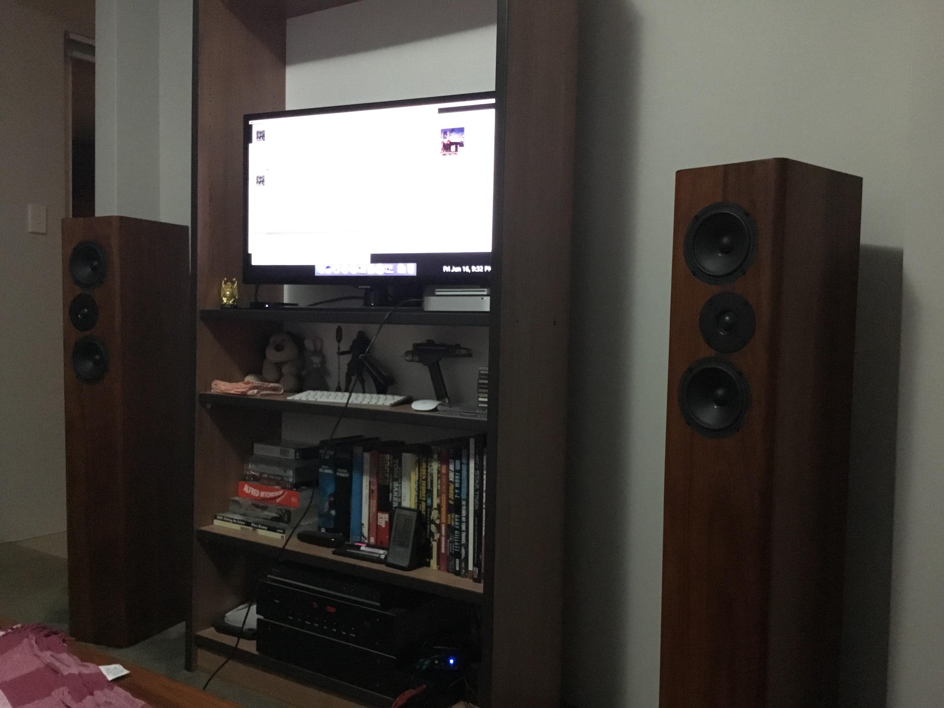

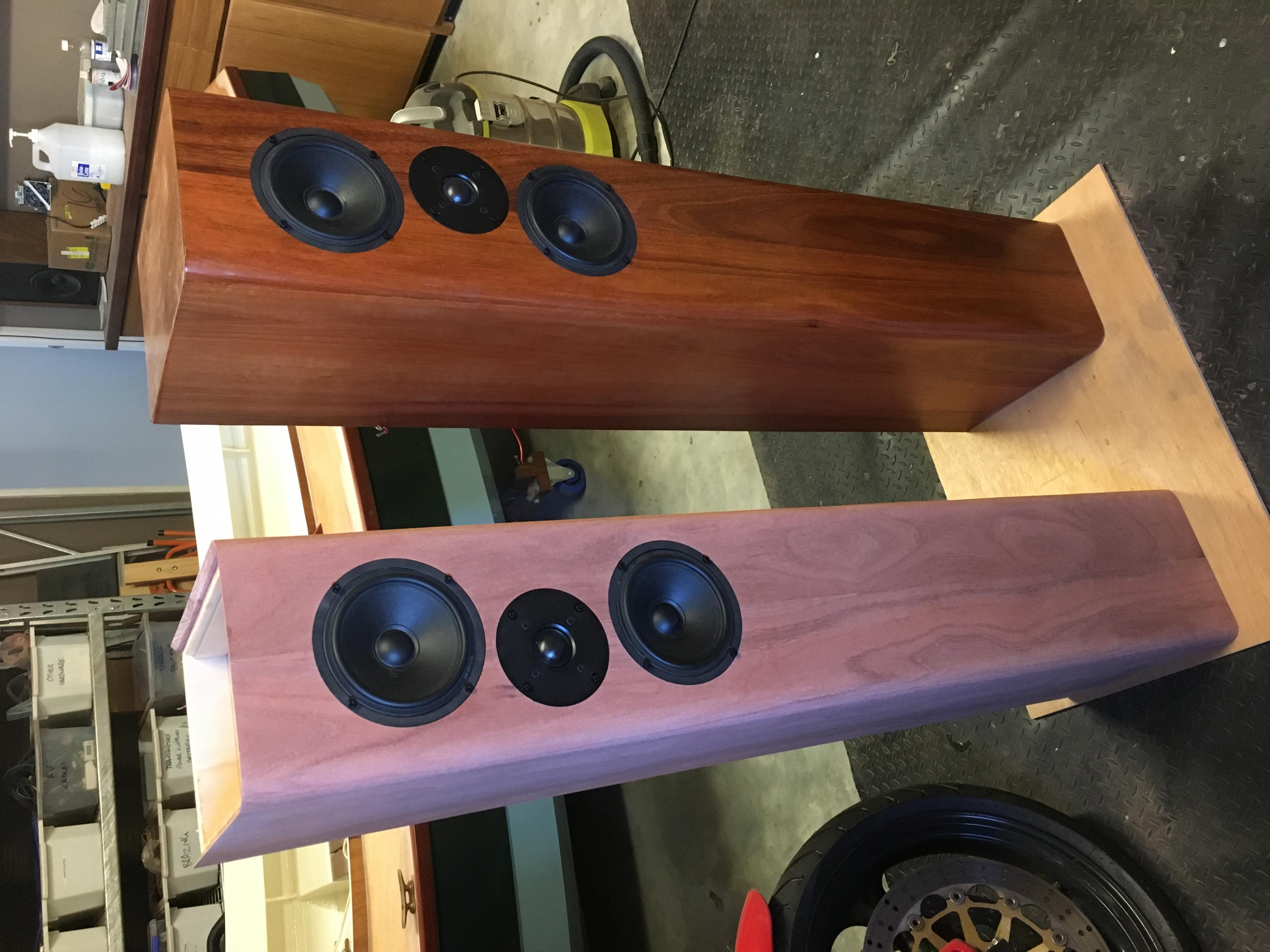

So after a fortnight stuck in Sydney for work, where I got to listen to Grahams very cool Linkwitz open baffle monster speakers (watching the big 10" woofers go in and out was rather mesmerising), I spent the weekend pushing ahead on the second speaker.

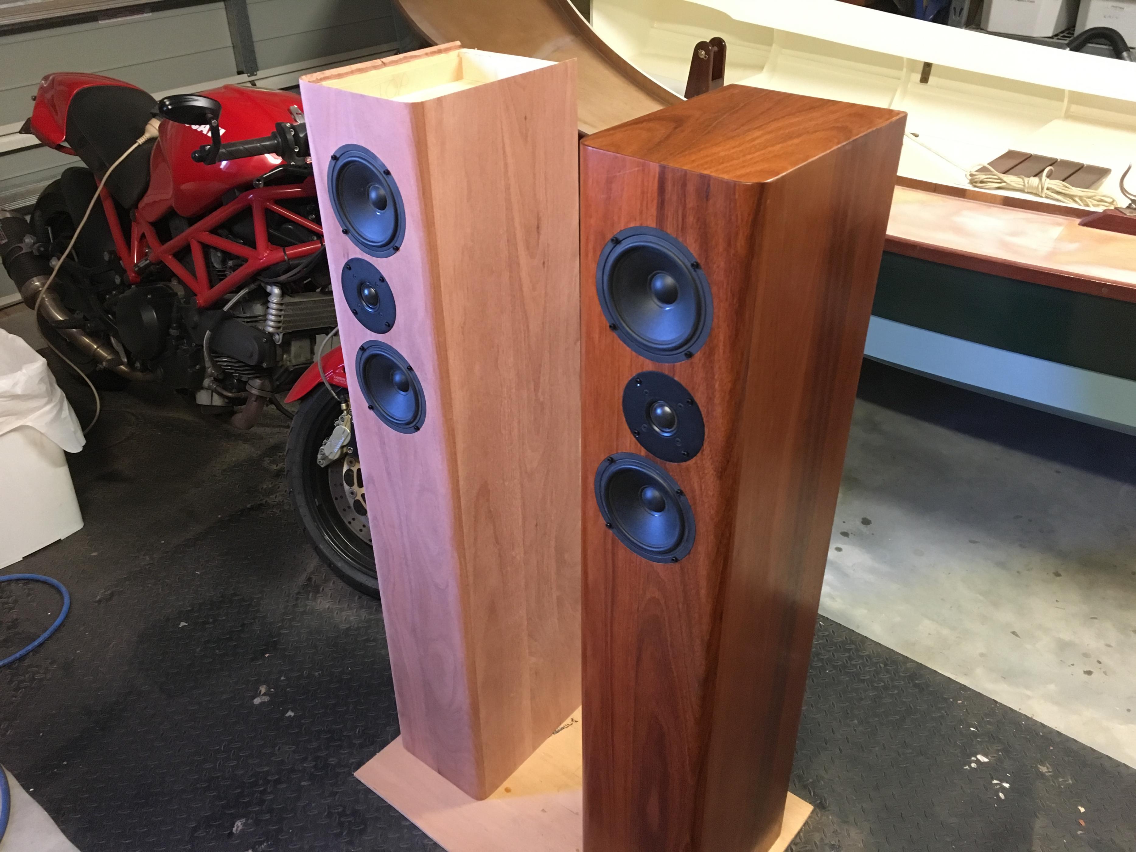

Here 'tis, next to the other one for comparison. I'm approaching completion, at least from a woodworking perspective. Still some way to go with the amps.
You have them reversed, tweeters go on the inside.
What's the rationale? The tweeter placement in my lounge room is deliberate. We're not able to put the speakers as far apart as we'd like, so I'm hoping that the diffraction from the outer edge will help provide a bit more tweeter level into the corners of the room.

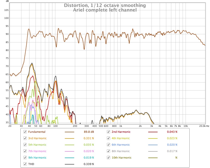

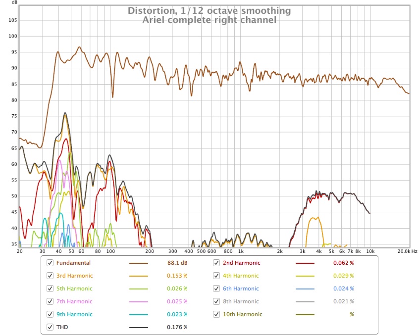

Attached plots from each side, after a simple 18dB/octave 3.5KHz crossover, 120us of tweeter delay, and a little EQ applied at the bottom end for baffle step and to correct some room stuff.
The right side tweeter is down ~5dB wrt the left, and it has rather a lot more distortion. It's definitely the tweeter - when I mute the woofer it's exactly the same. Is this sort of variability from driver to driver typical?
Similarly I note the midrange distortion is higher for the left compared to the right, though this is at a much lower level.

Usually SS drivers are very consistent. Check the Re of the tweeters with a DMM to see if there is a variation (should be about 4R7). Then try swapping over L>R, R>L. Check wiring polarity.
When installing these tweeters, tighten gradually in a X pattern and also check the screws on the faceplate.
That's completely true for the original Ariel speakers. In the opposite direction, a dip at 3 kHz appears quite quickly off-axis. It is caused by baffle edge diffraction and loss of phase alignment as well.
The Ariel, Part II
See section on "Speaker Location and Image Quality", since you have essentially built an Ariel speaker. It's not so much about getting tweeter level into the room, it's about imaging. Tweeter level is based on the series resistor in the crossover.
The Ariel, Part II
Not really. I've built an Ariel enclosure. The crossover is DSP. There is no series resistor on the tweeter. There's a 20uf cap in series, but that's simply there for protection if I stuff up the DSP settings. Also I'm driving the speakers with mosfet amps rather than valves.

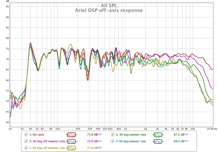

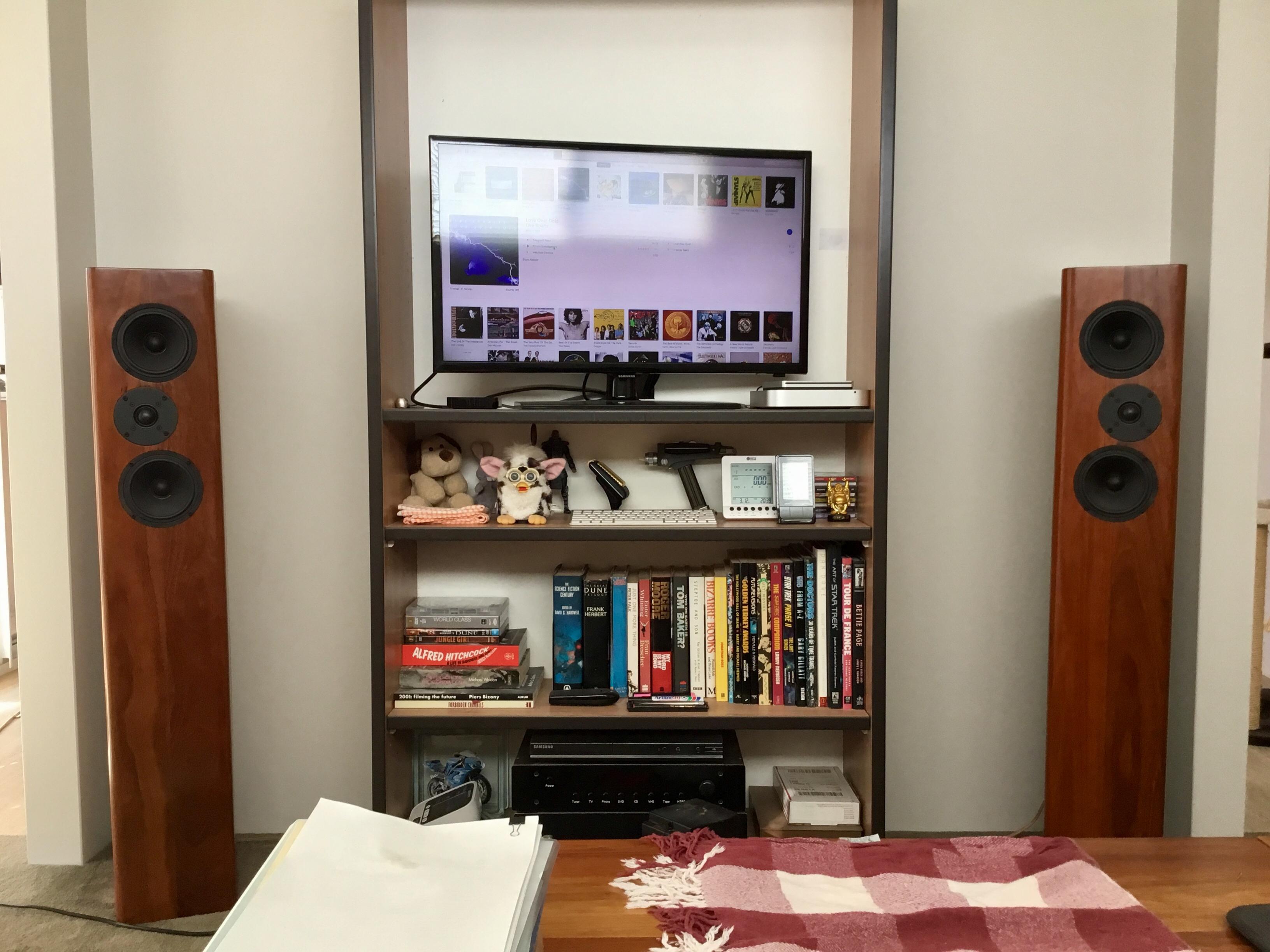

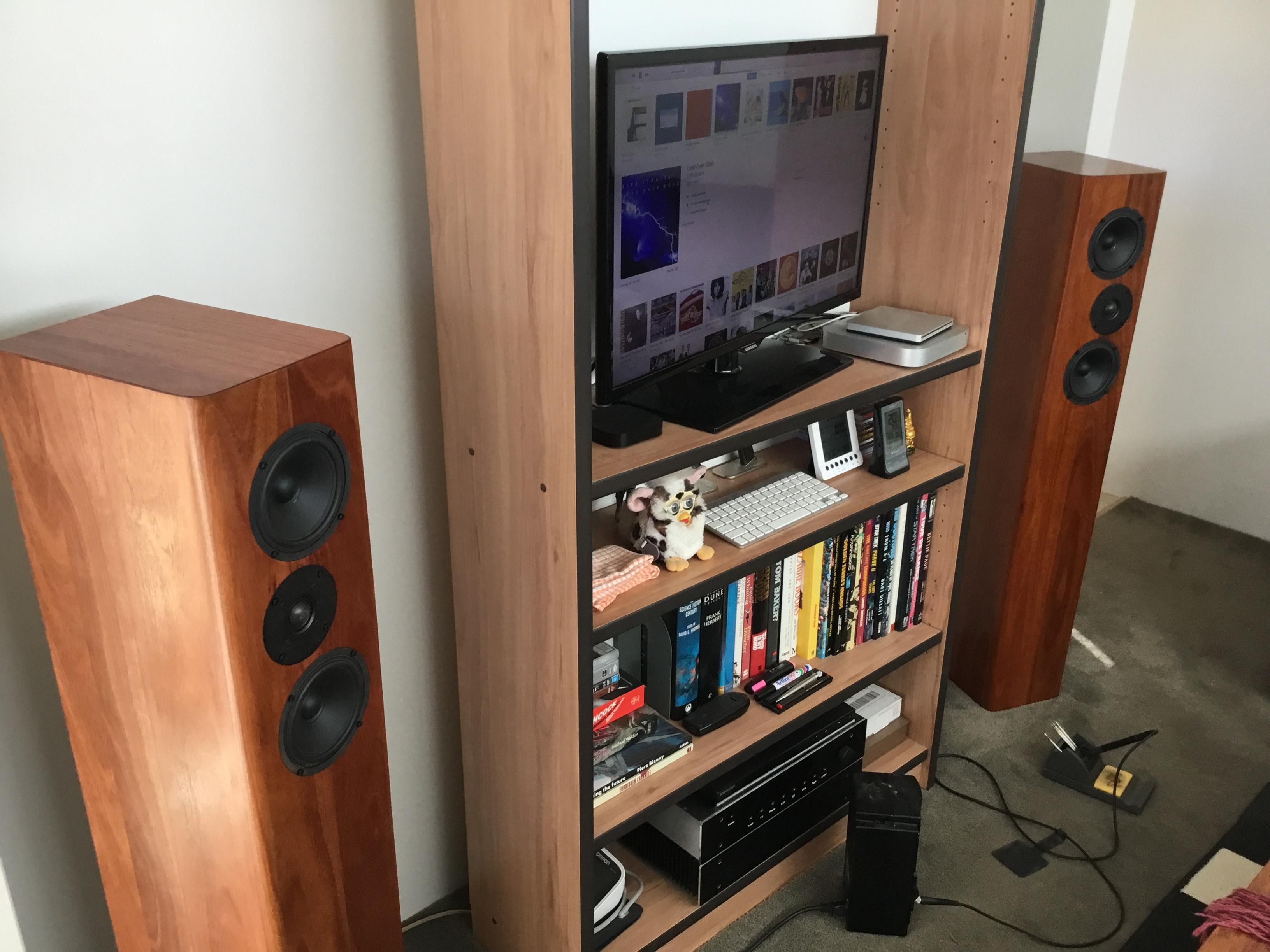

So here's what happens off-axis.
For a listener in the corner of the room, they're most off-axis to the far-side speaker. So having that speaker provide less roll-off is good. This is the case with the off-tweeter side plots. 30 degrees on the off-tweeter side for the most distant speaker (corresponding pretty closely to where my sofa is in the lounge - see photo - The cat gets the prime spot in the middle) is almost as good as on-axis, thanks to diffraction.
So, tweeters on the outside.

I measure 4.8, so that's pretty good.
On a whim, I spun it around 90 degrees when I reinstalled, and that knocked about 5dB off the distortion. Reducing the test level 5dB took about 20dB off the distortion level. I'm wondering if perhaps the voice coil isn't quite aligned and is rubbing at (relatively) large excursions.
I'm going to sound like Steve here(not a bad thing), but you might try swapping out the ferrofluid. It's easy enough, I gather the tweeters are not recent production, you live in a place where it gets hot, and ferrofluid does not dry up perfectly evenly(thus the help from rotation). Uneven(and too high) viscosity will cause uneven motion which will be worse as levels rise.
If you've the patience, you can test the (assembly)alignment by leaving out the fluid and assembling and testing several times, note the variations.
