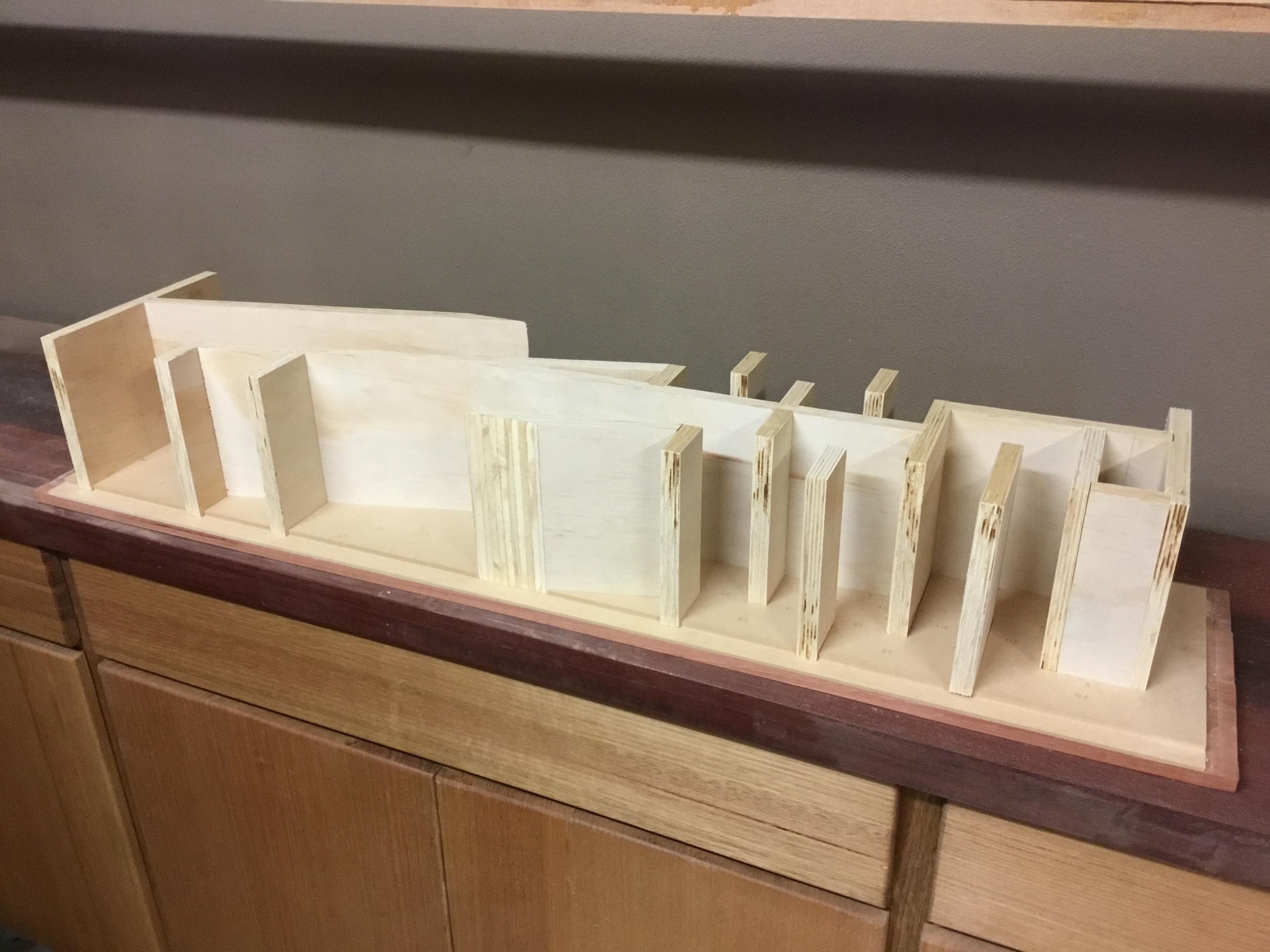

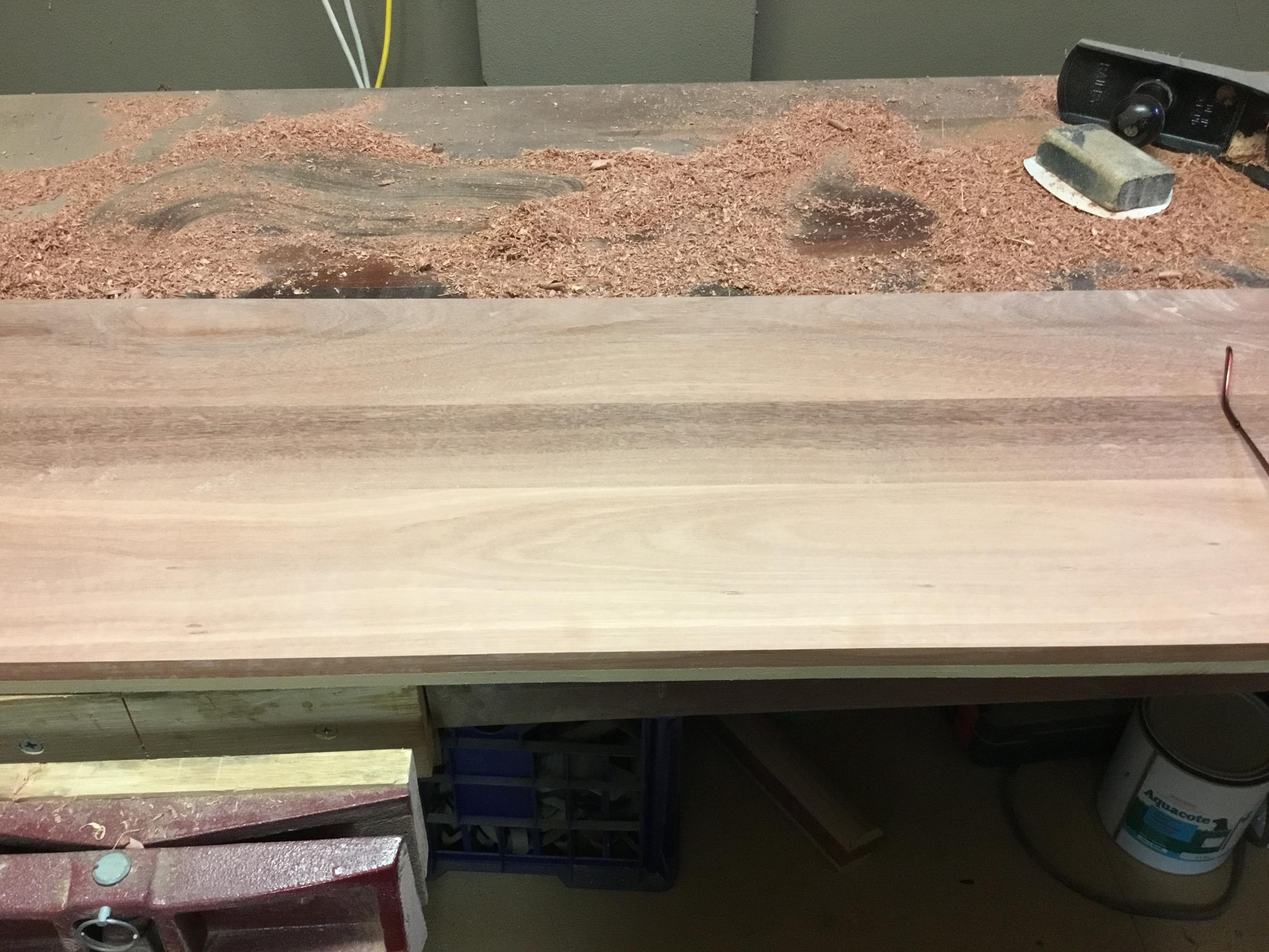

Assembly of the cabinets is progressing nicely. I've got the side panels laminated up from Jarrah and MDF, and have started cutting the interior bits up.
I've got a design roughed out for a simple active crossover (7 opamps), that I'll use eventually. In the short term I'll use a minidsp to prototype.

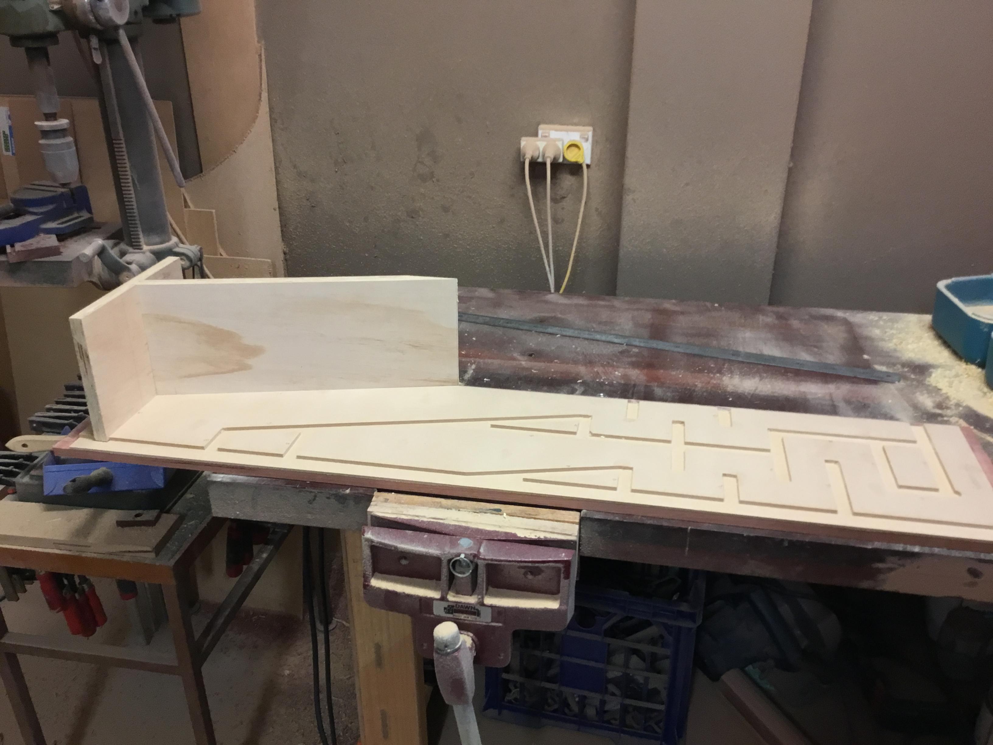

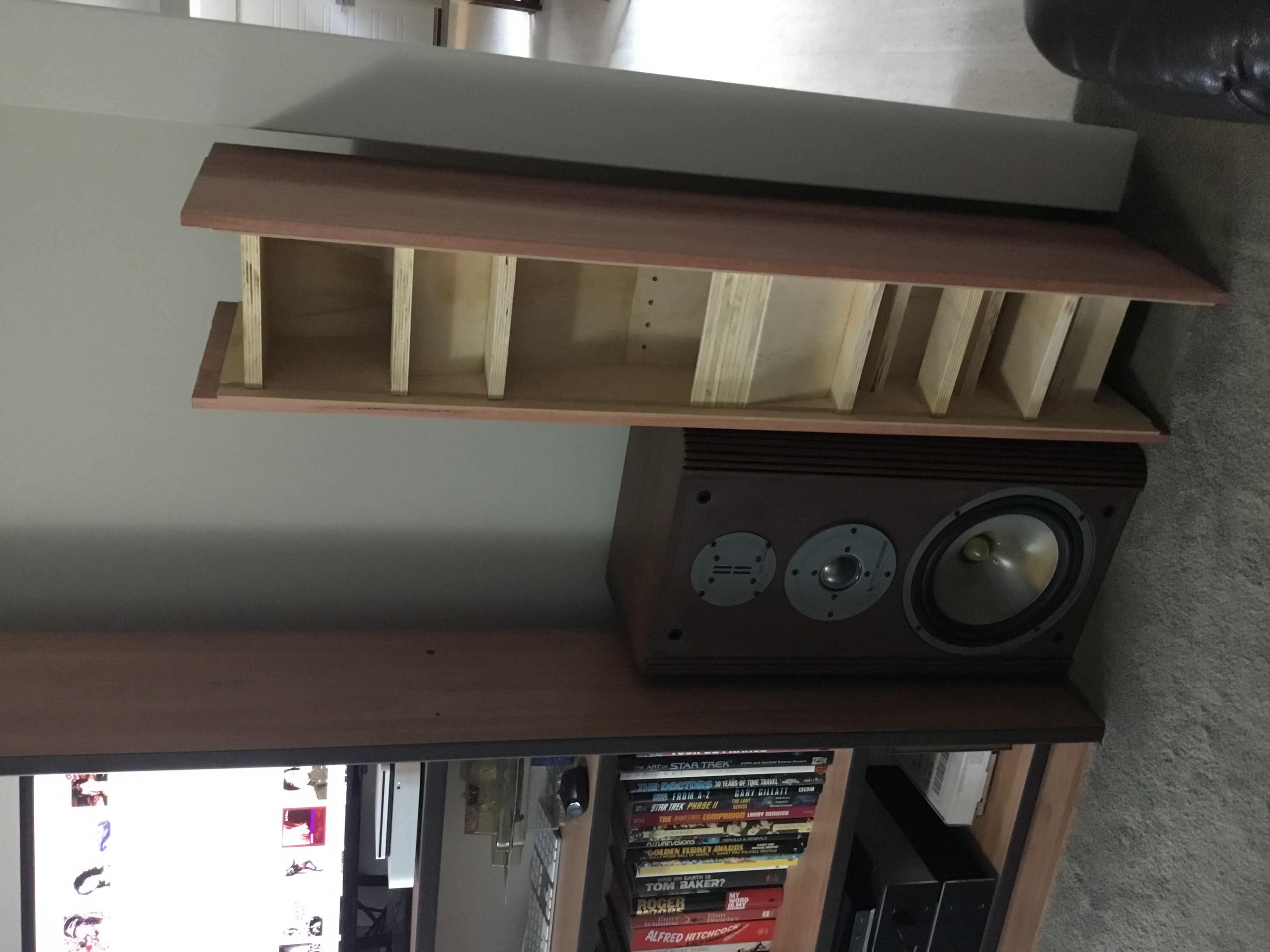

I spent the weekend cutting up bits of ply, and have done the guts for one speaker. It gets to be something of a challenge to line all the bits up and get the sides on - that'll teach me for aiming for an interference fit.

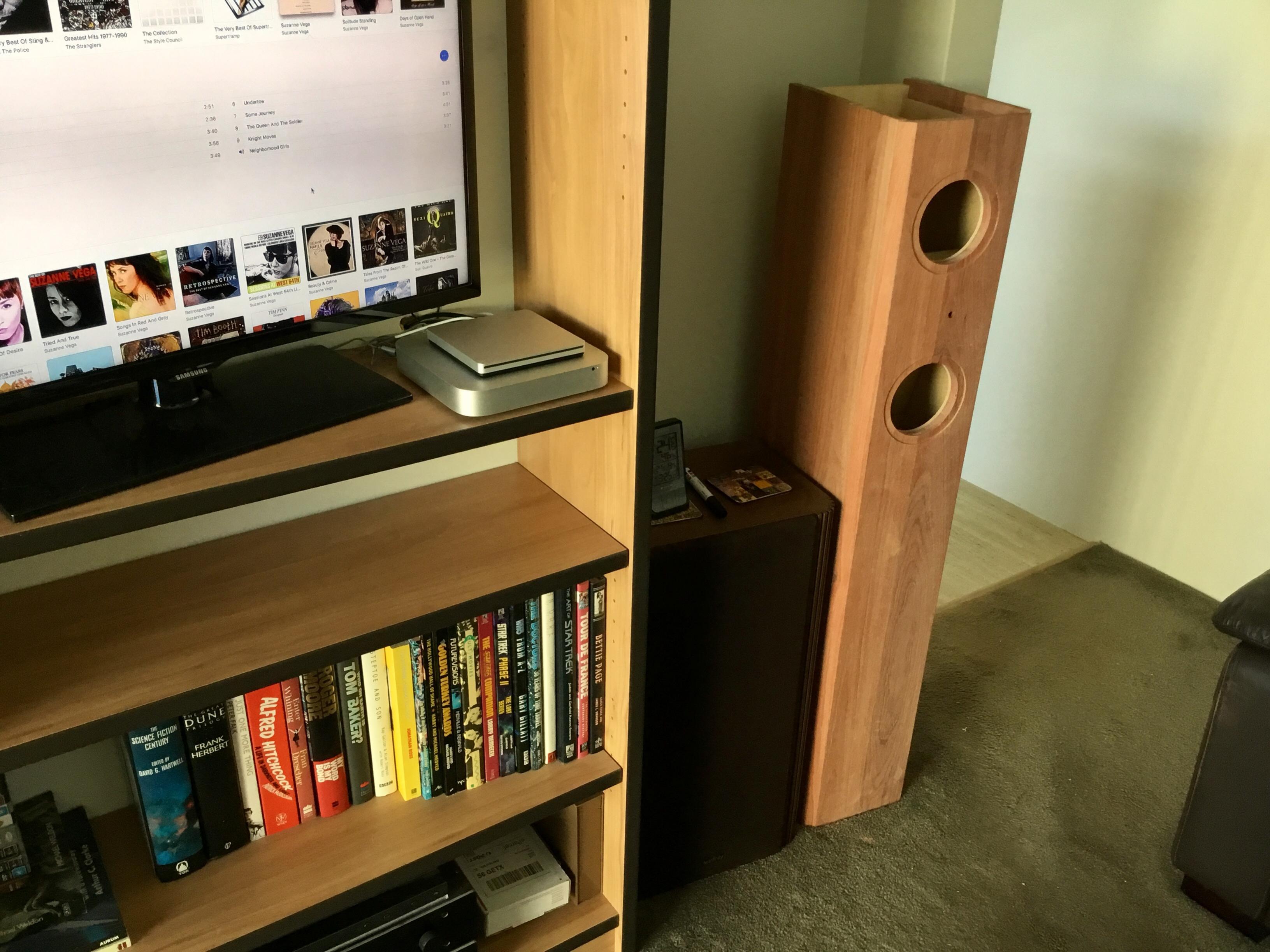

Anyway, an in-situ photo showing an in completed speaker next to one of my present infinity RS-5b. They're really rather tall! Even without the front and back, it's already heavy enough that I have to ask for Perry's help to move one.
I think the Jarrah will look quite the part.

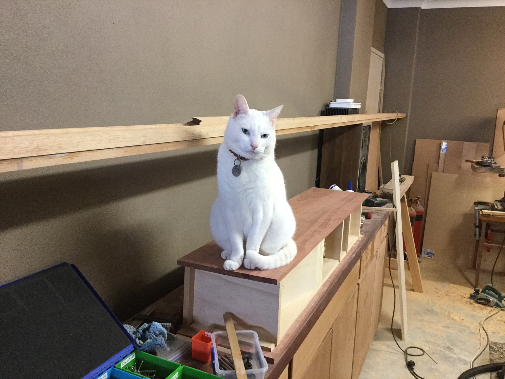

I've got one cabinet to the point that it has a baffle. I'll have to make a new circle guide before I cut the hole for the tweeter. I didn't offset the woofers, as the suggested offset was small enough (1/8") that I reckon it'd just look like poor workmanship rather than deliberate, so the woofers are bang in the middle.
I've put a quick bevel on the sides - a few more goes with the plane will have that become a radius.
I have to admit I've got concerns as to whether the little P13WH drivers will be up to the job. I keep looking at other slightly larger mid-woofers (for example the SB acoustic SB17MFC35 - https://www.wagneronline.com.au/attachments/Audio-Speakers-PA/sbacoustics/SB17MFC35-8.pdf - which is 170mm across vs 140, but which I reckon I could squeeze in).
At this stage one side and the baffle are just pressed in place, so I can do the stuffing. I could conceivably build multiple baffles with different drivers and try them out.
