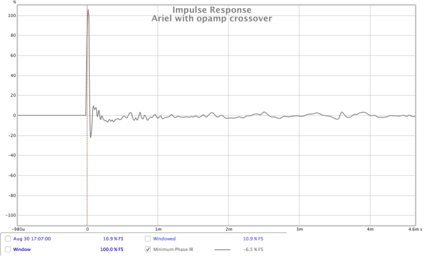

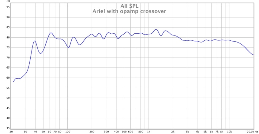

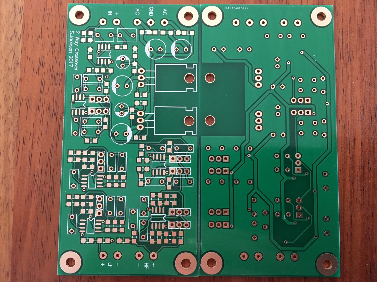

I've built a prototype active crossover, and put that in on one speaker. Sounds fairly good - tweeter delay will need a little tweaking and tweeter level is a tad high, but showing promise.
So I had the brilliant idea of running one channel through DSP and the other through the opamp crossover. Despite setting the levels carefully it was absolutely awful. Sounded like garbage. I think the DSP introduces heaps of delay. The DSP speaker was like it was coming from the next room.
Currently running the opamp crossover via the DSP with everything bypassed, and it sounds pretty good. Still got the low level DSP mumbles, but otherwise quite reasonable.

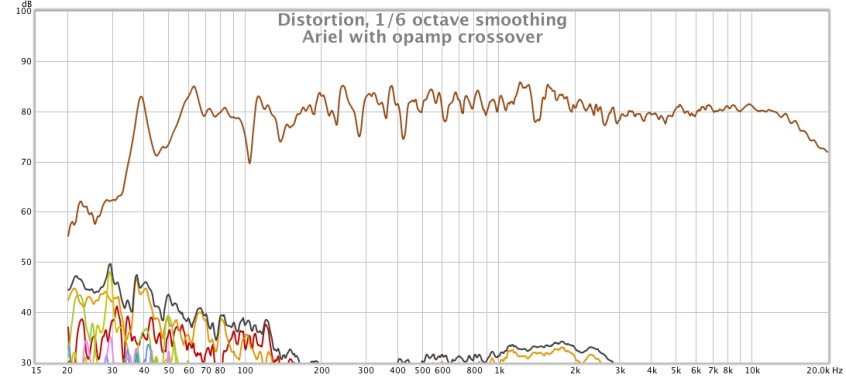

A couple of quick plots from the opamp crossover so far. Tweeter gain is close but not quite. Impulse response is good.
I'm getting weird 360 degree jumps in phase from REW, despite choosing "generate minimum phase". I really don't understand this program enough to be confident my phase plots are valid.
Before I get the relative gains dialled in I really need to sort the gains of my amps. I'm using two generations of amps - newer ones with 24dB (x16) gain for the tweeters and one I built about 12 years ago with (I think) 29dB (x28) gain.
