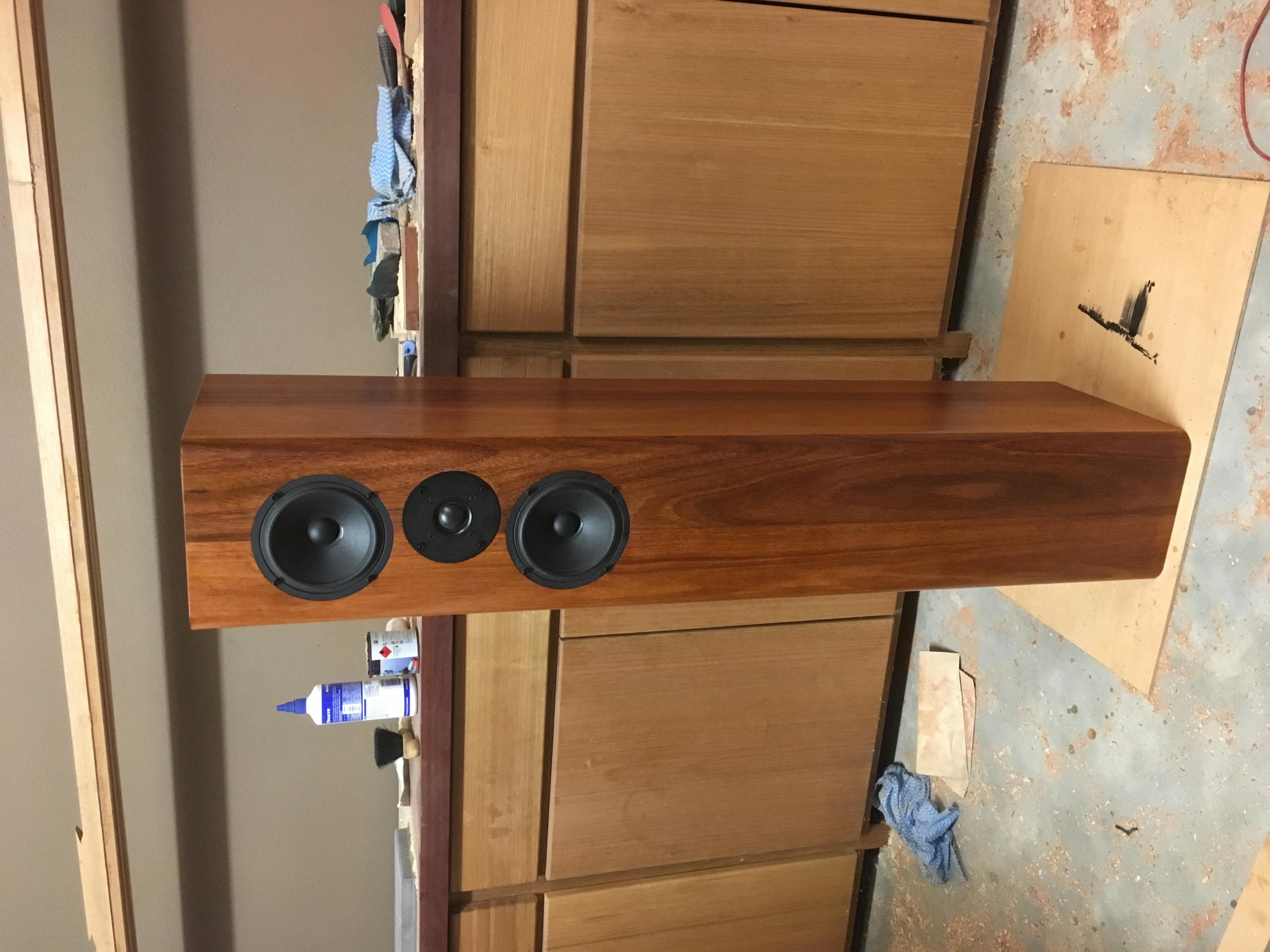

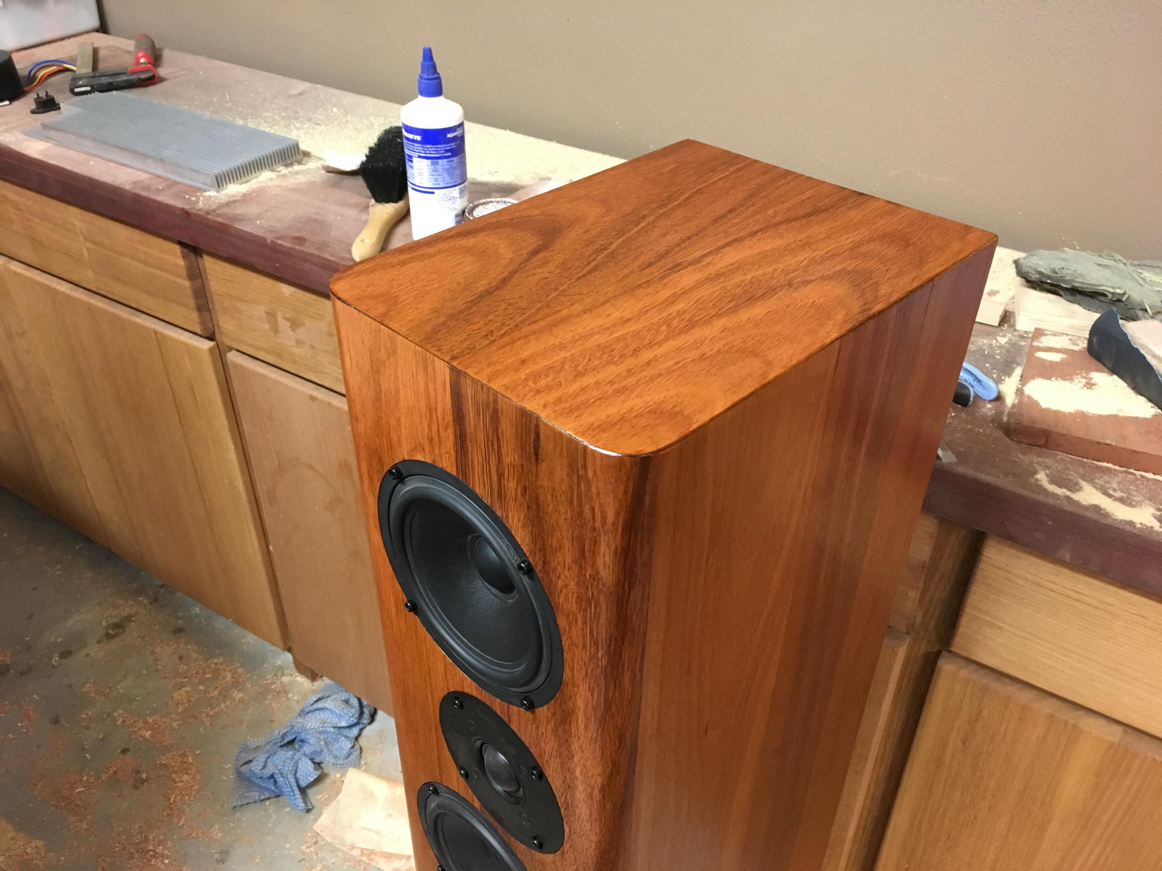

Of course the speakers are built in complete ignorance of any of this. I simply biscuit jointed planks with PVA and then laminated them to MDF with lots more PVA.
I guess one advantage of this construction is that any cracks that form in the Jarrah are unlikely to be audible, as there is still a layer of MDF to seal the speaker up. Perhaps the MDF will hold everything together strongly enough, like some coarse plywood and prevent cracking?
My benchtops are made from Jarrah planks joined in the same fashion, with biscuits. They have cross pieces underneath (more Jarrah) every perhaps 200mm, and are held together with nails and glue. Thus far I've not noticed anything untoward happening with my bench, but that may be more luck than good design.
One thing that I have noticed with my laminated speaker sides is that the sides that were built up but not glued into speakers bowed. I guess that the MDF is a lot drier than the Jarrah, so once everything was glued up the MDF sucked moisture from the Jarrah, causing perhaps 2mm of bowing over the 280mm width.
I mostly sorted that when gluing the second side onto my first speaker by using a truly enormous collection of clamps to pull the panel flat. Even then the gap between the side and baffle was more than I'd like. The other two sides have been sitting clamped to one another with the Jarrah on the outside and a couple of straight planks crosswise to hold everything true while I cut out the rest of the bits.

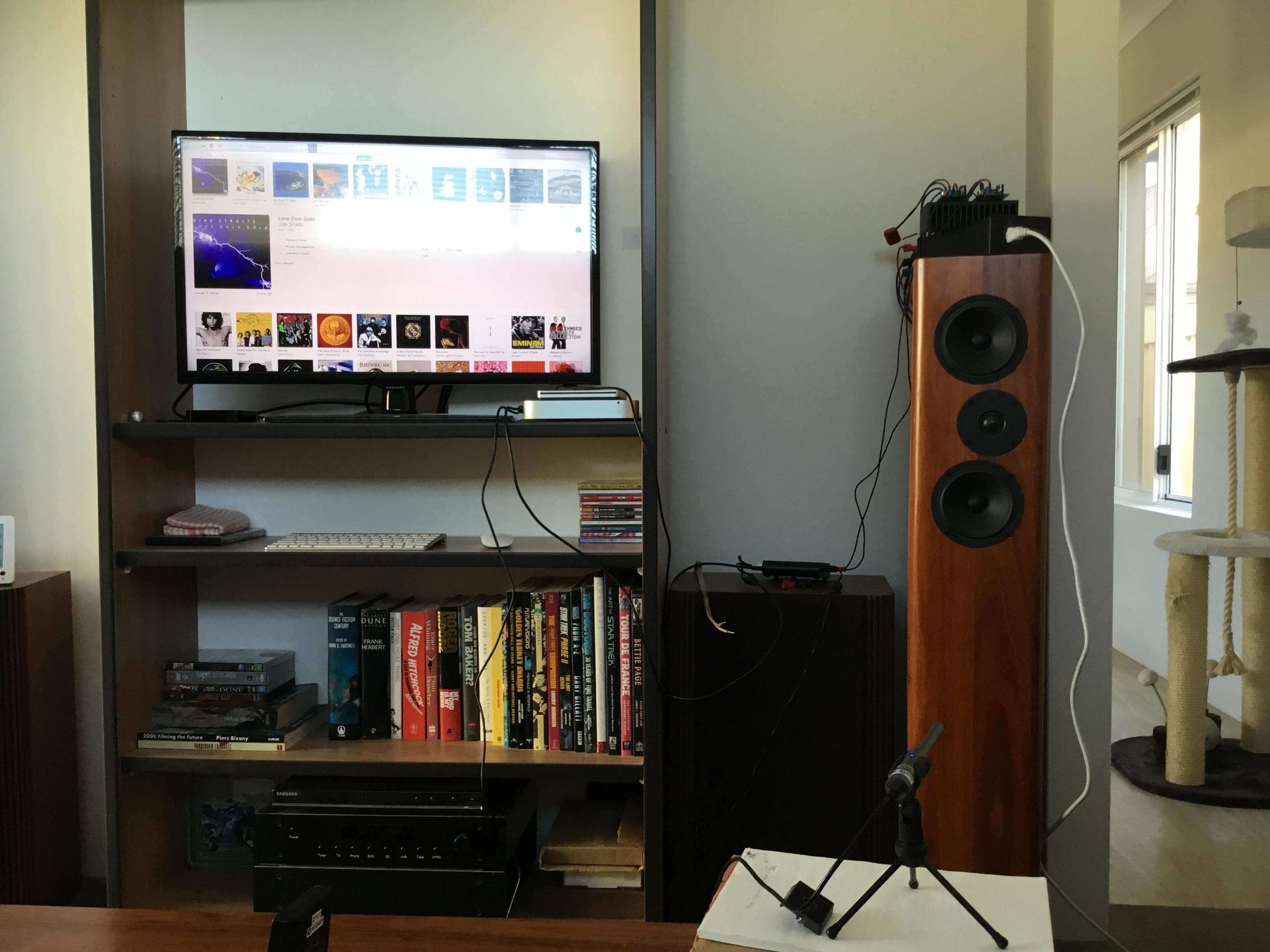

A miniDSP arrived in the mail today, along with a measurement microphone.
This thing is sooooo cool!
A quick 18dB butterworth crossover at 3K, with 2dB extra gain for the tweeter, and it's Good enough for some proper listening...
Sounds pretty good to my cloth ears. My lounge room looks like a bomb hit it.

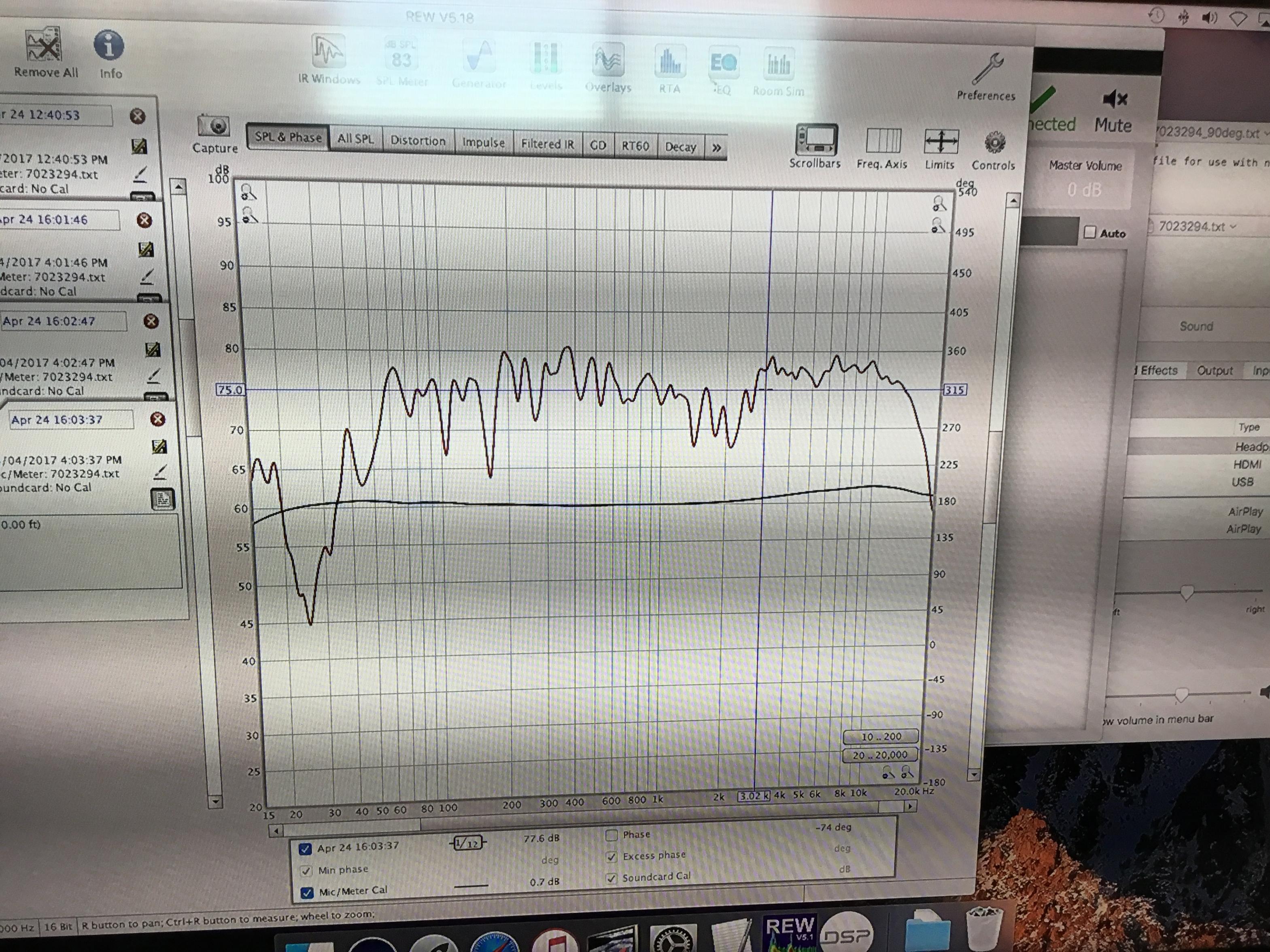

Adding some tweeter delay helps immeasurably.

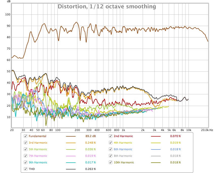

With 10us delay, 3.5KHz 18dB Butterworth filters, +2dB relative gain for the tweeter, and +6dB BSC (250Hz, Q=0.7) applied to the mid-woofers, I get the following plot. I've included a second plot to show the null from reversing phase on the tweeter.

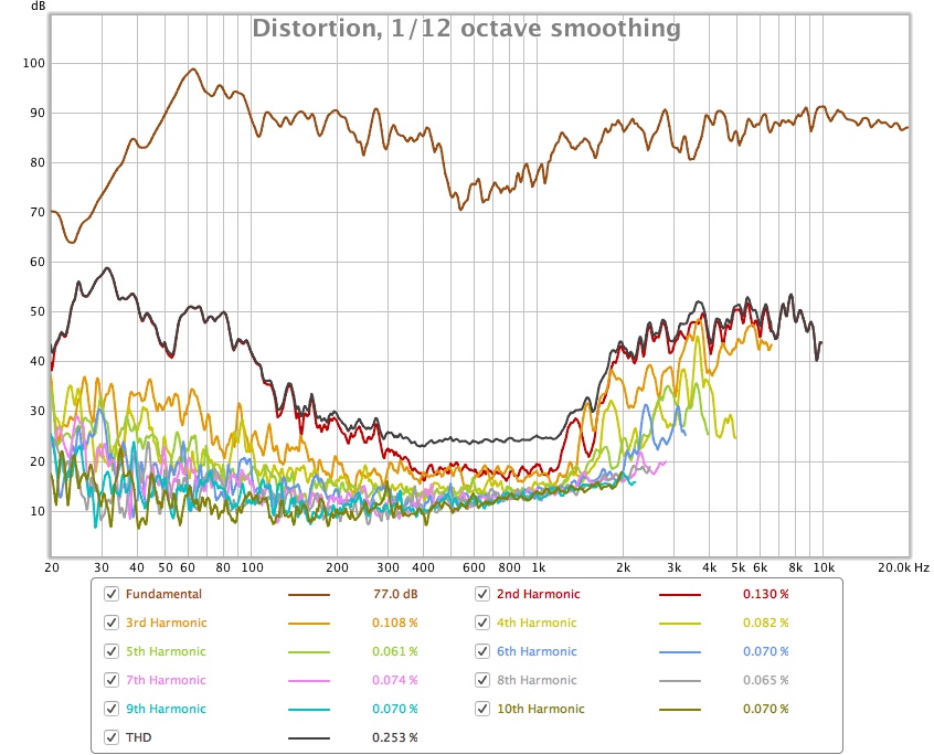

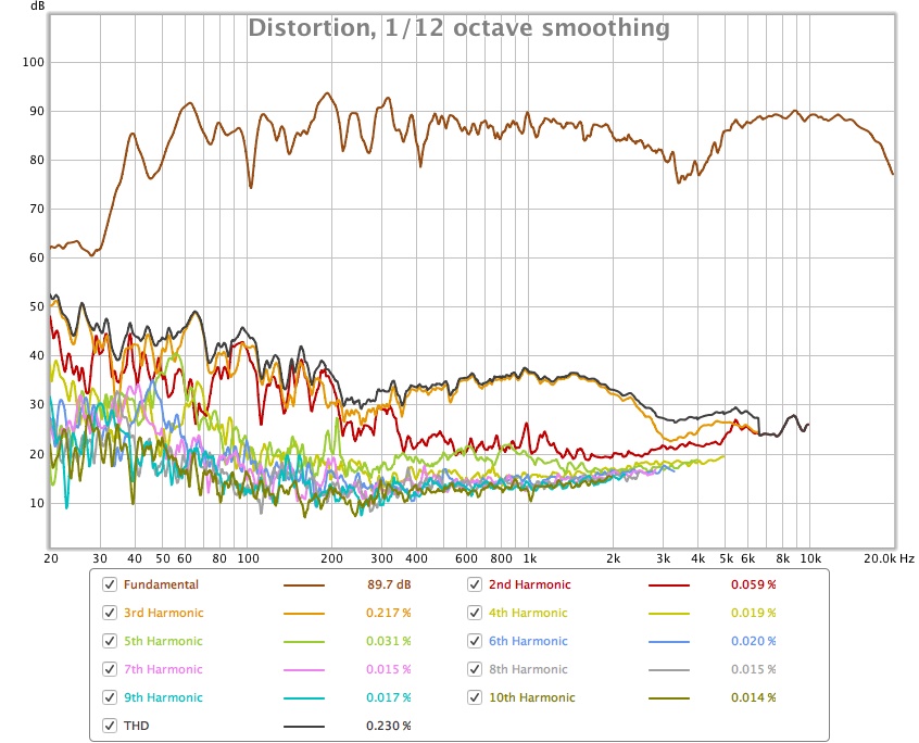

As a reference, here's my Infinity RS-5B. There's a huge hole at the crossover point between the big 10" woofer and the dome mid. The ribbon tweeter goes on forever, but it doesn't have much dynamic range.
There's very little difference in the bass depth between the sealed 10" poly infinity and the little 5.5" tl Ariels, except the Ariels are miles flatter.
I was in-line with the tweeter for each measurement, with about 1m distance.
With the Infinity, that's only going to exacerbate any time alignment issues between the dome mid and cone bass driver.
Would be interesting to observe a measurement of the Infinity with the mic between woofer and midrange.
What gating were you using Suzy? I'm wondering exactly what conclusions you can draw from the low frequency end of those curves.
Nice cabinet!
Graham.
Nice cabinet!
Graham.
