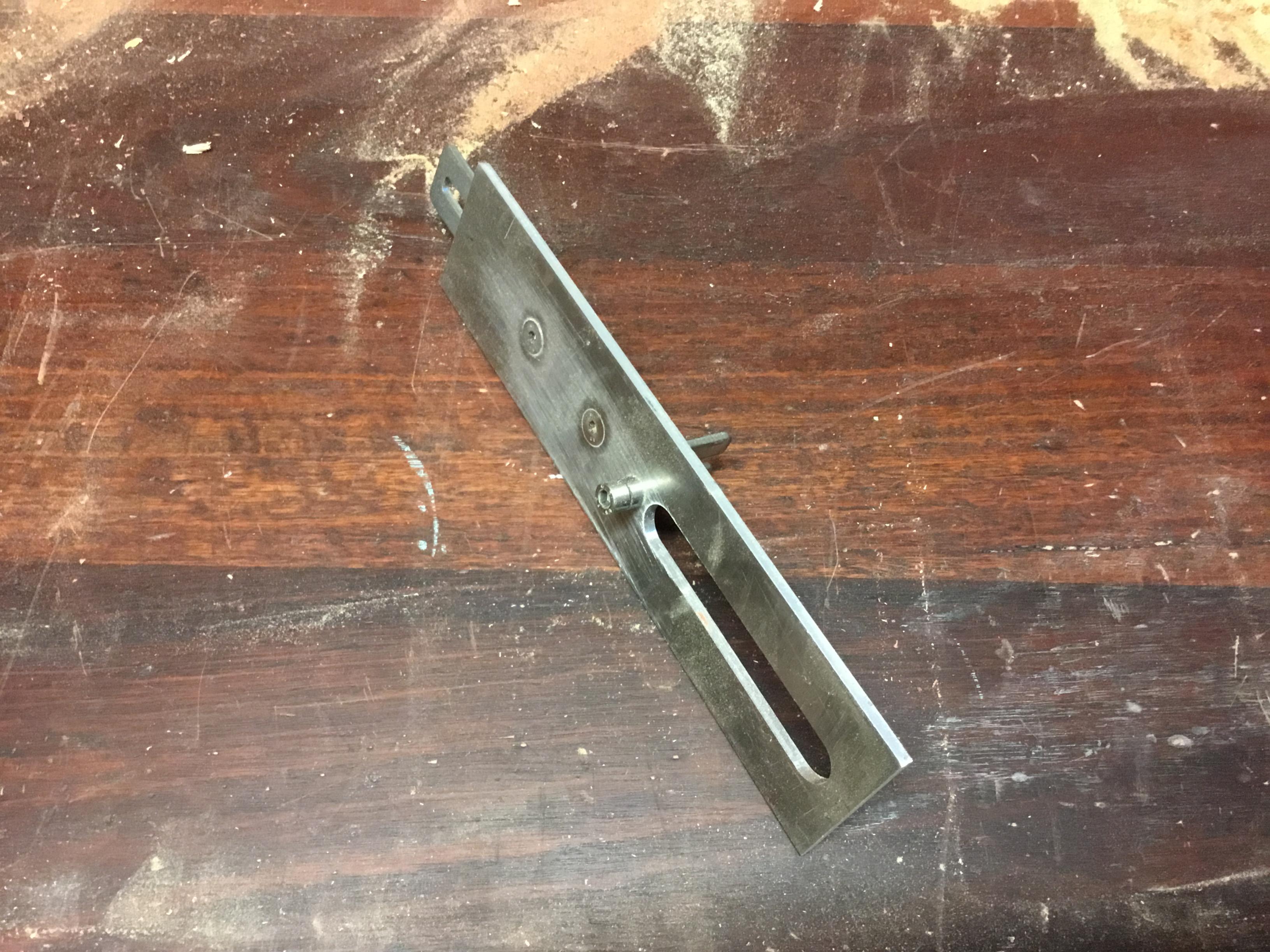

I made a circle jig similar to this from 3 mm aluminium plate and probably more durable than that. Works really well when I get off my bum and use it.
It looks like an IED.

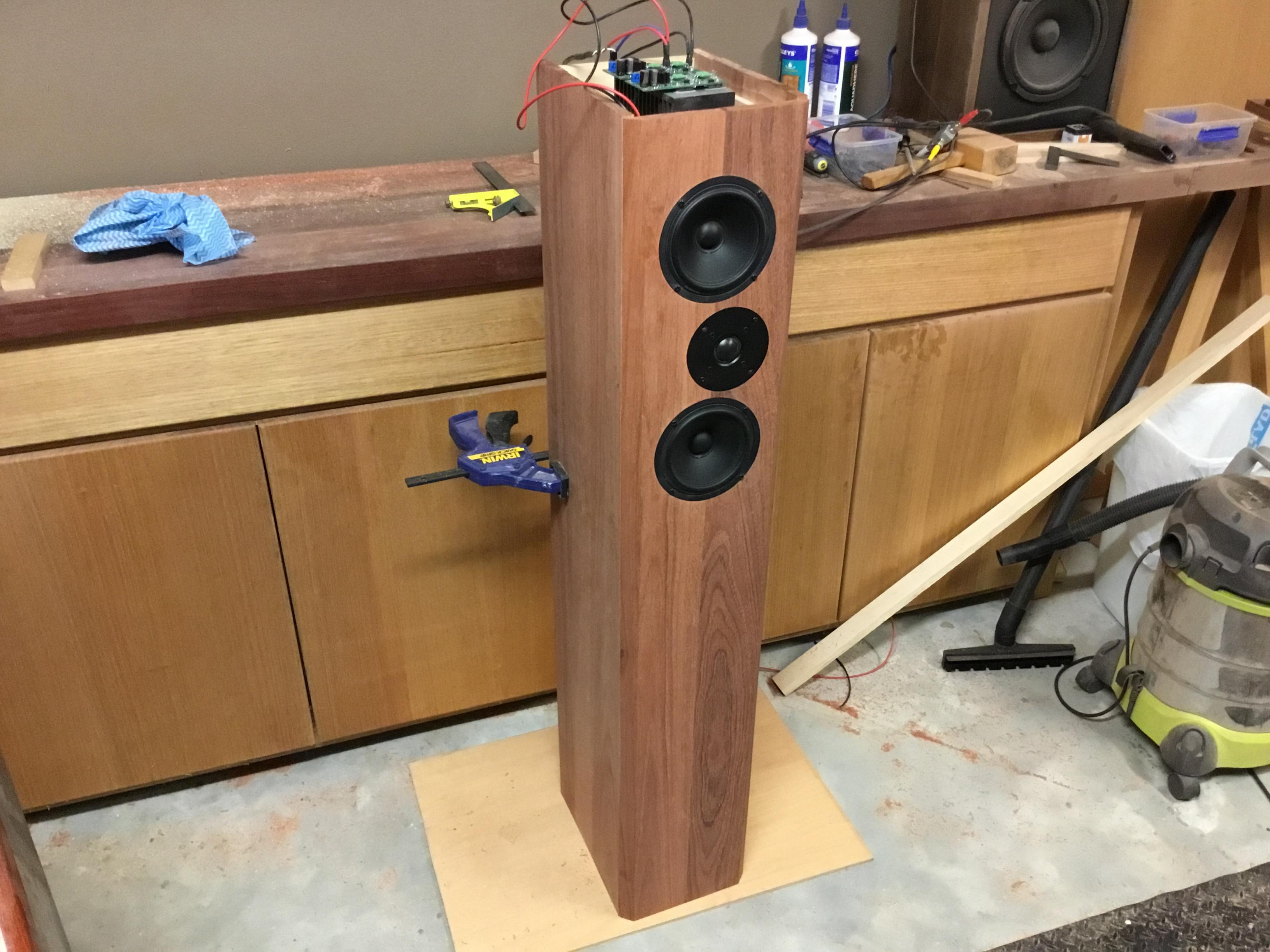

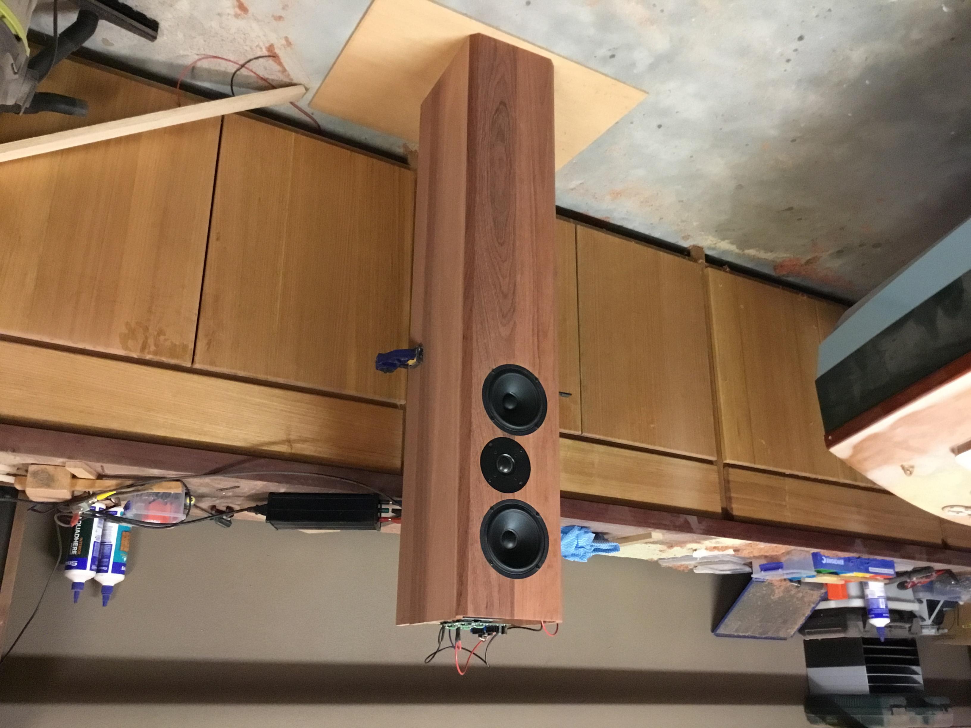

So I've got one cab to the point where I can make a noise with it. No crossover yet - I'm using the P13WH woofers as full-range drivers. I've loosely filled the lines with 150gsm polyester cushion stuffing down to the point where the labyrinth starts. No felt yet as it still hasn't arrived. I've left one side unglued so I can play with stuffing, but the baffle is glued in.
Anyway, it sounds awfully bloody good. I'm really surprised at the depth of bass from these titchy drivers. My garage is a terrible listening room, as it's quite big (6x6) and full of (dusty) junk, but this little speaker is really filling the room.

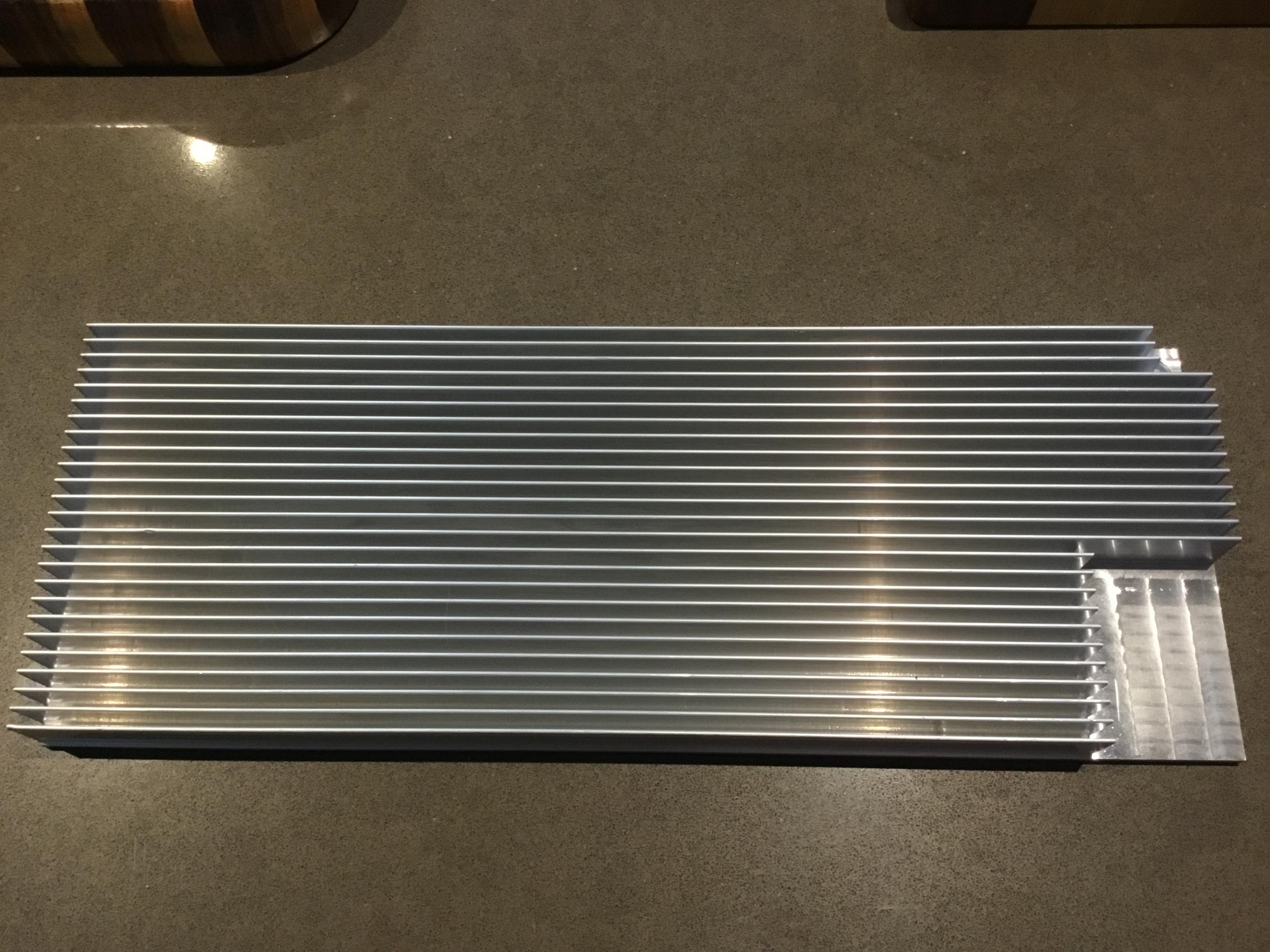

Amplifier heatsinks
A couple of photos showing progress on the heatsinks for the amps.
All the active circuitry gets mounted to the back of these heatsinks. Power transformer, a pair of latFET monoblocks, and active crossover. Then the circuitry is buried in dead space at the back of the speakers.
The heatsinks are built from schaeffner 1m long 150x27 extrusion (http://au.rs-online.com/web/p/heatsinks/1771804/). I've cut them to 400mm for now and milled a flat for mounting bolts and power/signal inputs at the bottom. I suspect I'll be cutting them a tad shorter before completing the top mounting flats.
They're reasonably unobtrusive, being fairly flat to the back of the speaker. I'll anodise them black once I've finished the milling, so they won't look quite as awful. Thanks to the length they'll be well under 0.5 degrees per watt, so should stay nice and cool despite the amplifiers burning plenty of bias current.

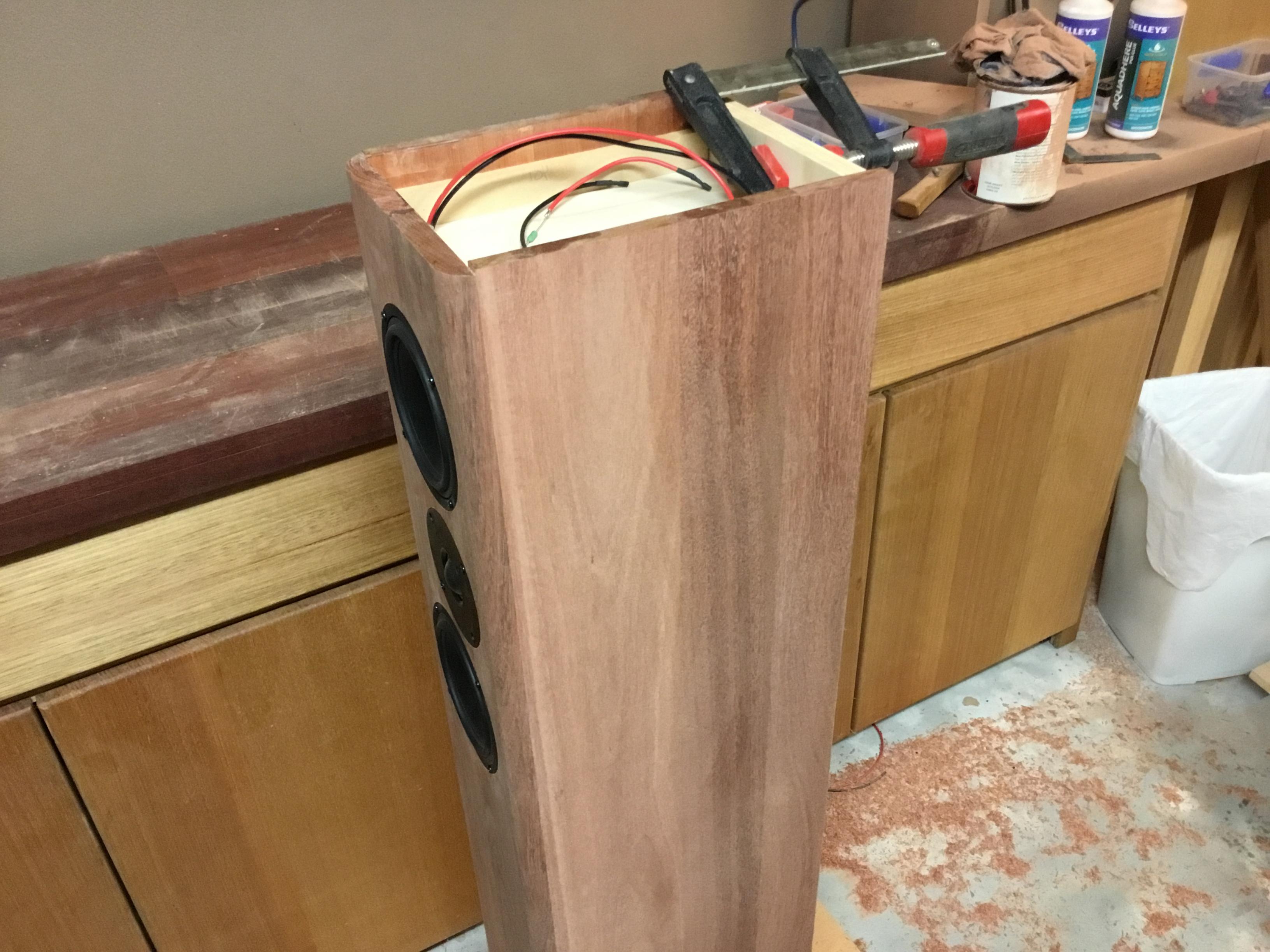

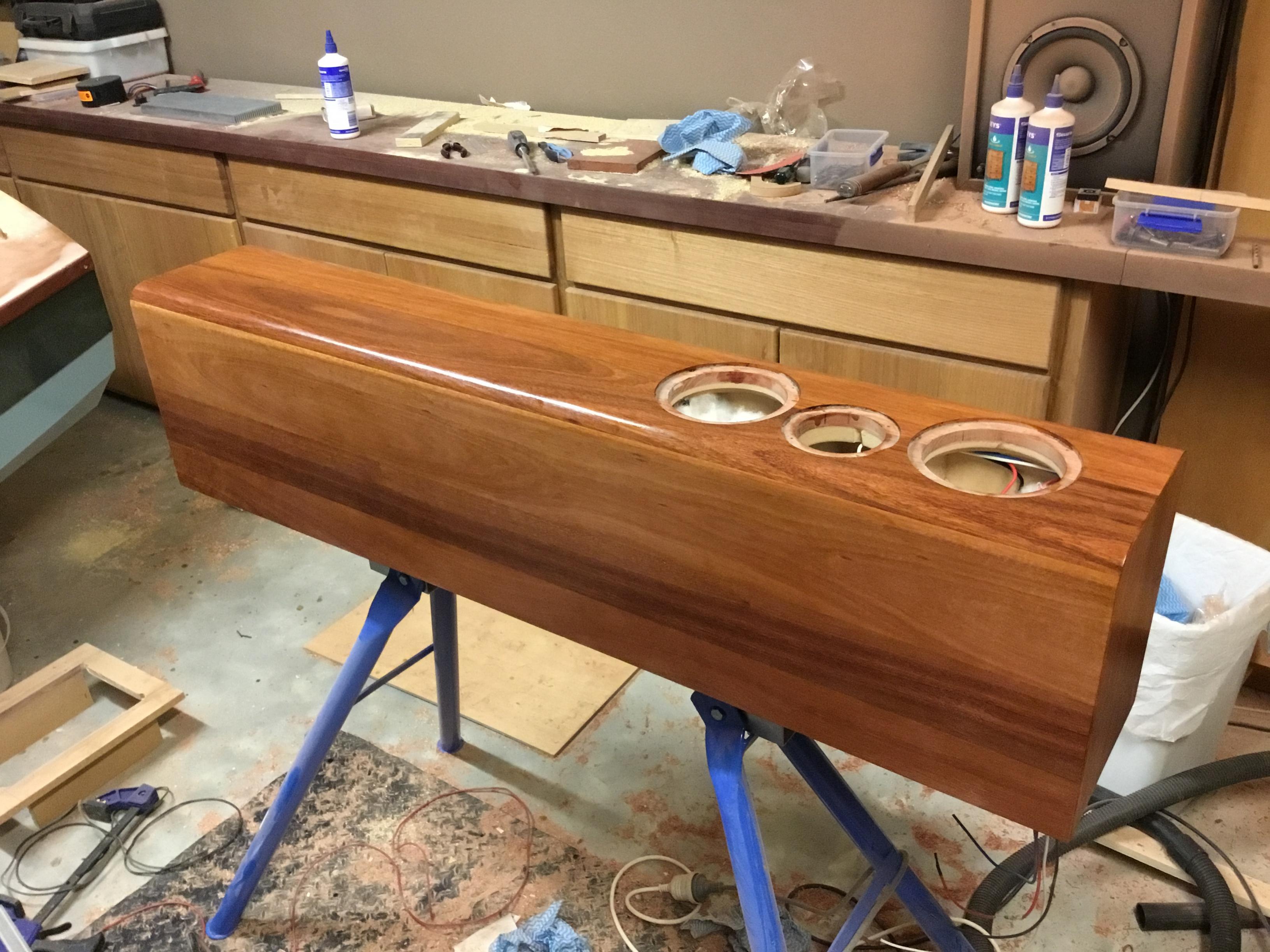

A quick photo at the conclusion of this weekend's work.
I spent some time over the weekend putting a lid on the speaker. I started by trimming the baffle and sides to the right length, then made a jig for the router so I could put a 45 degree bevel on the inside of the baffle and sides at the top. To make it more accurate I took a cast of the top of the speaker using thickened epoxy to get the radius between the baffle and sides just right.
Once that was sorted, I made a top from Jarrah planks, routed a corresponding bevel into the sides and front, and worked the corner bits with a chisel to get the radius to match. It took much of the afternoon. I was happy once I couldn't get a fingernail in all the way round. Then I glued it in place after running some wiring for the drivers.
Finally this evening I've been French polishing it. I'm on to application five. After three I rubbed it back with 0000 steel wool. I've never done French polish on something of this scale, and am having some difficulty keeping my pad just right so it glides. Anyway, it's a work in progress and the cool thing about French polish is that if I stuff it up I just polish the mess back with fine steel wool and keep going.
