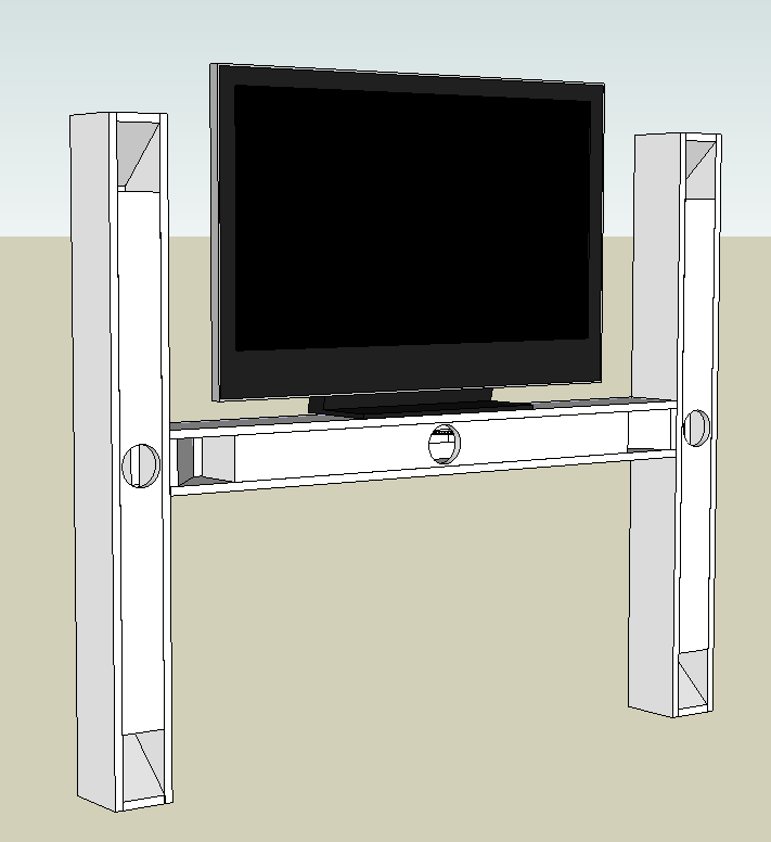

planet10 said:
(unless you want to actually make it the shelf -- you could use 2 as uprights and then rotate another and use as a shelf... LRC in one shelf unit)
chrisb said:
not that's pretty damned cute, Dave and room underneath for powered woofers
my typo - should have been now that's pretty damned cute,
Scottmoose said:
I think I want one. And I think I know what the new-year project is going to be. Nice one Ron. 🙂
Nice indeed, Ron - one more project to add to the forever list (it's just as well there aren't fully dimensioned drawings available )
Love the HT Vampyr layout BTW Dave. 🙂
Unless you can hang on the wall, you'd definitely want some heavy ballast or extended base plates on the L & R mains on this set-up
Of course, you could always build it into a false wall, around, say a disused fireplace, stuff the flue and install a TL sub ......
Dave, think we could sneak that one in? :cannotbe:
REC1 said:
Sims better,
ron
Hmm, unless there's lots of details missing and your program can sim 3D with all the intermediate reflections to get a ~accurate picture of what's going on inside, then my limited experience with this basic concept and a couple of similar layouts tells me it won't perform very well overall and why I didn't pursue it far enough to maybe stumbling onto the Unity concept decades ago.
Anyway, good luck with it. Hope you make it work with an 'FR' driver.
GM
Yep!
Yep#2.
This is just a study into the application. I will work on it.
ron
