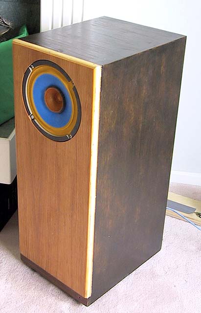

Now with these Vampyr's, can they be designed into a medium-size bookshelf style loudspeaker? IOW, can the depth of them be increased, the width increased and the height decreased?
The reason I ask is because with the current design, they put the driver's way too low at 28.75". That's not much higher than my knees! 😱
It looks like the internal area of the Vampyr is right at 0.5cf, which is exactly what my cardboard enclosures are as well. I imagine the vent area and mouth size would have to be recalculated to function properly as planned in the original Vampyr.
I know I could go with the Fonken, but I would like to be different if possible.
So what do you all think?

chops said:The reason I ask is because with the current design, they put the driver's way too low at 28.75". That's not much higher than my knees!
Tilt them back a bit... standard ear height when listening has been measured to be 33-36"
dave
dave
Not for me... More like 44-48".
planet10 said:
You are WAY off the norm.
dave
That's what I've been told for years! LOL
Seriously though, that's where my computer chair puts me. Plus the way my room is laid out, this is about the only way I can go.
chops said:Seriously though, that's where my computer chair puts me. Plus the way my room is laid out, this is about the only way I can go.
That is probably where my computer chair puts me too, but i don't use it for listening.
dave
Well, since this is just a secondary system, mainly for experimentation purposes, I'm willing to try "off the wall" techniques just for fun and to learn a few things along the way.
Speaking of experimenting, what if I were wanting to try using a bypass capacitor on these 103's, what size cap should I try? I've been doing research on it, but nowhere can I find anything like a calculator or formula for one. I just want to try it to see what it does exactly.
Any pointers?
Any pointers?
chops said:Now with these Vampyr's, can they be designed into a medium-size bookshelf style loudspeaker? IOW, can the depth of them be increased, the width increased and the height decreased?
Surely, although they'll need retuning, as you suggest.

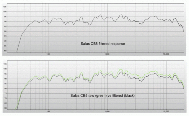

Originally posted by salas
Meaning notch RLC trap?
You know... When people use BSC on some drivers, it takes away some of the top end sparkle. They then use a bypass cap (also paralleled with the BSC) to help bring out the top end again.
I'm not saying my 103's need this. In fact, they don't. But I have capacitors coming out my ears here and just wanted to try it out to see what happens. That's all. Besides, it would only take about 5 seconds to insert them and it's a completely 100% reversible modification.
No, no RCL traps here. 😉
Thanks Scott. If you would be willing to work out the "retuning" for me sometime, or Dave for that matter, I certainly would appreciate it. As far as I'm aware of, there aren't any double-mouth bookshelf speakers around. So this would still be a fist. 😀
It works like an RLC trap when you add a capacitor to it. It goes down, then it comes up again. It attenuates a band effectively. Lighter or heavier Q depends on the resistor, central frequency depends on LC combo. Try it, but be patient, it usually takes a lot of substitutions so to get it right by ear. I attach an example of what such a circuit can do on a speaker in practice.
