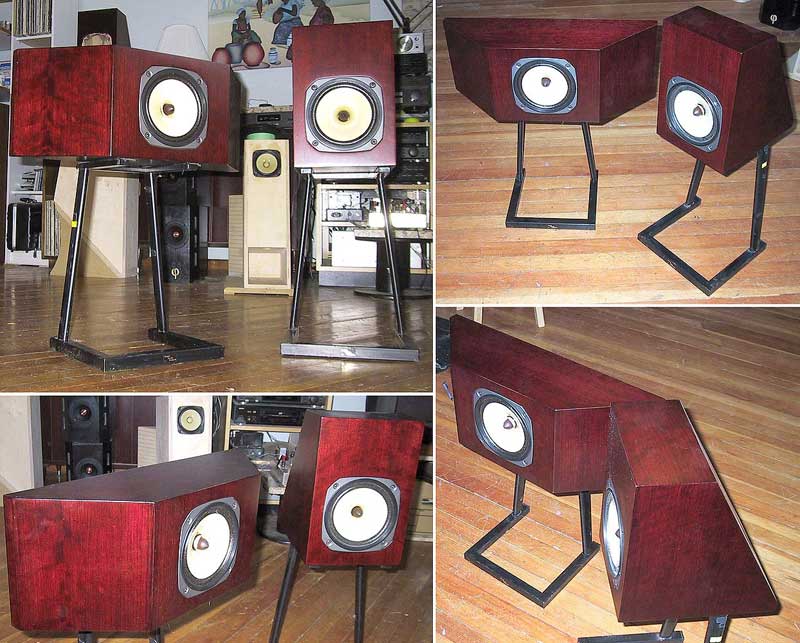

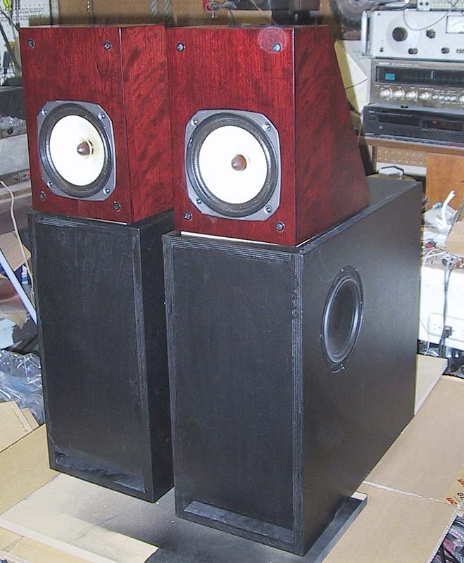

A little while ago, we built a custom HT system using this driver for the front row (L/C/R). Since they could be crossed over fairly high to a pair of CSS 6" woofers per side, the enclosure volume could be whittled down pretty small.
I've temporarily misplaced the drawings, but IIRC, the center channel box was 10litres, the L&R possibly larger.
Certainly something like the factory recommended 15litre box or the Parts Express 3/4 cu ft pre-fab boxes could work quite well. Aside from the former, the only enclosure I've heard them in is the floor-standing sized Fonken, which have no trouble filling a very large open plan living space at my sister's home with a 60w Denon receiver or 25W Jolida 302 EL34 triode amp. I could live with a pair of those for my modest "2.0" :angel: video system ( heck even my wife said "sure" - it's just a matter of time)
Sealed 0.3 ft^3, Butterworth F3 at 106 hz, Add a PLLXO on the sat amp and use a 3rd order butterworth on the woofers and away you go.
dave
