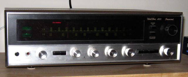

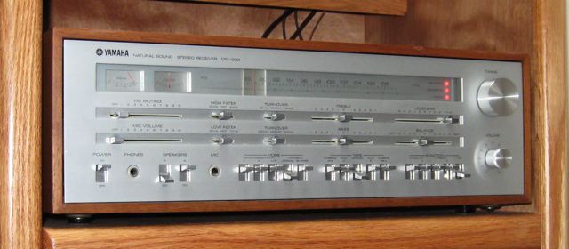

These are two receivers we bought way back when. The Sansui 4000 in 1972; 45 wpc at 8 ohms (didn't notice how badly it needs cleaning until I looked at the photo.) The Yamaha CR-1000, 70 wpc at 8 ohms, dates from 1976. I also have a Sansui 350A (25 wpc) in my office which I bought used some years back.
Younger audiophiles condemn receivers, because to them a receiver is one of those 10 lbs wonders rated to put out 120 wpc into 5 (or 7) channels. REAL receivers are big & heavy--none of that switching power supply or digital stuff!

Jim Shearer said:and the Yamaha:
IIRC, the CR1000 had an optional Class A operating mode (like it's integrated amp sibling the CA1000) - good for only about 10 watts, which wasn't quite enough for Dahlquist DQ10 - but I'd love to hear one today with one of my Fostex based systems.

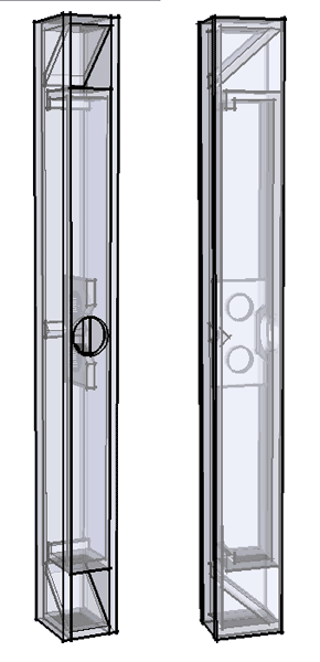

FWIW, until Dave has chance to do the proper ones, 'ere be a roughed up set of plans a la Vampyr. Not pretty & the drawing isn't to scale, but the dimensions are correct.
If one had a pair of "holey basket" FE103A's looking for an enclosure, would the Vampyr, as drawn, be OK?
If not, what changes are recommended?
cheers
Doug
http://www.diyaudio.com/forums/showthread.php?postid=1677333#post1677333
As for the 103A, I've no idea, frankly, without knowing what your units measure like.

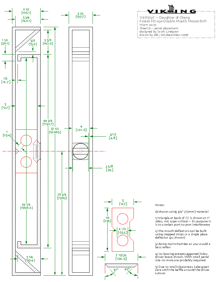

planet10 said:I know you guys are getting eager... so here is a snapshop of the approved, but not quite releasable drawing.
dave
So is this pretty much the final version of the Vampyr? Just curious because I may be starting on this little project somewhat soon.
Just think, they will be the only ones in existence! 😀
chops said:So is this pretty much the final version of the Vampyr? Just curious because I may be starting on this little project somewhat soon.
yes
dave
