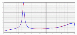

Looking at the FE103E spec sheet, the impedance starts rising right around 600Hz. When impedance rises, an amplifier starts putting out less power to the driver. If this is the case here with the 103, is that the cause of the LF roll-off starting at 455Hz? The driver is getting less power below 600Hz, so it's starting to produce less output also below 600Hz which would probably put it right around -3dB at 455Hz. (funny enough, this is also right around the BSC frequency of my baffles - 467.24Hz)
I mentioned earlier in one of my other posts yesterday that there is no measurement for "Le" in the spec sheet, I'm assuming because the small VC of the 103 acts more like resistance than it does inductance. Since you need to know the inductance of a driver to formulate a Zobel network, it is even possible to make one for the 103? And if so, would it even effect it down around the Fs where the impedance peaks? If it's possible to have a Zobel network that works that low, wouldn't that help a lot in solving the shouty, forward sound of these drivers?
chops said:When impedance rises, an amplifier starts putting out less power to the driver.
Only true when you have a voltage amplifier... if you have a current amplifier, the power will increase. So far the best amplifiers for this familiy seem to tend toward the current end of the spectrum.
attached is an FE127 impedance plot, FE103 will be similar.
dave

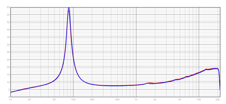

dave
