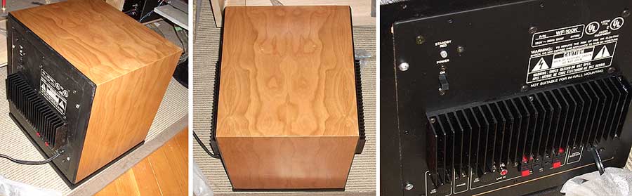

One works fine, plug 2 in and it hums (2 of mine are mounted back-to-back in a box for external use, but i have never been able to use both of them — completely seperate electrically). I also have 2 “subs” each with an amp.
attachment.php
Same trying to use 2 of those.
It is usually most convienient to use the speaker level input, but i probably have also tired the RCAs.
With 4 essentially identical woofers & amps it would help fill out the below 60 Hz region.
dave

Is the hum being radiated from the amplifiers acoustically or is it being induced onto the amplifiers output and then being reproduced by the woofer?
Induced. Definitely elecronic hum. Some others have complained about the same, some have not.
I should hook them back up and check again.
Does reversing the orientation of one of the amplifiers AC cords where it plugs into the wall outlet have any affect?
I could check, but i hven’t seen any plugs that can be reversed any longer.
What happens if there are no inputs connected to either amplifier?
I’ll check that too.
