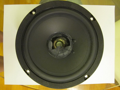

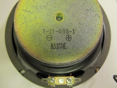

I'm a new member of the group, I'm looking for a pair of 6.5" midbass drivers for my NHT Model 2.5 (not 2.5i), since the middle rubber dust cap was broken, It would be good if you can help to advise where I can find the parts or other alternative to repair it. thanks in advance, much appreciated.
