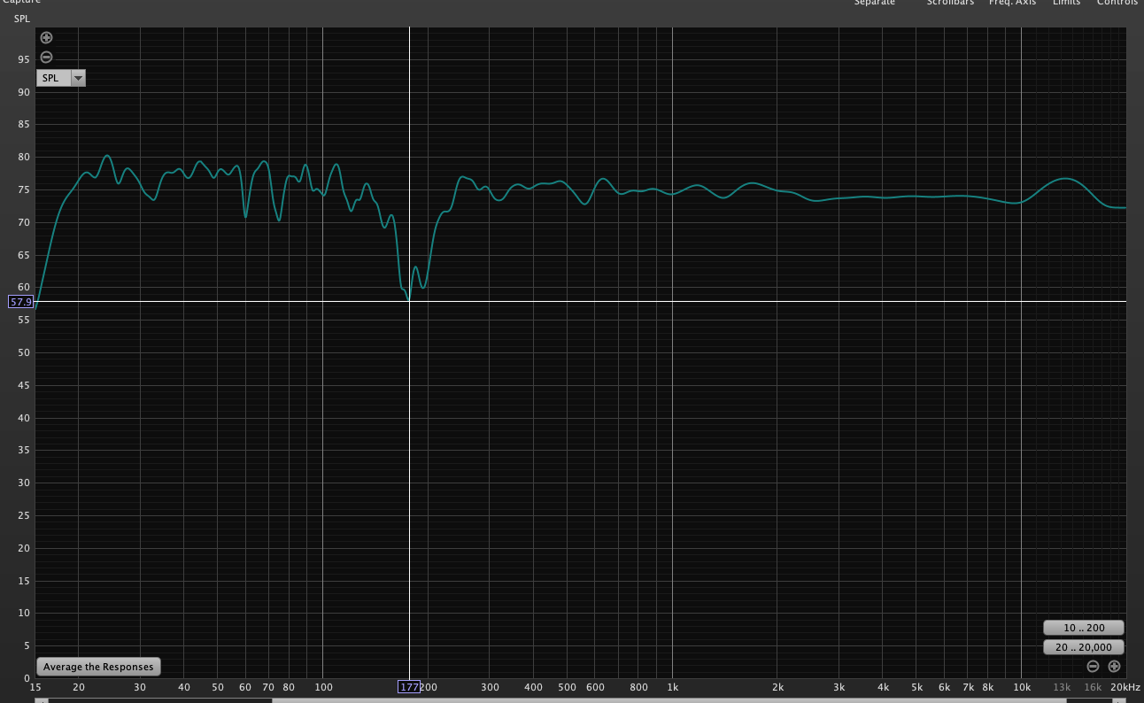

Ok so I finished the initial setup of my plan and everything is looking pretty good except for an unexplained 15db hole from 160-210hz in the woofer.A couple of comments about your plan.

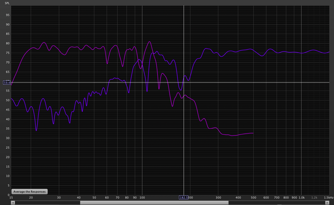

This hole also shows up when I test the woofer by itself. The pink line below shows the Boston VR2000 subwoofer, and the purple line shows the m60 woofer, both measured by themselves at MLP after bass management was applied by the AVR.
Jack do you know if this was a known issue with this driver? Or is there something defective with my unit?
At 180hz, it seems unlikely to me that this is an issue with the subwoofer crossover.
Also I thought at first that it might be a room mode, but given my room dimensions, online calculators show a schroeder frequency of only 125hz, and the last major room node occurring at 150hz. Further, with two huge 10' wide openings to other large rooms, the actual schroeder frequency of my room is probably lower. So too low for a room node to be the cause of the 180hz dip. https://amcoustics.com/tools/amroc?l=27.4&w=20.3&h=9.89&ft=true&r60=0.6

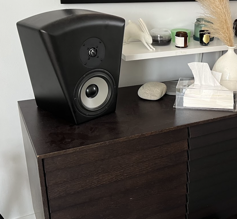

Is it possible that because I didn't install the rubber feet on the speakers that they are sliding back and forth on the credenza with a resonant frequency at 180hz?
This hole is really bothering me so any help would be hugely appreciated!!

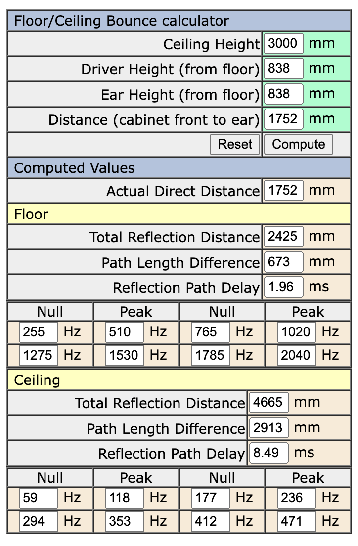

Floor bounce?
http://tripp.com.au/sbir.htm
Try a close mic ( <1cm) measurement of the woofer, it'll tell you if it is room related or a defect with driver ( results are not valid for 300hz and up this way, but at 180hz it should be ok).
Oh interesting. The speakers are sitting on a credenza with about 8" of the credenza in front of the speakers. I had initially done a back of the envelope calculation of the path difference between sound bouncing off of the credenza vs direct sound. I estimated the path length difference to be around 10", which I thought would mean sound at a wavelength of 20" (675hz) would have a null.
But this calculator you linked seems to suggest much lower frequencies for nulls. I'll try moving the speakers to the edge of the credenza and remeasuring.
Thank you!
It's ceiling bounce!! I just redid the calculator with accurate measurements and I get a ceiling null right at 177hz. Also I tried moving the speakers to the edge of the credenza and also lifting them up by 5" and neither made any major impact.
Since adding diffusion or absorption to the ceiling is not an option my room I guess I can say these speakers are about as good as the room will allow them to be!

The first step in looking at any speaker system, is to take nearfield measurements of the individual driver outputs. This tells you what the driver is doing and removes almost all of the room acoustics effects and some of the cabinet affects. Doing anything else first is a waste of time.
