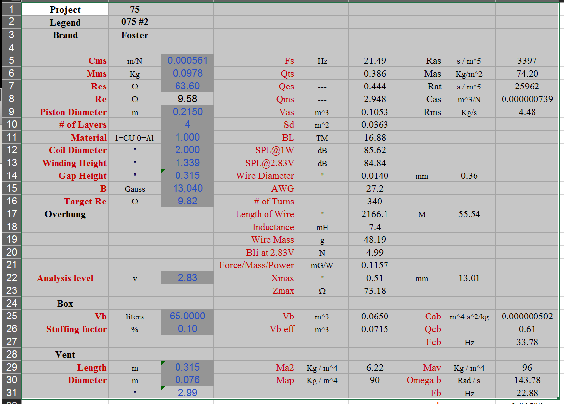

What's the part number printed on the back of the Foster woofers?
Mark,
Parameters for the woofers are attached.
If you put each driver in a 65l (2.3cu ft) box and tune to 33.7Hz with a port, the system will be -3dB at 25Hz.
In the NHT system they were designed for, they were used in a sealed box and had eq applied to them to extend the response. If you want to do that. let me know.

Thank you for the help. Were they the drivers in that NHT 10” sub that they sold tons of? Or were they for a specific speaker? Just curious. If you have more info about the sealed configuration and eq on hand I’m interested, but I probably won’t get to them for a year so no rush...

These woofers were used in the Sub2. Two 10" woofers in a sealed box with a 500W Sunfire plate amplifier. The manual for that subwoofer is at the link below. The cabinet walls were 0.81" thick.
https://www.nhthifi.com/downloads/3124-sub-two
The eq would have been a shelf filter with a high pass at around 20Hz. I don't have curves for the eq circuit that was used. You can plug the driver parameters into any box modeling software and add a Linkwitz transform to it, to get response down to 20Hz fairly easily.

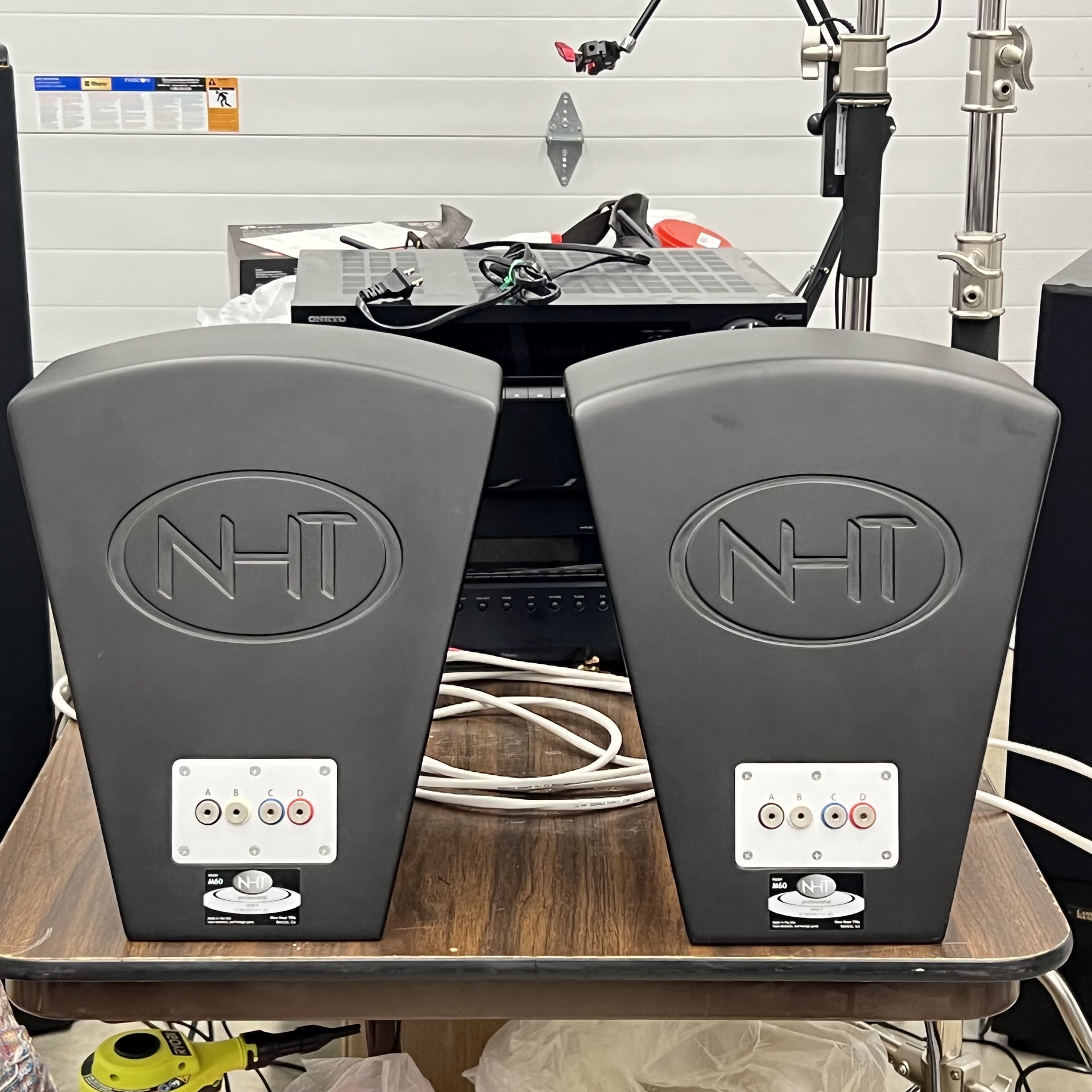

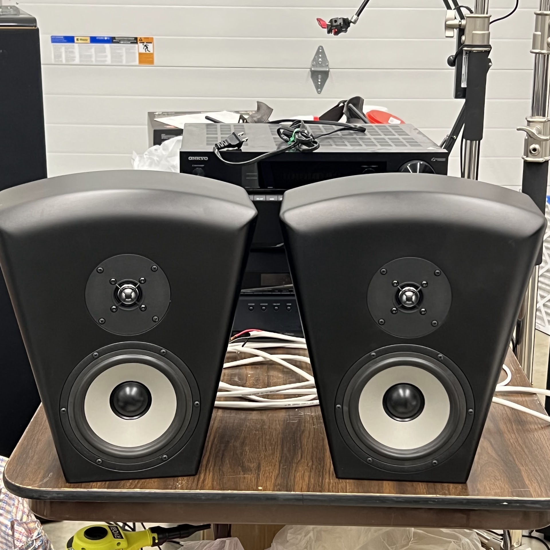

I'm hoping this is the right place to post questions because this is the only thread about the m60s I could find that was at least somewhat active.
So I picked up a pair of NHT m60s today for $20. Yes TWENTY DOLLARS!!! The owner said he received them from a friend who lost the XdA amp after moving several times. I guess I might misplace the brains of a $3000 system if I were moving frequently too...
Anyway, I've been doing a lot of research on these speakers and the XdA amps are very hard to find, still very expensive, and at risk of dying at any moment given their age. So it seems like a MiniDSP 2x4 (IIR crossovers only) or HD2x4 (FIR + IIR) would be decent approach to powering these lovely speakers.

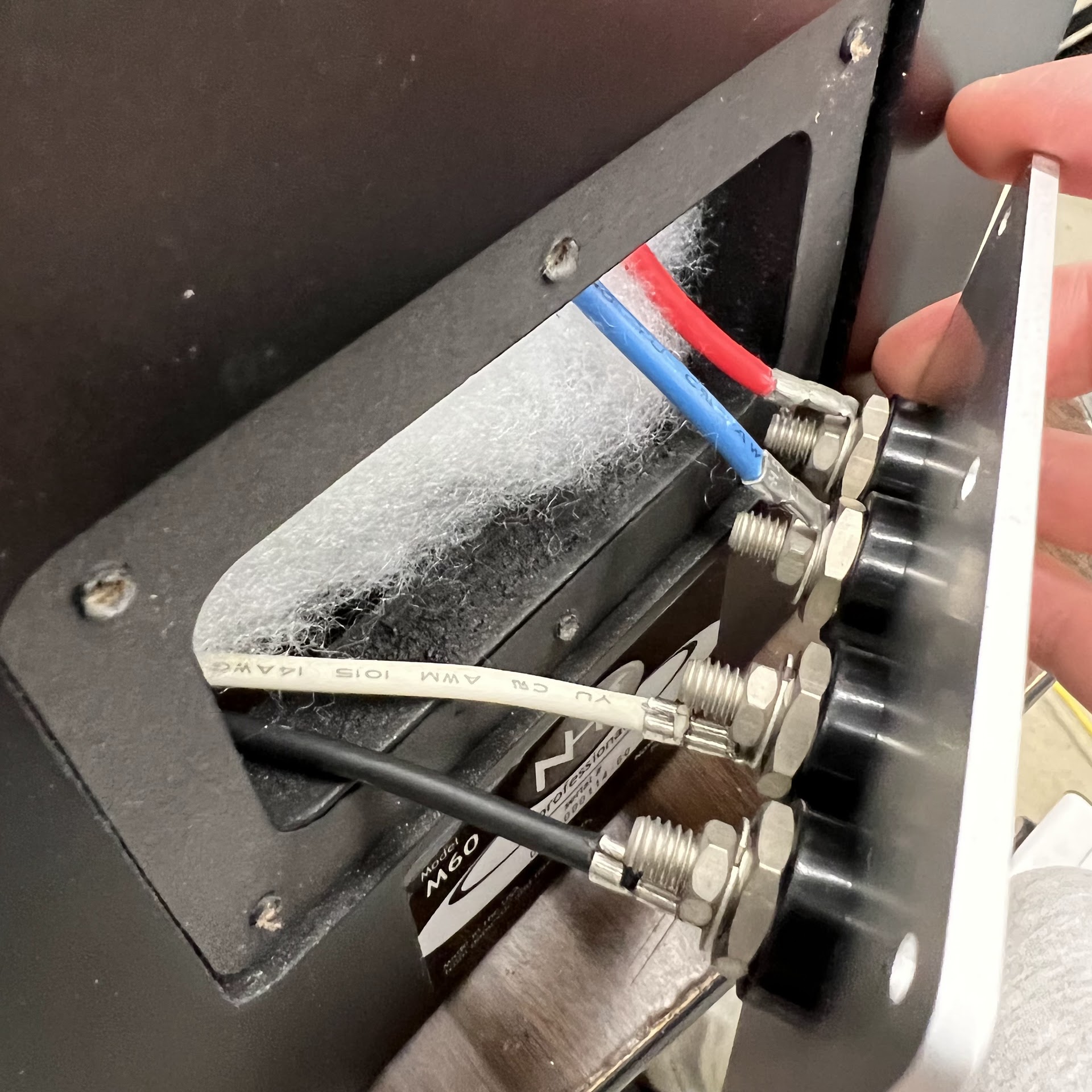

Pretty obviously terminal A goes to -W, B goes to +W, C goes to -T, and D goes to +T.
Thank you for the quick response Jack! Cross over, capacitor, and terminal tips much appreciated.

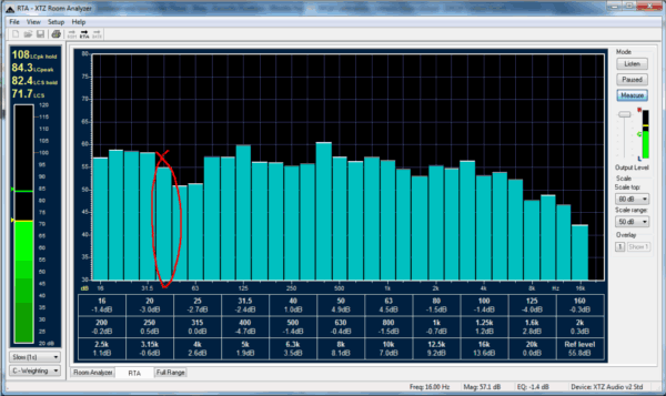

"Take another RTA measurement, but this time slowly change the phase control on your sub whilst watching the RTA bar corresponding to the crossover frequency you have chosen."
Source: http://www.acousticfrontiers.com/20...subwoofer-crossover-frequency-slope-and-html/

A couple of comments about your plan.
The variable phase control on your subwoofer is probably an analog control. Given that, it doesn't actually work very well, especially if the crossover frequency is moved away from 80Hz. A digital filter is going to function vastly more accurately by comparison. This will make summation through the crossover region better.
The technique quoted above about using an RTA and adjusting the phase control until there is the most output possible at the crossover frequency, is total waste of time and should never be used. The only proper technique is to take a 100% unsmoothed acoustic frequency response measurement of the high pass and low pass sections, then reverse the phase going to the subwoofer and take an acoustic measurement of both the high and low pass systems. Vary the phase knob as needed to get a null which is as deep as possible at the crossover frequency. Once you get there, flip the phase back on the subwoofer.
This will work and get reasonable results. Doing it with digital filters will give better to much better results, depending on a few different factors. It doesn't make sense to me, to take a speaker system which is among the best ever built and skimp on the crossover functions to save a few dollars. Before spending any money, I would go purchase a copy of the current LDC (Loudspeaker Design Cookbook) by Vance Dickason. Read through the chapters on crossovers. This will show you how simply putting an 80Hz HP and LP filter on the subwoofer and satellite speaker, does not give you the ruler flat acoustic response that a very basic textbook makes it look like you will get. The crossover functions in your receiver are only going to have very basic, textbook filters in them. You are going to have to be able to EQ the response from both speakers, that when the crossover filter in your receiver are applied to them, that the electroacoustic responses have the shape required, so that the resulting response is flat. This will be trivial to do with a proper DSP doing everything.
