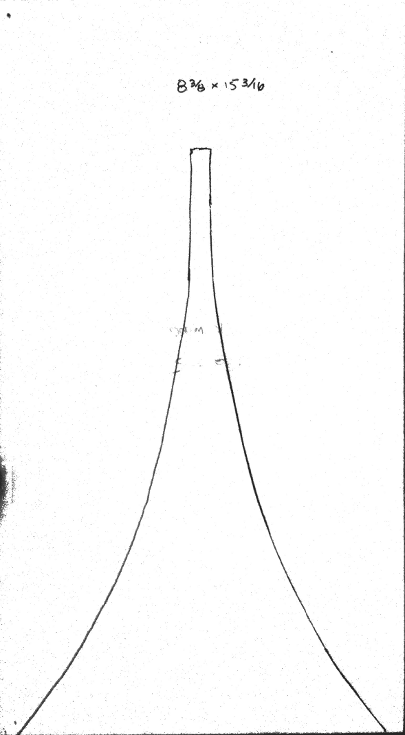

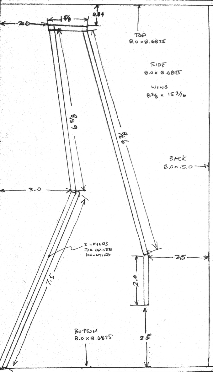

Karlsonator 0.53X Plans Adapted for Foam Core
Here are the plans for Karlsonator especially adapted to utilize only 2 sheets of standard 20 in x 30 in 3/16 in thick foam core sheets per speaker. Make 2 x 30 in long strips of 8.0 in wide sections from a sheet and cut most of the pieces from those two strips. The speaker cabinet is 8.0 inches wide internally. You will also need some in 8-11/16 wide strips for the side panels ans top and bottom from the second sheet. The back is 8 x 15 in even, and the wing panel is 8-3/8 x 15-3/16 in. The slot on the wing starts at 3/8 in wide and 3 in from the end. You can pretty much hand draw the curved arc like I did, or scale my drawing up to full size. It is not critical.
Follow the photos I posted of the build to see where to add bracing - it needs a lot of it. Basically, you need to add bracing to keep the middle divider attached to the back wall and the top and bottom attached to the divider. Otherwise, these large panels will bend and breathe in and out with sound pressure. I use moderate stuffing from the closed end to the bottom turn, with decreasing density as I get closer to the turn. Adjust to taste through driver cutout.
The Karlson aperture or wing is attached to the box with drywall screws onto a stack of 3 layers of foam core blocks (3/4 in x 1 in x 3 layers) glued together and affixed to the inside edge of the box. You will find that 3 layers provides ample purchase for the drywall screws to hold. The TC9FD drivers are held in place with drywall screws through 2 layers of foam core and it works fine.
Start by drawing the plan onto one of the side panels. Use that to start gluing the pieces in place. Notice that the double layer panel for the drivers is offset to sit flush at an angle on the bottom and to provide a notch for the top panel to sit in before gluing. The top vent piece is 1-5/8 in long as it is kind of blurry in the scan. As you glue each piece with hot melt, use a 90 deg piece of foam core as a gauge to rest the part being glued to ensure it is true and square before the glue sets. Once you have all the internal pieces glued on and sealed with a fillet of hot glue, add the struts and bracing. The glue on the top and bottom and back panel. The add 3 of 4 pieces of bracing between the top and the vent shelf. Then glue the blocks to secure the wing with screws. Now is a good test to listen to it with and without the wing to see what a difference the Karlson aperture makes.

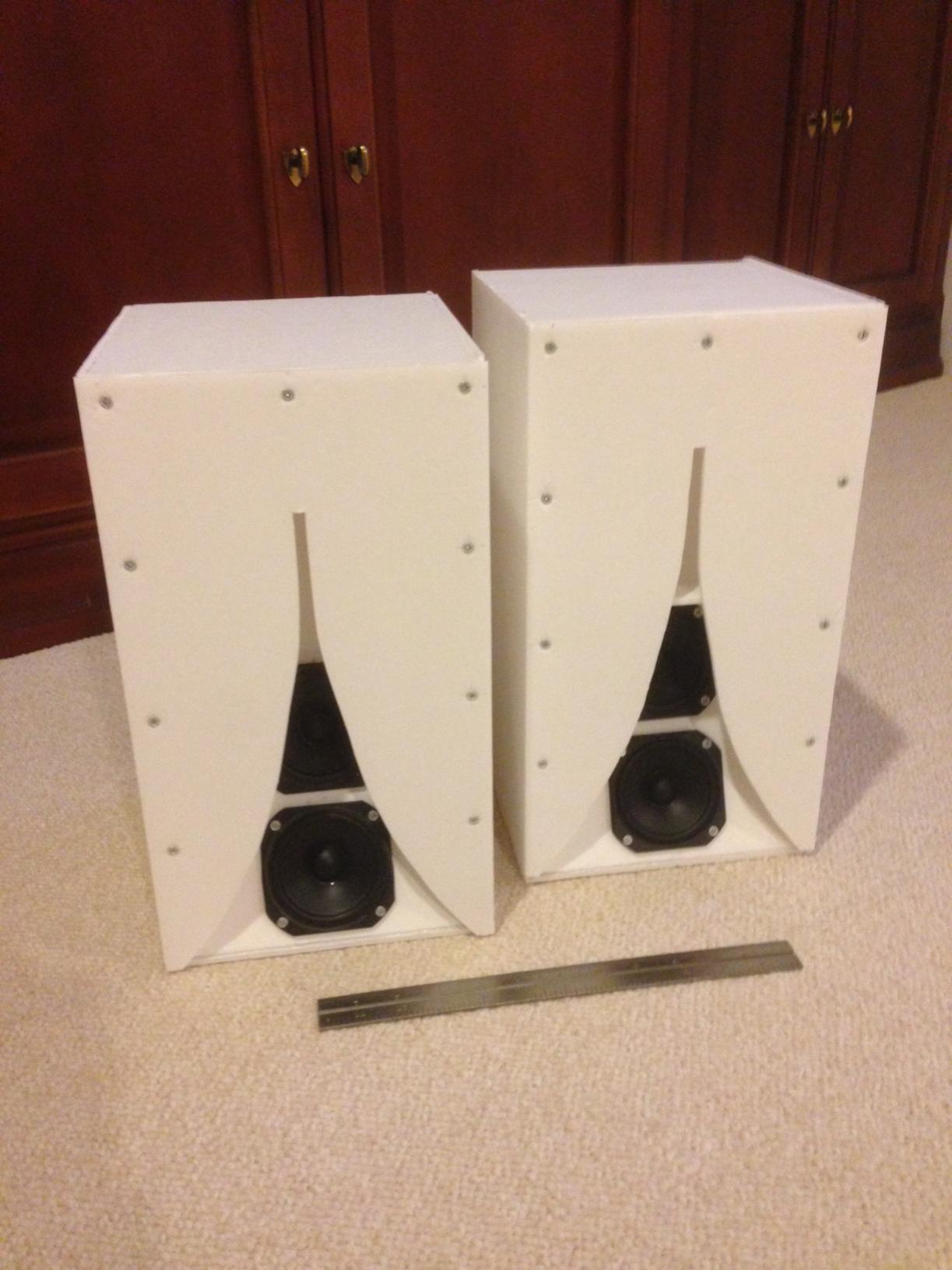

Thank you for the kind words and glad to hear that the Cornu was so much fun for you. As I was listening to these mini Karlsonators belting out some pretty loud clean music, I couldn't help but think that these would be great little stage monitors as they aim up and sit on the floor, and they play quite loud for their size. Not rock concert levels by any means but great for a home jam session with your friends when you need a little box that sounds great. I am really having a blast listening to them in pseudo 'mono' mode and think it will be a great little unobtrusive background 'radio' as you can set this up in a corner or wall out of the way and it will play beautiful sounding radio or background music that sounds good from almost anywhere. As I said, it sounds good even almost 90 deg off axis. Can't wait to hear these in stereo...
I think you will have a lot of fun with these if you enjoyed the Cornu. Very easy to build and probably makes a great and unique gift.

Of course it doesn't sound as good as on-axis (at higher freq), but I noticed that it is clearly better than my usual speaker with just a bare direct radiator. The mids and bass were still pretty good and from a "radio for background" music application, I meant it sounded pretty good. Measurement will require me to get a longer cable for the pc to amp and mic.

I just went to listen to the K'nator speaker and walked around it while it played a song and I have to say the sound did not drastically change. I will record a sound clip as I walk around so you can hear.

The mini Karlsonator is now in Stereo and it sounds absolutely wonderful. You guys should give it try.
