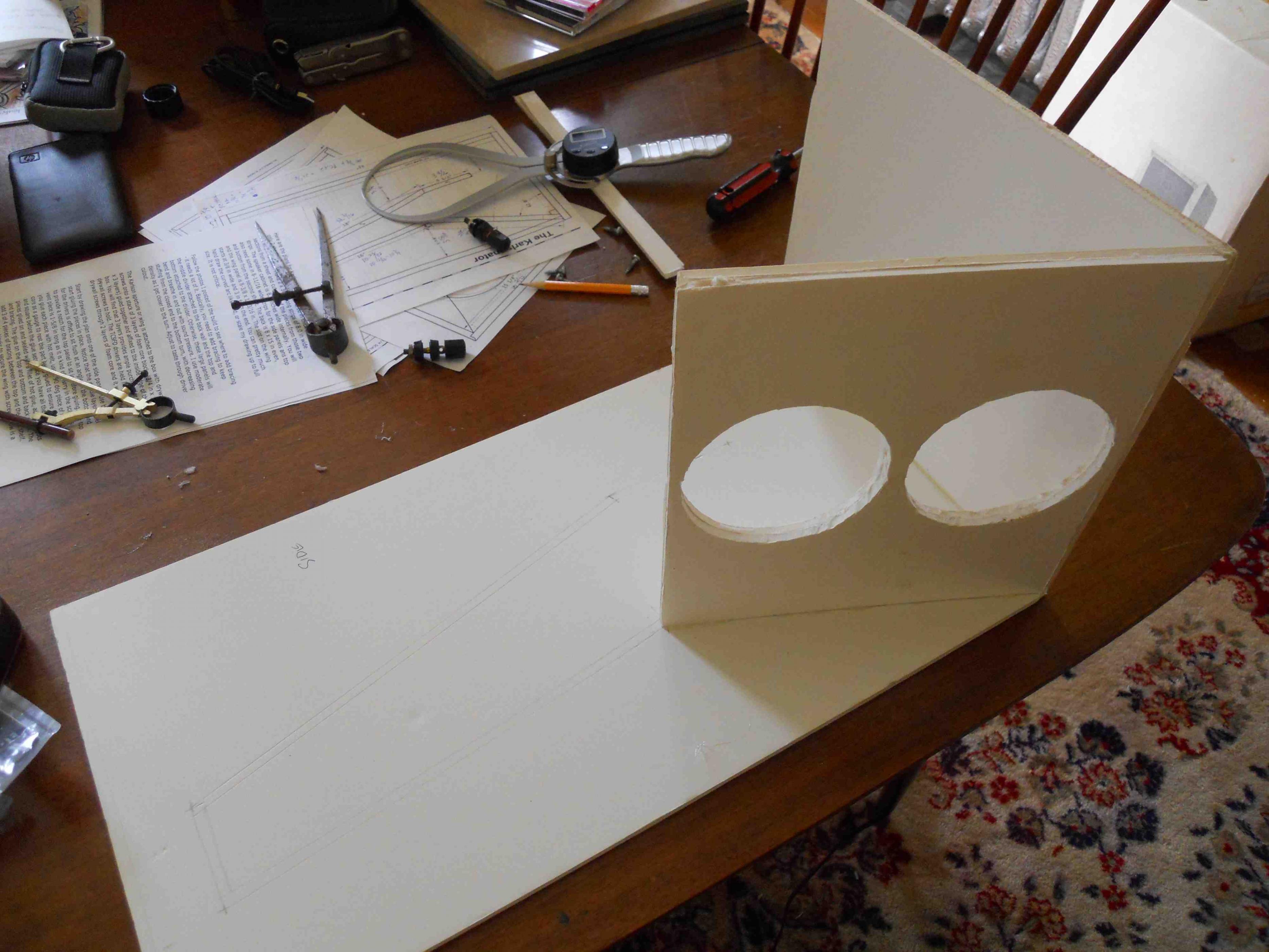

OK, started cutting pieces tonight and glueing a few. One question. The driver baffle (the doubled panel) is only about 9.5" when scaled down by 0.67. Since the driver is 4.5", that means there isn't much between the two.
1. Does that sound correct?
2. Think I should further brace that panel, or will the doubling do the trick?
I notice that the original 12" driver version has that panel at 14", which isn't a ton bigger, so I suppose my measurements are probably OK, but I'm just wondering.

Carl,
There should be just enough room for the two drivers with a 1/4 inch gap between them. I brace the baffle to the internal divider after both are glued in place with a couple of braces to the sides of the drivers. I think I may have braced the baffle to the bottom panel too, look at the photos in the mini Karlsonator thread. In fact, you may want to switch to that thread for future discussions so folks can see what you are doing relative to the posted plans and photos. Of course post link on this thread to finished speaker from that thread. It sounds like you are coming along nicely and I can't wait to hear from you how it sounds. Bracing lots of panels wherever you think there is a large flat surface that is free to vibrate like a drum head. That will increase SPL from the main TL output rather than radiating out through the walls.

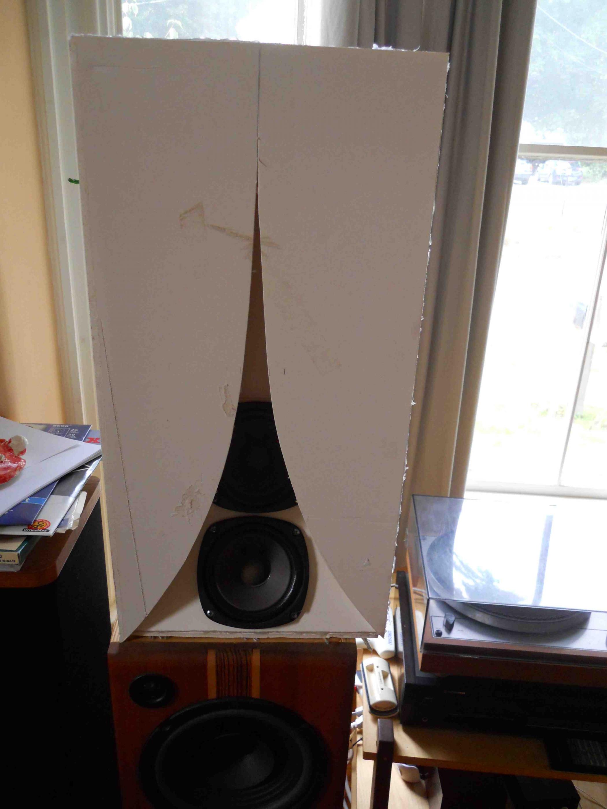

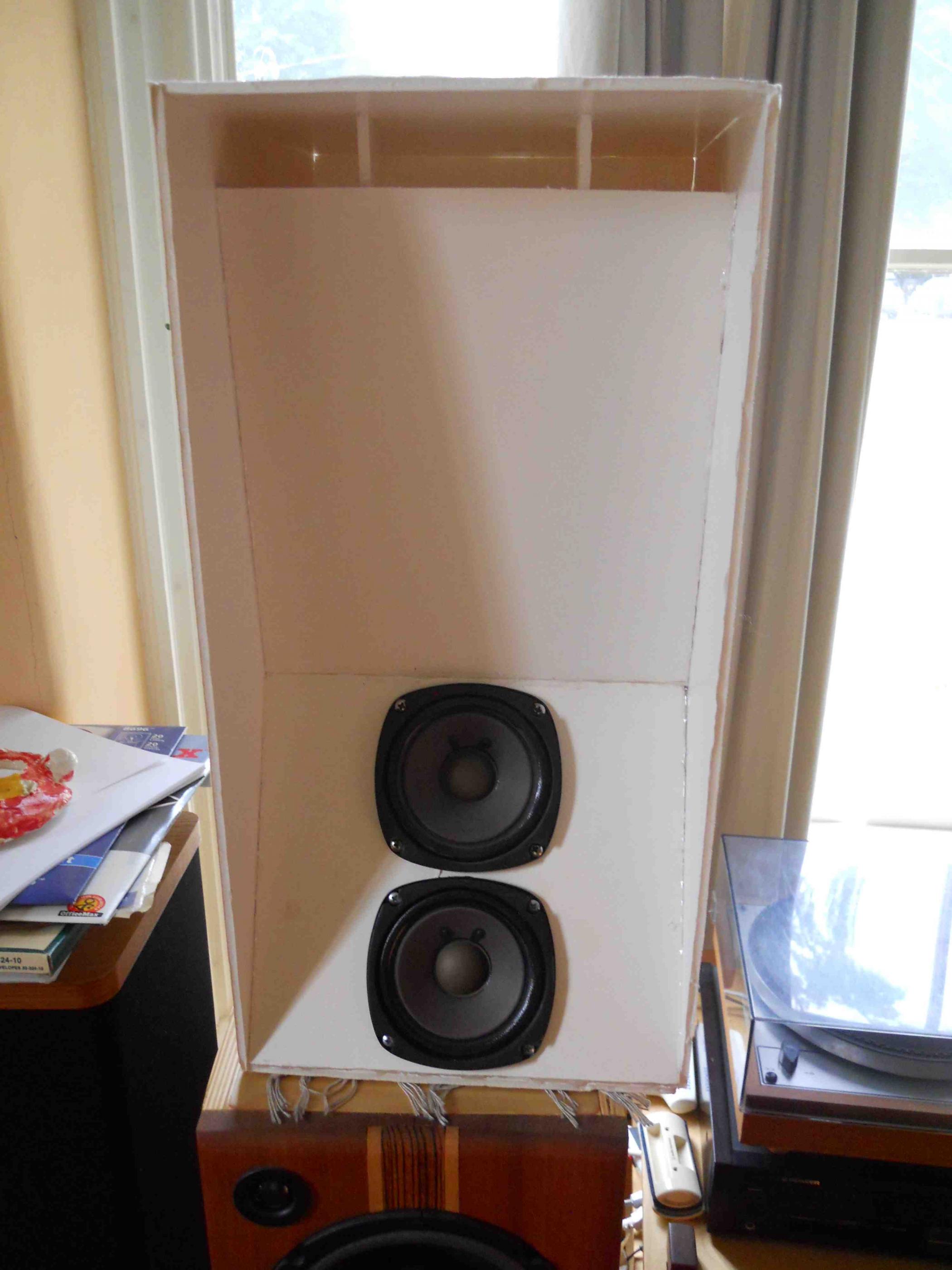

Well, I thought I'd post a few pics, but ended up finishing it today (kids are home and I needed to be too, watching over them). So here are a few pics of the build. Played it just briefly, and it sounds quite nice. No real low end (my test song is I Love You by Sarah McLaughlin, which has a low series of notes that is felt as much as heard, and that was a bit, um, thin), but the upper bass and mids are quite nice. As for efficiency, I wouldn't say they are especially high. I'd guess lower 90s (close to the same as my Pioneer BOFU in a Pass designed TL, just below the Karlson in the last two photos). Oh, and I didn't use the 700+uF cap yet. No trouble with excursion on my 1.5wpc SE Pentode amp (strapped to triode).
I had built a wood BD Pipes with these drivers (not optimized) and I like them a lot for mid range and above - vocals, etc. Even the bass is reasonable in them. I need to hook that speaker up and demo the two together to get a comparison. I suspect the Karlson will beat it pretty readily.
This was a complicated build, but pretty reasonable using foam core. I wouldn't have wanted to try it first with wood!
Many thanks, X. I'll post in the other thread too, with a link to these photos. Maybe more impressions when I get a chance to really listen.

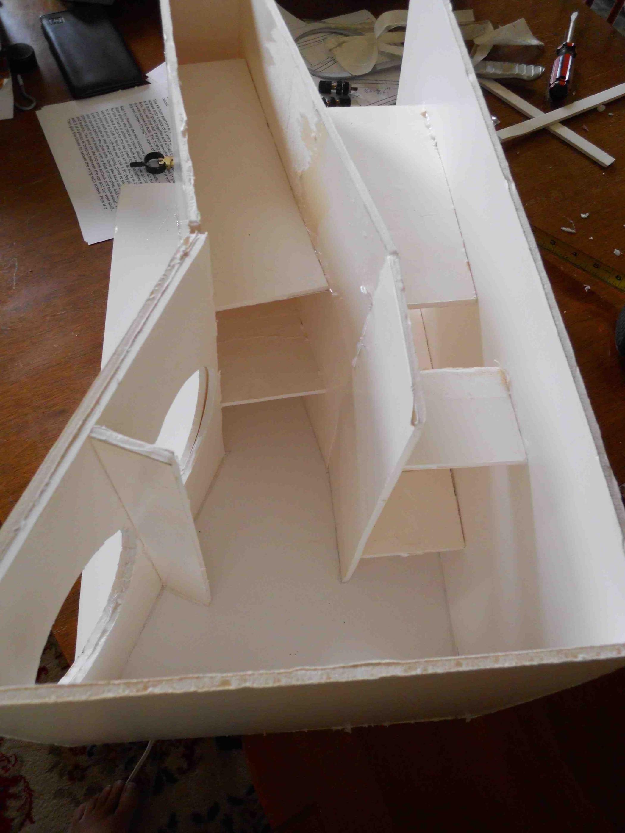

A few notes: The build is rough, but everything is reasonably well sealed (except drivers to the driver baffle, which I hope to try later). I drew the arc of the vent baffle using a thin piece of wood bent to some approx measurements taken from the original drawing. Borrowed a technique from boat building, which I've done a small bit of. Lastly, I did not brace the driver baffle other than a single 1.5" piece between the two drivers (see second photo).

Nice work Carl!
As for the thin bass, try this with the speakers - they are meant to be placed on the floor next to the wall right behind them - this should bring the bass up noticeably and is how they are placed in the sims which IIRC gets down to 50 or 60 Hz. Not deep but good enough for most music like pop or jazz.

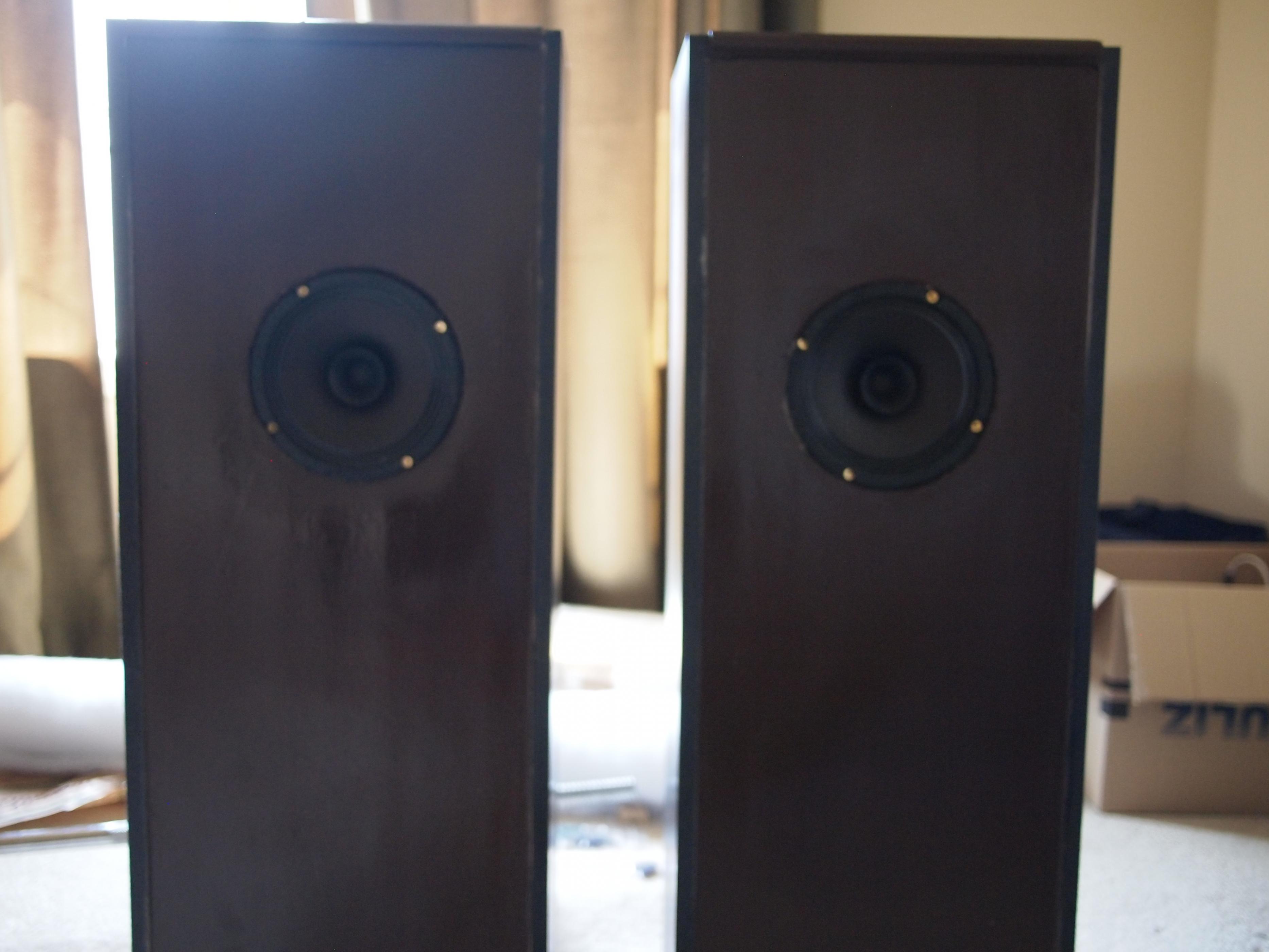

Those Visaton drivers are fine speakers for the money. Nice job on the enclosures. Is that 1/2 foam?
Thanks. I used 3/16 30x20 dollar tree foam boards and doubled them for the front, back, top and bottom. On the sides I added pre-finished shelving boards from HD and they serve as stands also. The enclosure size is 12x8x30(WxDxH) and has a single fold.
They sound pretty good, there is a mild emphasis on the bass and the highs are a tad rolled off but for the money these sound very good.
