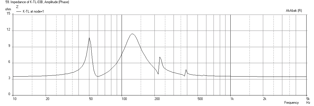

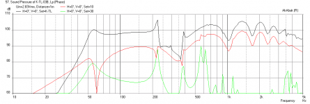

OK, I'm tempted by the Karlsonator. I've wanted to play with this design for a while but not willing to commit to a wood build nor full-size drivers. But I could give a go with foam core and I have a quad of this speaker:
Pioneer A11EC80-02F
Paper cone w/cloth surround.
20 watts RMS/30 watts max
Voice coil diameter: 1"
Impedance: 8 ohms
Frequency response: 70-15,000 Hz
Magnet weight: 9.3 oz.
Fs: 70 Hz
SPL: 90 dB 1W/1m
Vas: .31 cu. ft.
Xmax: 1.1mm
Qms: 1.40, Qes: .47, Qts: .35
Diameter: 4-1/2",
Mounting Depth: 2-3/8"
Any thoughts about applicability of these dirvers? Anyone care to help me figure out how to size for these (I'm willing to do the work but don't know where to start).

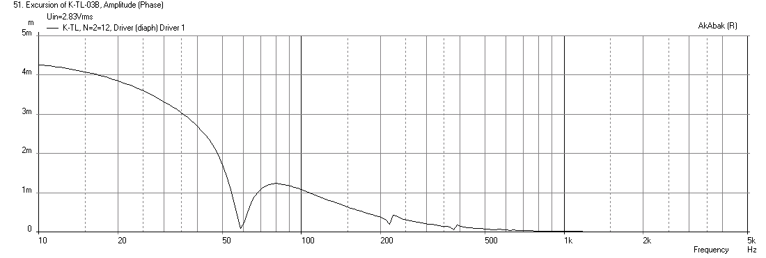

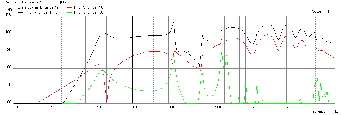

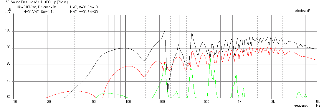

Dual Pioneer AC11EC80 in 0.67X Karlson

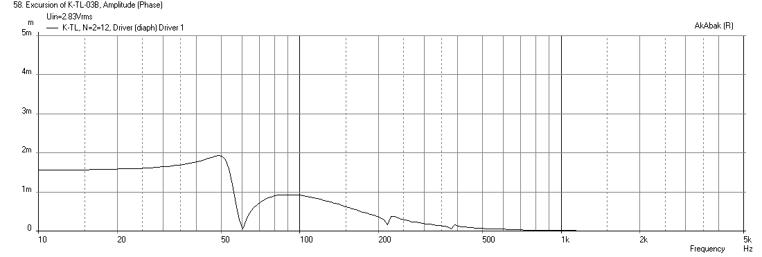

CarlP,

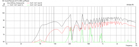

Here is the sim of the Pioneer 4.5 in full range in the Karlson. It looks like a 0.67X Scale cabinet with the vent further scaled to 0.90X works well. There may be an issue with cone excursion though. It sure is sensitive with two drivers though. This is 2.83V into 4 ohms so it really is 2 watts input power. Measured at 1 m with speaker 1 in from wall. The last plot is the speaker 60 in away from back wall and mic at 3 m away. The bass has some fall-off and I am not so sure about the rising response - the T/S parameters were kind of sketchy. I googled the Re at 7 ohms and Sd at 64 cm^2. They may not be right.

Wow, thanks a ton X! I wondered about the low Xmax. Looks like a problem primarily below 50Hz, but this driver doesn't do much below 70. I wonder if I might I be safe anyway. Hmmmm. I may try it but I like the drivers and don't want to damage them...
Also, any idea what happens above 5k Hz? These aren't stellar in the way upper ranges, but I'm 50+ and don't hear a ton up there anyway. More hmmmm.

FWIW, a bit more realistic specs.......
GM

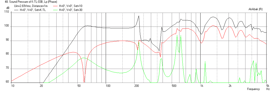

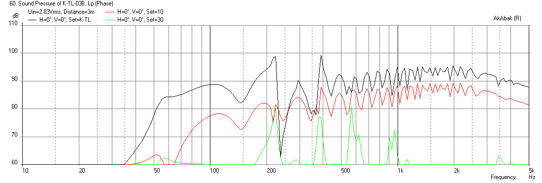

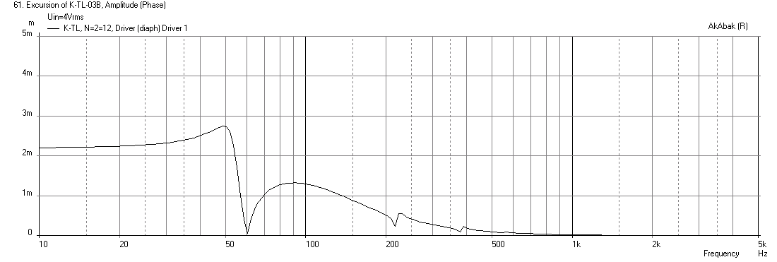

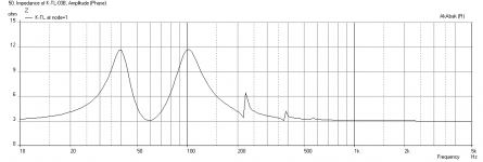

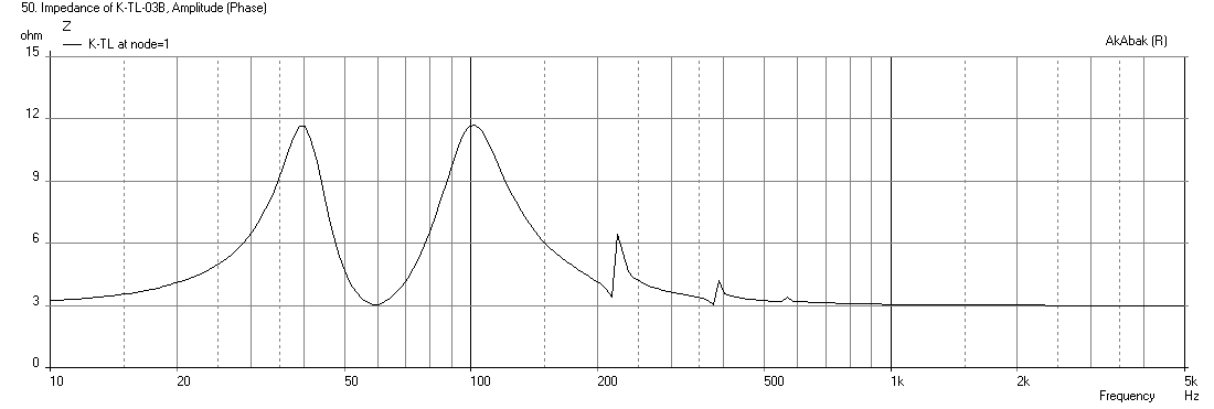

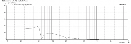

Here is the sim with GM's T/S parameters and same 0.67X scaling as previous. First is speaker 1 in from back wall at 1 m measurement, next is impedance, third is cone displacement, fourth is speaker 60 in from back wall and mic at 3 m from speaker. I would not worry too much about the excessive cone excursion as long as you use a low power amp (< 5 watts). The last plot is cone displacement with 4 watts input power (4 volts into 4 ohms). Below 50 Hz, you will hit 2 mm of travel (probably OK?). The revised T/S params have a much weaker motor and the cone motion is pretty well controlled I think. If you are really worried, place a ~750 uF cap, that can probably be placed in series to high pass and prevent excessive excursion.

Thanks for the input, guys. I don't yet know how, nor have the capability, to measure T/S params (though I do want to start trying). I have wondered about the 70Hz Fs figure but I currently run them in a "BD Pipes" enclosure (transmission line) with rear firing driver and no baffle step correction, and they go surprisingly low (no measurement).
Thanks a ton, X. I'll probably be running it on SE amps (tube and ss) from 1.5 to 5 wpc, and not especially loud, so I'm probably safe. If the efficiency is really up there, I'm interested to see how the low end sounds. I was starting to work out the cap high pass to at least run tests (I thought it was more like 400uF for 50 Hz - 750uF would go lower - so I should check my calcs).
