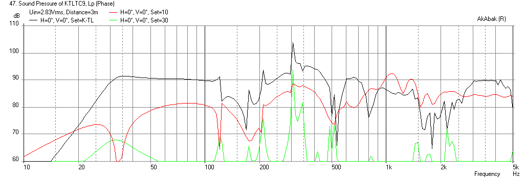

Jamikl,
Let me see what I can do with a simulation running the FF225WK. These are 8 inch drivers and you want to run them as a pair in a Karlson type cabinet? Do you have a preference for the TL type Karlsonator or the traditional Karlson 6th order bandpass box with vents?
Thanks for your trouble xrk971. I think, from what I have seen on the three threads here that the Karlsonator might be a bit smoother. I do wonder how rolling off one of the FF225WKS early would affect that. I think I would like them inline, like your small one, rather than side by side. Can you easily simulate them mounted both ways. I guess that if side by side was ok I wouldn't want to roll one off - might give strange results.
jamikl
jamikl
Dual FF225WK in 1.24X Karlsonator
I am sure glad you asked me to sim this because it is simply amazing what it can do! 🙂 The sim is posted in the Kicks Butt thread here: http://www.diyaudio.com/forums/full-range/237948-speaker-kicks-butt-large-spaces-23.html#post3562113
Here is a teaser of the freq response at 3 meters:
This may be the Holy Grail of the Karlsonator - a true 30 Hz performer that throws a flat bass shelf far away.
