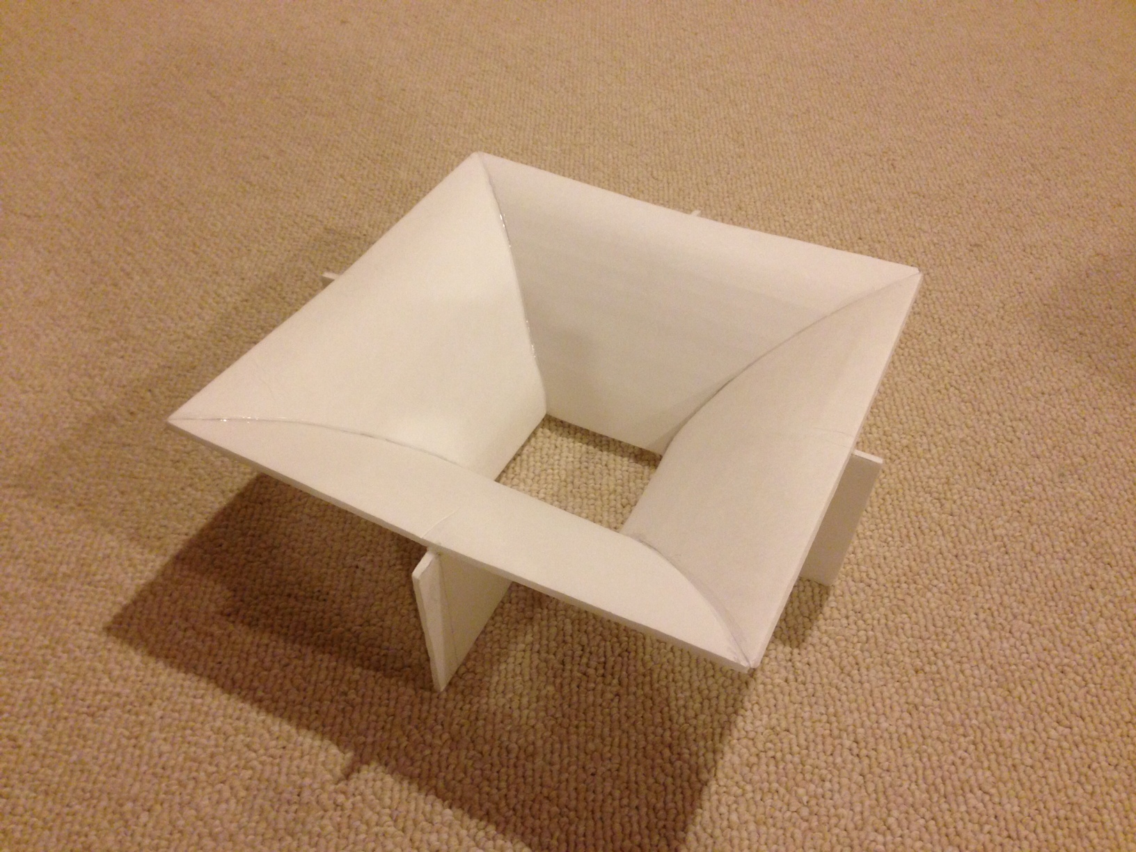

I remember your horn. When you say too aggressive, does that mean there is HF falloff? It's easy to scale plan with printer prior to cutting to get your size.
I got ~6dB of gain from 400Hz to 4kHz and a roll-off above this, too much.

Plan for Tractrix Horn in pdf
Here is the outline plan traced from the actual pieces used for the horn. It is in pdf so you can scale it to fit your throat width to match driver.
Let me know how it works out.
Have fun. 🙂
I finally finished the tractrix front horns. It was easy to make using the 'score the concave curved side' technique. The hard part was coming up with the pattern - I did it with regular paper by trial and error to get close, then the final foam still needed some trimming. The resulting horn has a 4 in x 4 in throat and a 13 in x 13 in mouth with a 4.5 in length. I did a quick test by taping it to the front of the FH3-inspired FC speakers and wow, you really notice the gain in mids and highs from a distance away. Also the presentation was wider, you can walk around more and still hear the highs clearly. The trick is to make the brace first with the correct profile, hot melt the horn panel to that first. Make 4 of those sets and then glue the seams together one by one. If anyone is interested in the pattern, I can scan that and post it.
Have fun. 🙂
Yes for now, they will be forward firing. My listening room precludes rear facing to a certain extent as it also doubles as my movie room and one corner has a sub and the other a built-in av rack.
Scaling horns generally doesn't pan out well.

So true, as the length controls the cutoff frequency. But this design was made without any math other than approx expansion ratio desired and need to try making a tractrix for fun. I have no idea how it measures as I have not had chance to get the measurement. To my ears it sounds like there is a definite impact on sound level gain in miss and moderate highs. Probably scaled to 3 in throat will be better for HF as length is shorter? I haven't figured out how to put a tractrix profile horn in AkAbak yet.
When you start with an arbitrary throat, then odds are it’s already misaligned and needs a smaller or larger throat, which in turn affects its length, but yes, as the gain BW shifts higher in frequency, the horn gets shorter.
