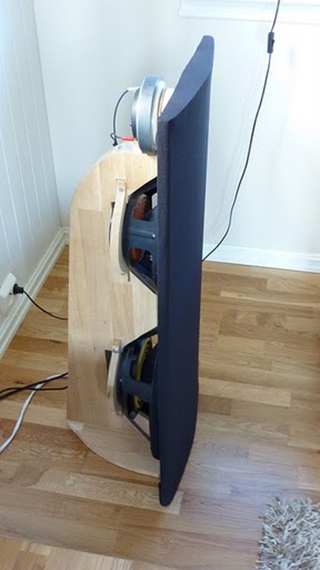

BTW... Since I have a sheet left. I am going make some low frequency diffuser fins on back of the bass drivers directing it upward at an angle of about 22 degree and see how them sound...

Very nice OB build. Can you provide details of the drivers and crossovers? How did you size the baffle? Or it just ended up as 20 x 30 in as default stock size? I think offsetting tweeter and mid slightly to one side reduces diffraction losses. A wood frame is only needed if you feel it is not stiff enough. The foam core is very durable humidity wise if you have three layers. A frame will make it very tough. I like the box made of FC on the back of the woofer. I bet it sounds fantastic.

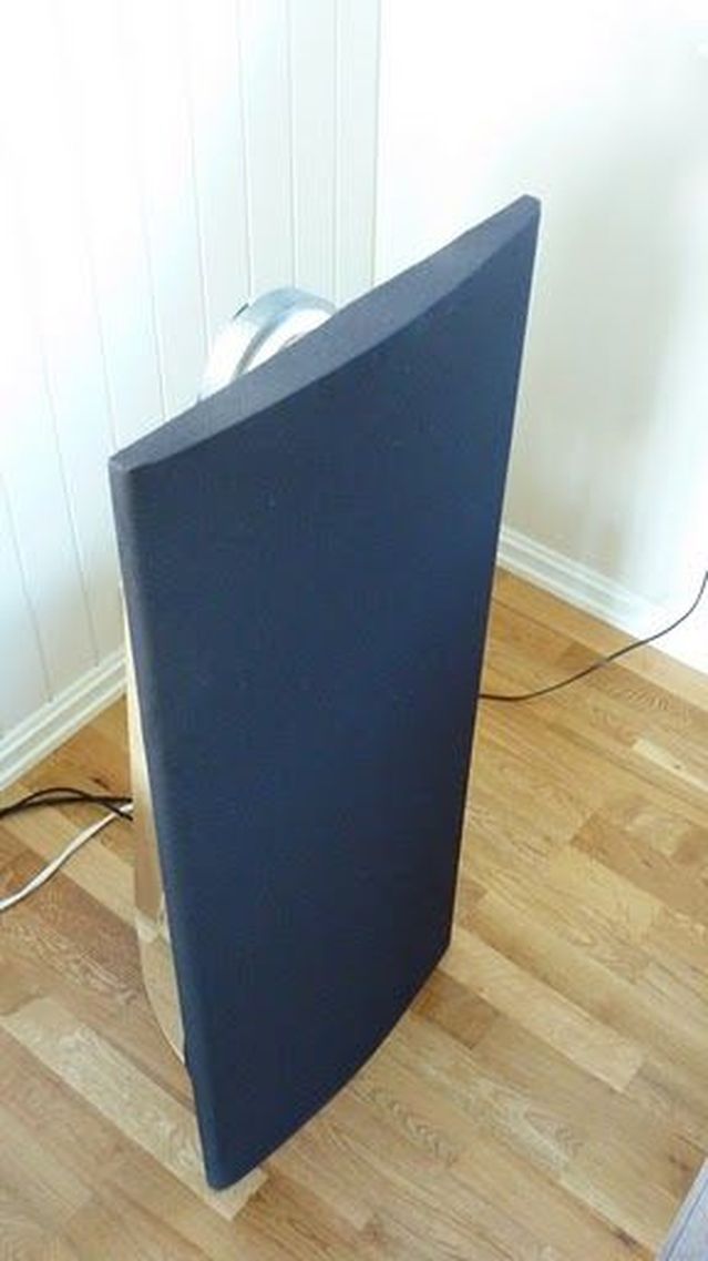

A single sheet of FC (20"x30") is a perfect size for OB, I glued 3 layers for the baffle with the help of guerilla glue bought from home depot. It take less then a hour to complete bought speakers and used a total of 7 sheets.
The 15" bass driver is from an Akai SW-177 crossover at 250hz(2nd order), the mid is a 5" dynavox full range cross at 8khz (1st order) to a Philip tweeters (2nd order)
I am very happy with the result of using FC for this OB project and strongly recommend all diyer try the FC for your next OB speakers. It's simple and easy to built.

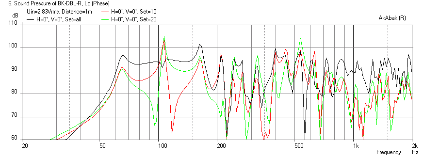

Some serious diffraction/reflection problems there unless I'm really missreading the plot

The woofer sounded is really good on OB... It's goes deep and strong without raddling the FC baffle... Good stuff to use for speakers application 😀

I think what you may think is diffraction (10 Hz spaced comb peaks) is not. Those are individual horn resonance peaks and I tuned each horn so they are offset, so that the combined output doesn't have any appreciable dips or holes. With stuffing, the sharp peaks should smooth over. AkAbak has diffraction and baffle step from the baffle accounted for in the model.

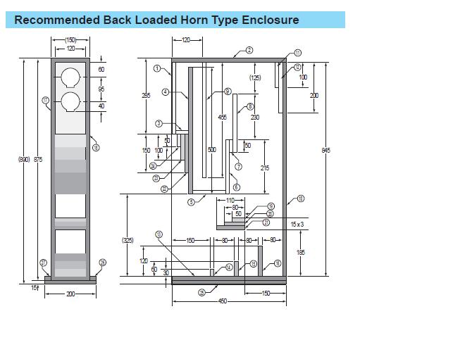

This is a sketch of the type of design mod that is required to implement a double uneven length horn. Although not shown, the sims above are for this geometry but somehow with the mouths exiting on the back.

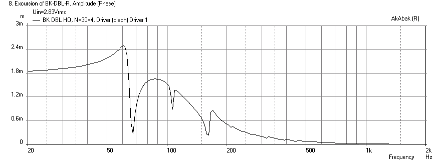

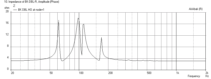

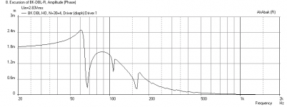

Sim of Double Rear Horn with Dual Peerless 830986
Fringy,
You are in luck! 🙂 These Peerless drivers work quite well in this design when doubled up. I have them modeled as a parallel connection. The response is quite nice in the 95 dB region with 2.83V at 1 meter away. Below are the frequency response, the cone displacement, and the impedance.

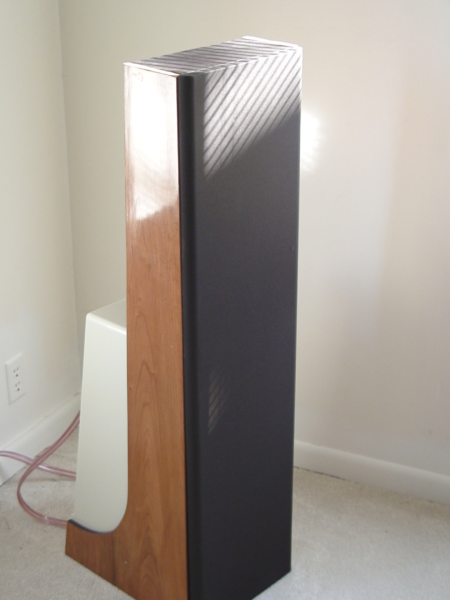

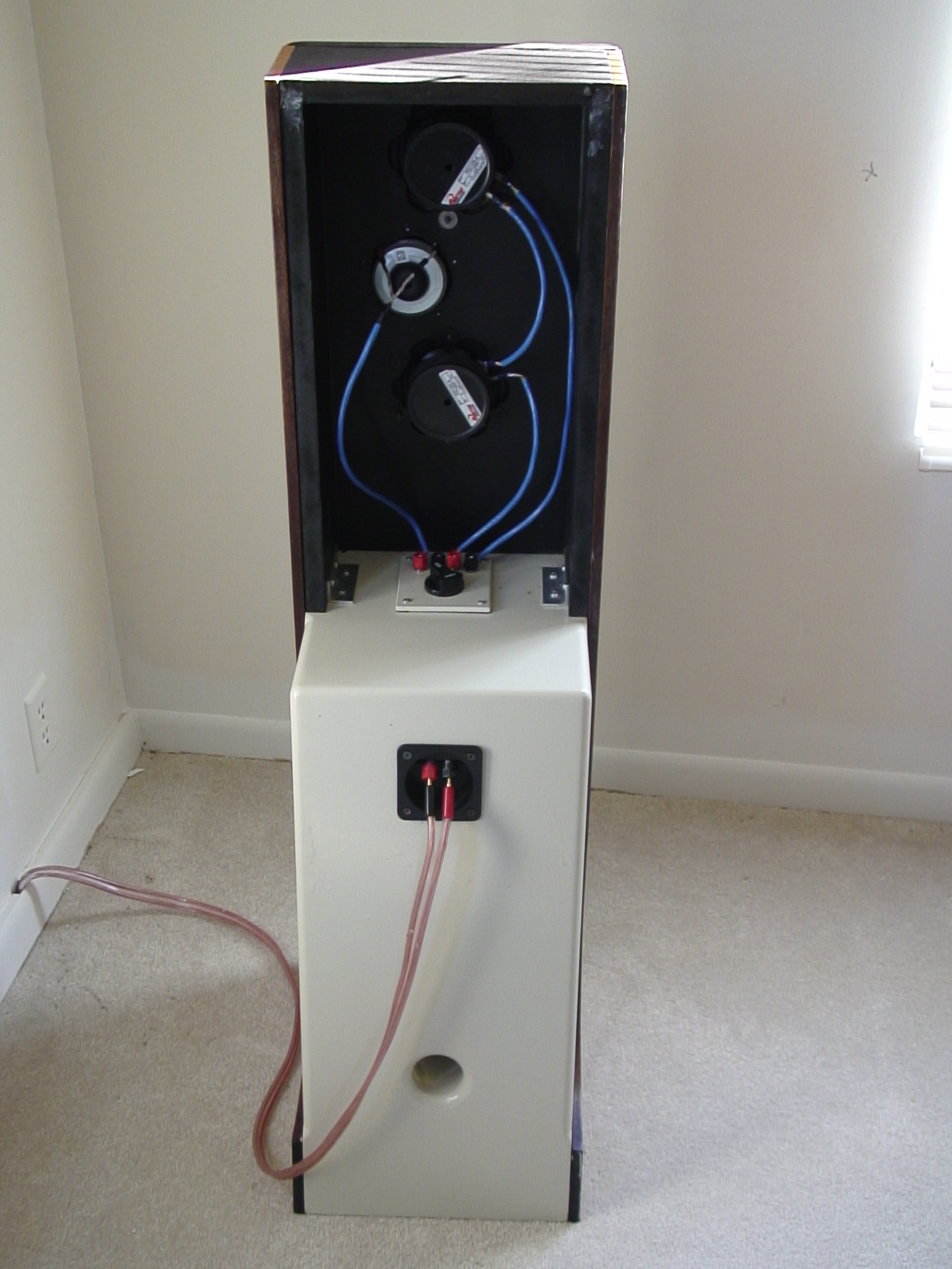

You have a lot of nice speakers and amplifiers, I am envious of your stash of supplies. Are those the Sunflowers? What is that white box made of? Looks almost like foam core! 🙂
The design of the panpipe pentahorn is pretty good as is - were you waiting for more refinements? Tom Lang is making a nice sketchup model with dimensions so maybe wait for that?
Thanks - I honestly have too much STUFF! Yes those are the sunflowers - best I have owned -period.

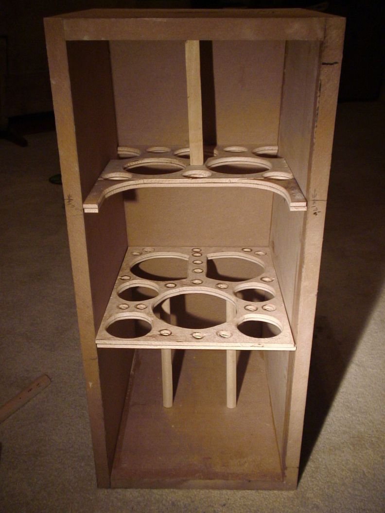

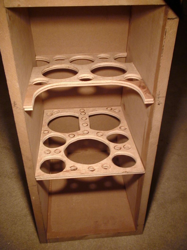

I did the low end chamber based on the B&W honeycomb technique. The material is MDF with 6 layer plywood internal web bracing. The corners were routed with a large radius bit and then painted with Krylon satin spray paint. They actually look like metal in real life.
I don't know if anything in FC can totally match a full wood build, but that's not an issue in my mind. The FC projects come together fast and inexpensive and the process is very enjoyable.
