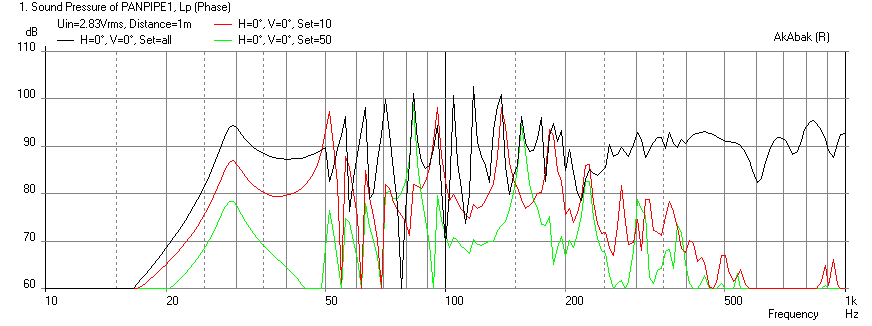

Clearly, this is a project for the advanced Foam Core diehard looking for a challenge. 😀 The cabinet will be a reasonable size as the horns are 5 in x 8 in at the mouth for four and the big one is 5 in x 12 in. I estimate the cabinet to be 4 ft tall x 2 ft wide x 18 in deep.
Here is the total output (black), longest horn mouth (red), shortest horn mouth (green).

The black curve looks good! Can you get the 40-50hz above 90db without sacrificing the response out to 1khz?

No promises, but since I'm already firmly impaled on your hook, lets see what you come up with.

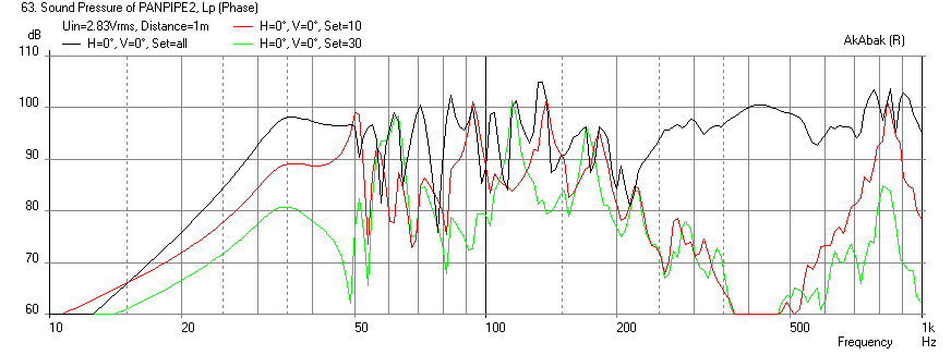

This may work with the budget 5 inch Celestion $13 driver - I will check. But in case you are interested in a 95 dB sensitivity premium version, here is a Panpipe BLH with Tang Band's flagship 8 inch W8-1772 full range driver.
I'll play around with it a little more but to increase gain requires a bigger mouth. Maybe increasing mouths is in order but that may make spikey peaks go up too although they will be smoothed with damping material.
I don't think I have seen another horn have such good fill between those peaks which are typically 40 to 60 Hz apart.

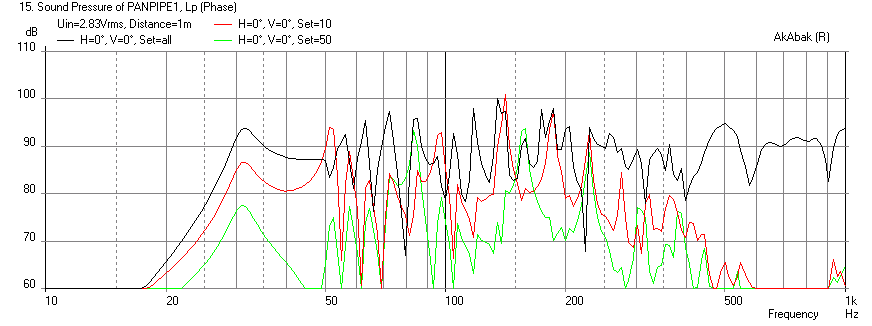

Ryan,
I am surprised that the SP50X works so well. Here is the sim with nothing more than the T/S params swapped for the SP50X. This may work out if you don't mind the slight exaggerated bass hump at 30 Hz.

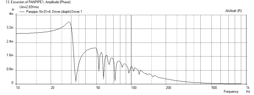

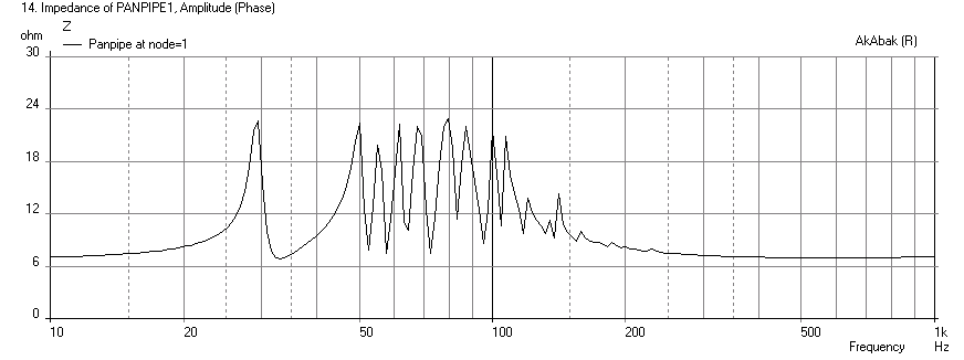

Update: I redid the sim with a smaller driver chamber volume (12 liters) and it seemed to improve the smoothness of the response somewhat. However, it would be fine to keep it the same as original plan allowing a driver upgrade should you ever want to do it.
I also have the driver displacement and impedance curves, and freq response with 12 liter chamber (last plot).

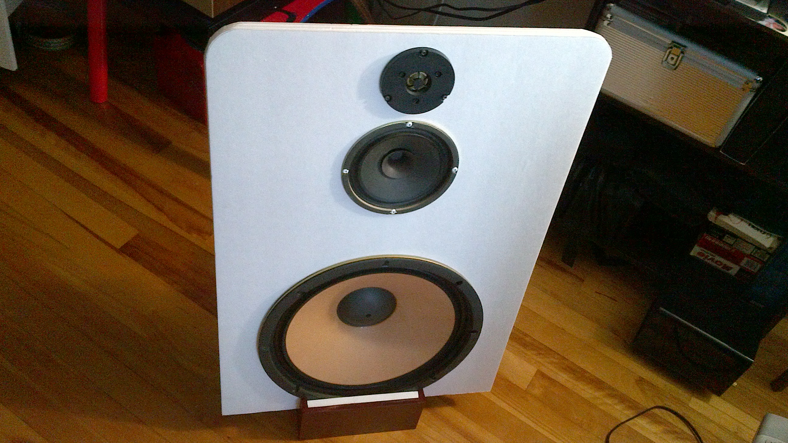

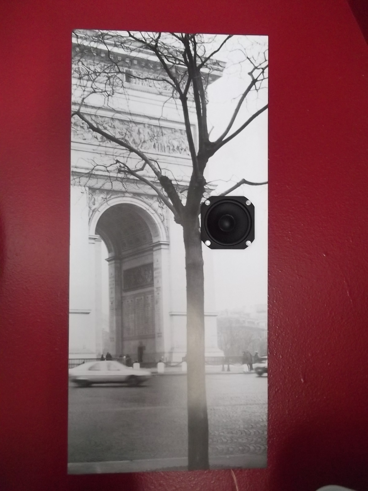

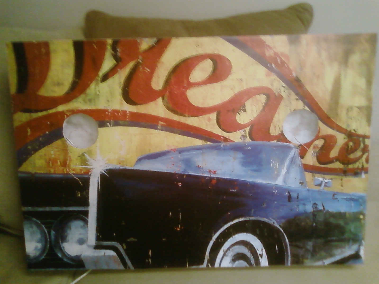

Excellent open baffles. I used a inexpensive prints to cover a couple of mine. Find something to suit your tastes at your local arts and crafts store. Then use some elmers spray glue to attach. Re cut your driver holes and you are finished.
I have though about that but leaving the drivers expose to little four years old is a no-no. I want to know if something I could use to add a little stiffness to the baffle so I could make a grill to cover all the drivers.

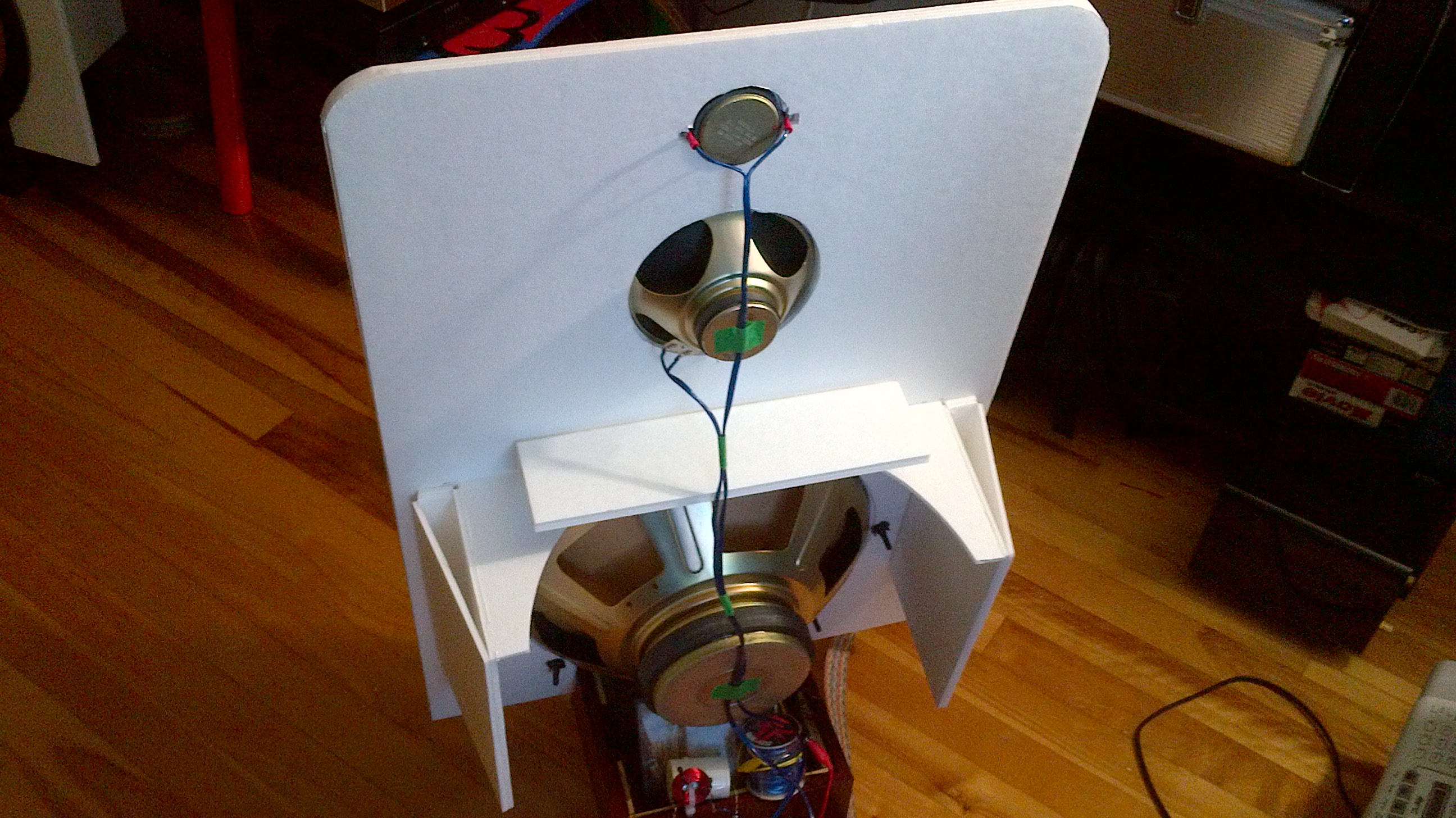

I gotta tell you after listening to my OB on foam core sheet baffle, I am not going to put it back on the 2" ply baffle again....
I might try to make the baffle grill out of foam core as well and reinforce the foam baffle with a thin wood frame on the back. What do you think?
