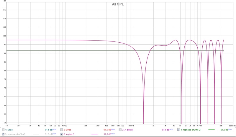

The plots you see here paint a picture of deep dips. But you've got to remember our head is in the middle of those two wave fronts. So the first wave to hit the ears will be the left and right signal hitting the left and right ear and the dips will be caused by the sound that hits the other ear about ~0.270 - 0.290 ms later (left signal hitting right ear and right signal hitting left ear that cancels with the direct wave front with that time difference between them). No doubt the signal traveling around the head is a bit lower in SPL than that first wave front due to head shading. The biggest problem will be the ~2 KHz signal creating the largest dip. By adjusting the phase angle (gradually shifting) those sounds will no longer completely cancel each other, though they probably won't sum ideally either.
We might be able to sim that as well to see how it looks.
All it would take is summing 2 sweeps with the same ~0.270 - 0.290 ms timing difference after first applying the left phase shuffler to the first and the right phase shuffler to the second one. The result of that should show the theoretical difference.
Right? Or did I miss anything...
At the mic spot, without a head and both signals being in perfect phase you should get a perfect sum as there is no time difference. Move one inch to the side and combing starts as you will have introduced a timing difference between left and right.
Sitting in the sweet spot with a matrass in front of your face should cancel those dips as well I guess.

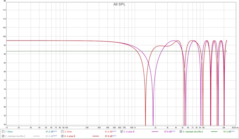

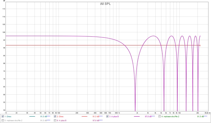

I should have figured that out sooner, here's a dirac pulse summed with a 270 ms difference:
attachment.php
Here's Pano's RePhase shuffle-2 summed at 270 ms difference:
attachment.php
The two compared:
attachment.php
Does this help us create a better recipe? Interesting what that extra shuffle at ~3.7 KHz does for the signal, is that why I like it so much? There are still dips, but they moved around a bit. That extra wiggle creates a wider flat spot though... hmmm... interesting 🙂

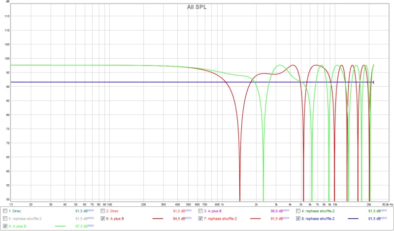

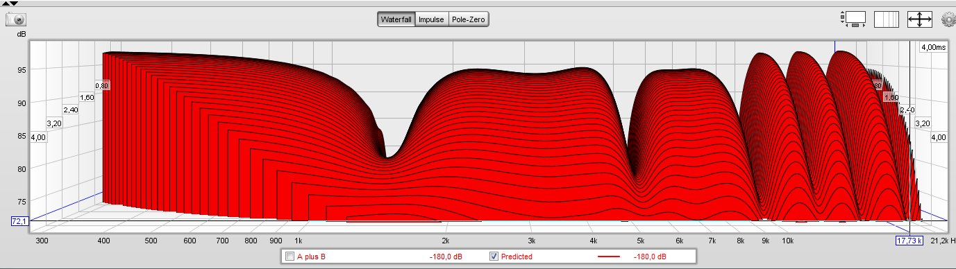

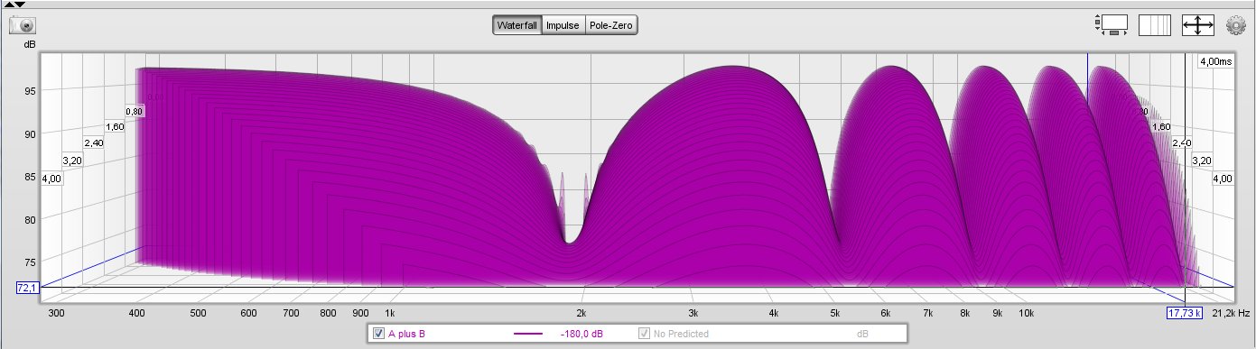

Here's the Dirac with 0.270 ms difference plot:
attachment.php
Which made me cut at 3700 Hz, Q = 2.7, Gain = -1.4 and 7270 Hz, Q = 2.7, Gain = -1.
And here is RePhase Shuffle-2 with 2 cuts:
attachment.php
Cut at 4270 Hz, Q = 2, Gain = -2.6 plus 6900 Hz, Q = 2, Gain = -3.1
Remember, this is happening after hearing the original wave front, after that 0.27 ms time difference has passed. This tweak might still benefit from a slight boost of the center channel compared to the sides between 2 and 10 KHz.
What do you guys think? I did try and better the shuffler but as the peaks move closer together I wasn't successful to do it yet without adjusting Q (which I didn't want to do).

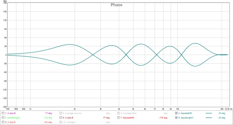

Scrap my above comments as I just simulated what happens at the other ear (by shifting the other signal 0.270 ms). It shows a different plot:
attachment.php

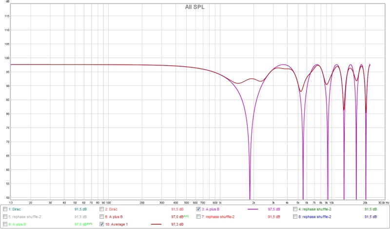

It also shows us the average of those two plots will have a better potential than getting to hear the dirac in left and right ear, as there will be no change between the plots there.
The phase shuffler does work (remarkably well for a "shot in the dark") to fill in dips at the center when we look at the combined result.
You either get 2x the dirac or the more equally summing phase shifted plots.

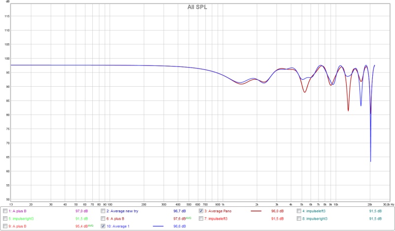

If we average the shuffler and compare it to the dirac we see this:
attachment.php
Probably why it will sound a bit brighter and retain more detail.
