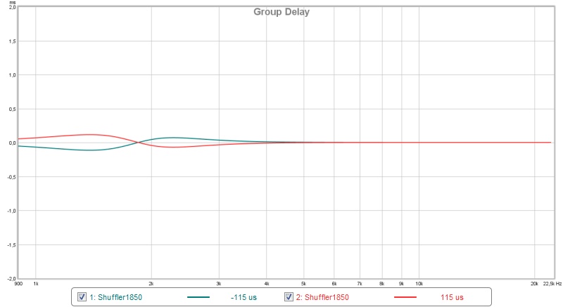

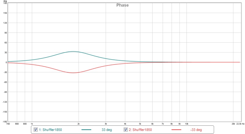

I just tried the single shuffle at 1850. It does fix a lot. It might be enough to only keep that one. The time penalty is very small too. I probably will try fixing 5500 too though. I can't help it, it's in my nature to be curious. If I do, I'll use a smaller phase swing there.
Maximum time delay/advance for a single channel is 0.115 ms @ 1375 Hz.
Phase spread between left/right channels 66 degree @ 1850 Hz

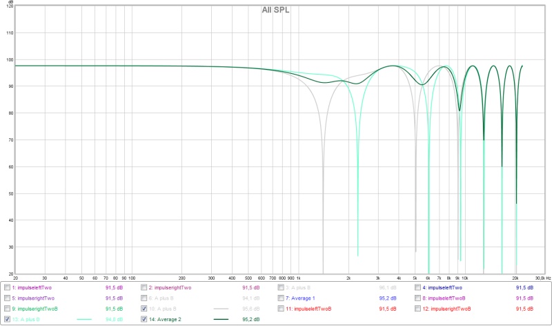

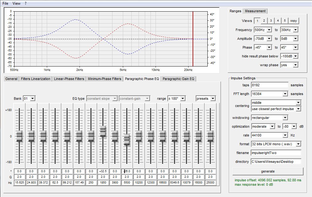

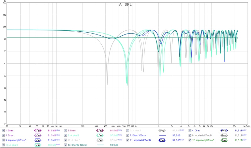

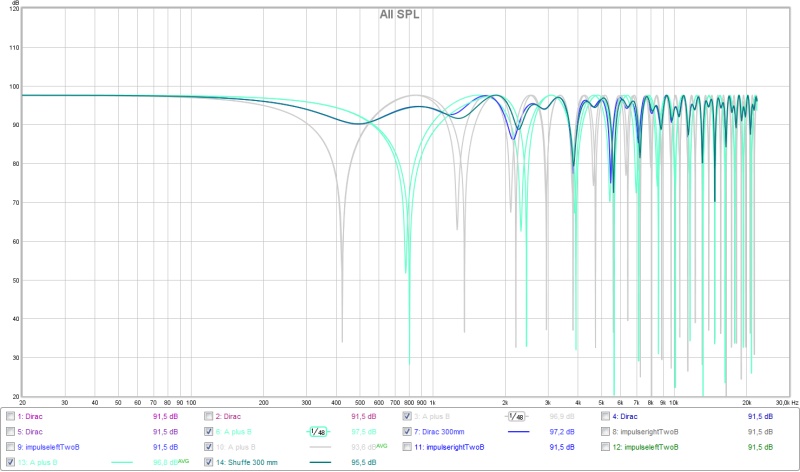

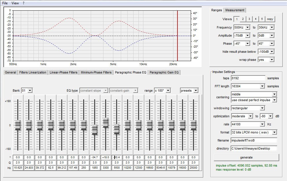

Let me explain what I mean in a couple of graphs.
First I created a shuffler with alternating bumps at 1850 Hz and 5500 Hz. It looks like this in RePhase:

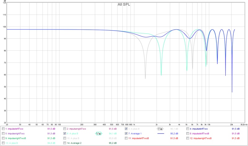

When you look at how the frequencies combine you get this:
Notice in the light grey and cyan traces how the frequencies get an uneven distribution? One channel is pulling way more weight than the other. The combined average looks very good though.
Next I made another shuffler, but this time without alternating sides.
Again as viewed in RePhase:
Both phase deviations one side only. Opposite direction for the other one.
Combining that one looks like this:
See how each channel is now contributing more evenly to the shared average?
The end results viewed as average are quite identical:
Yet I'm willing to bet one of them works way better than the other when listening.
We create the averages in our head. Without our brain processing this information we end up with the same shape as the Dirac comb average shown earlier. But out of these two examples, one of them makes it way harder on the brain to make sense of the presented data, if you ask me.

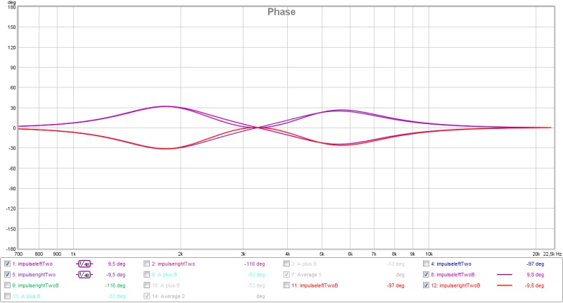

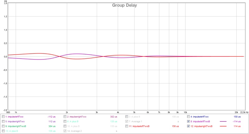

To finish this up here's the phase plot of both shufflers:

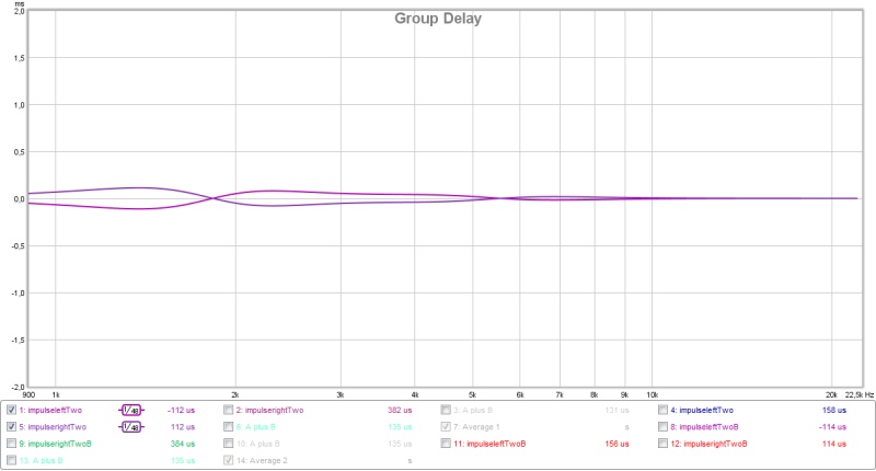

Group delay of the first (alternating bump) shuffler:
0.112 ms delay max
Group delay of the second (same side bump) shuffler:
0.114 ms delay max
Even the group delay plot shows more pulling the image to one side on the alternating side shuffler. I.m.h.o. not a good way to go.
Hope this helps clear up what I meant. I may take a shot at trying to add subtract one of the shufflers and compare it to a normal situation without shufflers at an off axis point. Once I figure out what's happening there, that is... 😀
0.112 ms delay max
0.114 ms delay max

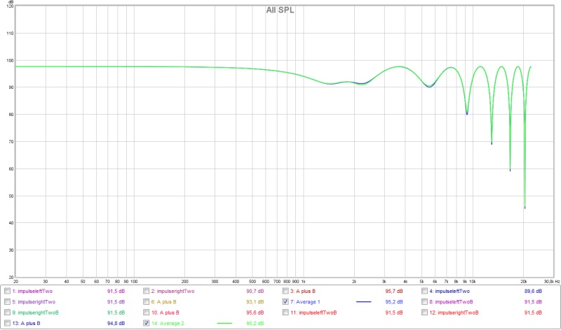

Still learning and still thinking here, but I've compared 2 off-axis plots, one without shuffle and one with to see if moving off axis was causing more trouble than the shuffler fixes.
I've moved my virtual head position (based on my own setup distances of which I have made a drawing to help figure this stuff out) 30 cm to one side.
The plots look like this:
Small change between them in favor of the non shuffled result, nothing big though.
Let's move the head the other way:
This time the superiority of the non shuffled result is gone. Still no large deviations to indicate this shuffler would be particularly bad off axis. It might favor one side over the other as one side is leading by a very small amount and the other side is trailing.
I've also looked at frequency dependent windowed plots indicating that it will not help much to shuffle the higher frequencies. Something we thought might be the case earlier on in this thread.
As this shuffler is only shifting dips over a small area I don't see any indication it would be devastating to the perception of the stereo image at any point. Different? Yes, especially in the sweet spot. but the more I think about it the more I'm sure it isn't even capable of creating any new peaks or dips by itself.
It could possibly enhance something that was off to begin with.
In other words I haven't found any real problem yet that indicates it would make things worse or that it would be a bad thing to do.
It most probably won't create new content that shouldn't be there. It could however highlight over compensation in a mix that tried to brighten the center with EQ for instance.
Any thoughts?

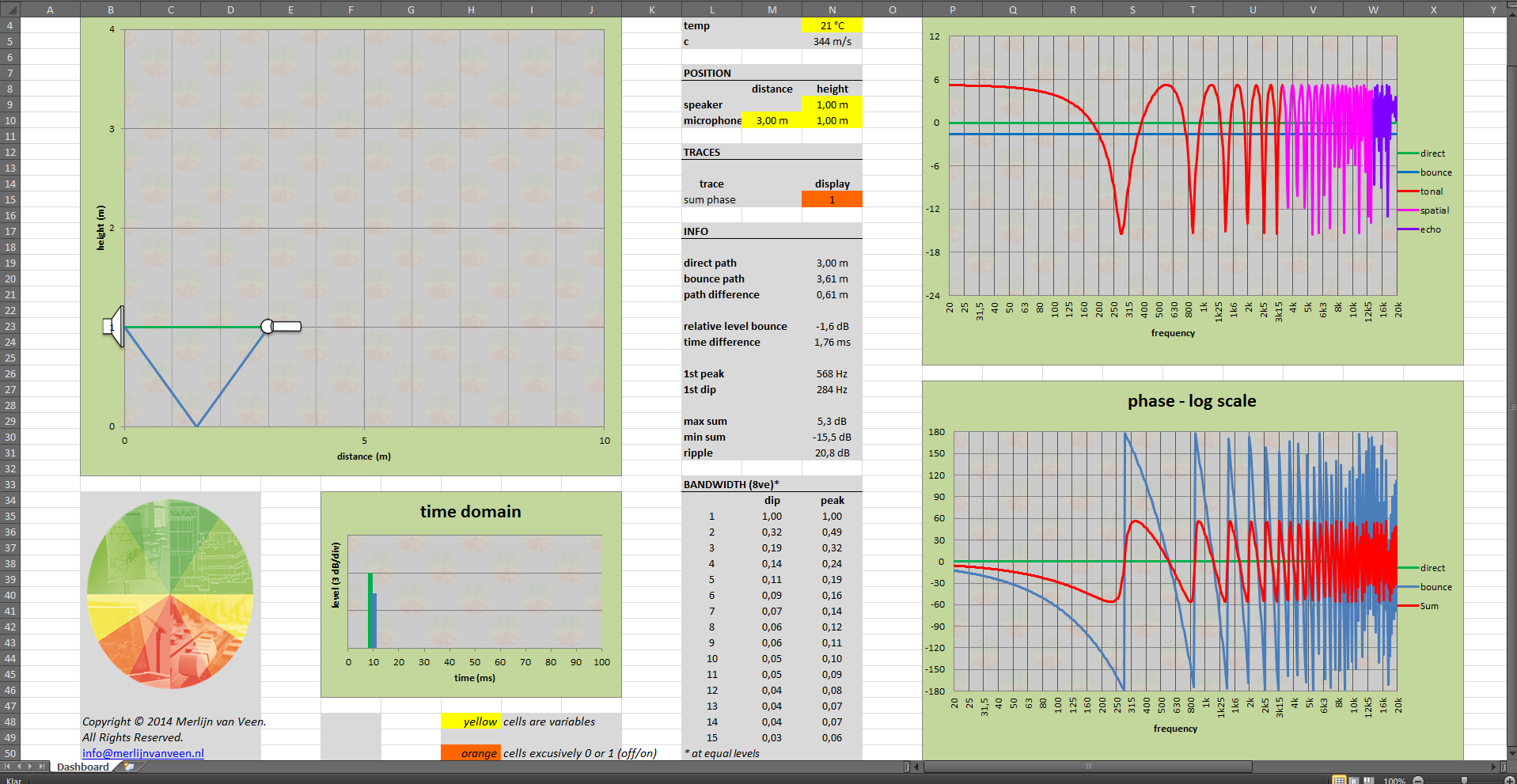

.....Any thoughts?

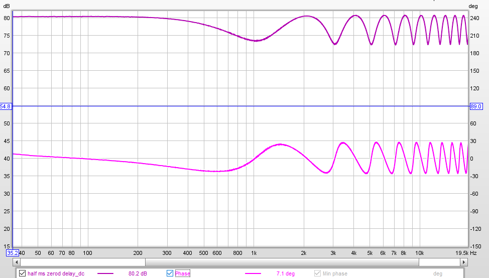

Not other than joking about floor bounce problem (first picture) looks some familiar in comb filter error to phantom center HRTF error, can a filter improve in this area too 😛
Back on subject again second picture is more related here in show one wave period green and blue that sum to red trace and have phase stepped in 10º steps from 0-70º which seem be most phase apart used in shuffle filter. Sum (red) do change in amplitude and do move timing but relative low before more than 40º change.
I don't know what that is... floor bounce 😀
Yes, the change between about 27 degree and 34 degree was about 1.5 dB. I've shown it as a possible solution to limit any time and phase changes. The current time difference is 114 us compared to 147 us for the original RePhase Shuffle-2. Bringing the phase angle down will soften the effects but it will still be miles ahead of that dip (relatively speaking) than the Dirac comb pulse showed. (it won't be a perceived 1.5 dB difference, way less than that)
That part will be the fine tuning if and when this experiment gets the "approved" stamp. Not there yet! 🙂

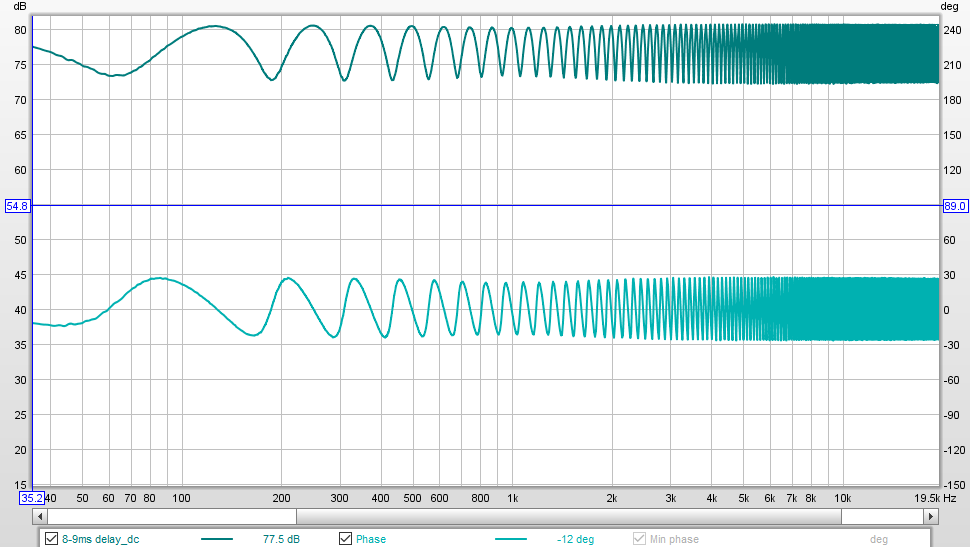

OK I'll bite. I tried this and it turned out about like I expected. I followed your directions exactly by the way - EQ, delay, mid channel only, -6dB blend. Both 0.5ms and 8.5ms. Same polarity.
Both narrowed the image putting more weight in the center (since its adding mid channel, this is what I expected). The 8.5ms delay dramatically thinned out the bass (due to the comb filter) and created a very obvious and nasty "chorus" effect (due to the delay itself). The 0.5ms delay was less noticeable although it still added center weight, perceptually darkening the center since the comb filtering started higher up. Not as much "chorus" effect but still a blurred / smeared treble.
This latter effect of the 0.5ms delay actually made me think about my corner line arrays and why the treble sounds "off". It could be the reflection under 1ms from the corners. Absorbtion right at the corners may solve this. (Will follow up on this discussion in my line array thread)
I have attached some graphs of what the two delays are doing to the frequency and phase response. And here are some samples processed with the delays:
https://www.dropbox.com/s/n9663g3db53ssld/half ms delay demo.wav?dl=1
https://www.dropbox.com/s/ogcf6u2j6ywctd3/8-9ms delay demo.wav?dl=1
Original unprocessed tracks are in this folder with the other shuffler comparisons:
https://www.dropbox.com/sh/p2eww8mm4kxl4rf/AABwdEsCWT19nk6e5jfl8o2La?dl=0
Thanks for the phase charts.
Looks like there is a phase shuffle going on in ZeroD's technique, too.
Thanks for the phase charts.Looks like there is a phase shuffle going on in ZeroD's technique, too.
no thats just for one channel actually, the mid channel. no symmetrical wiggles L/R.
