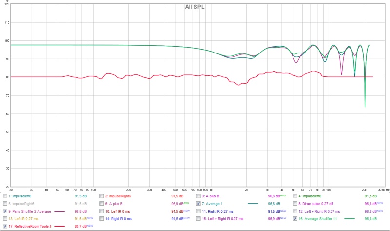

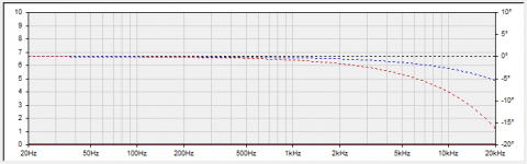

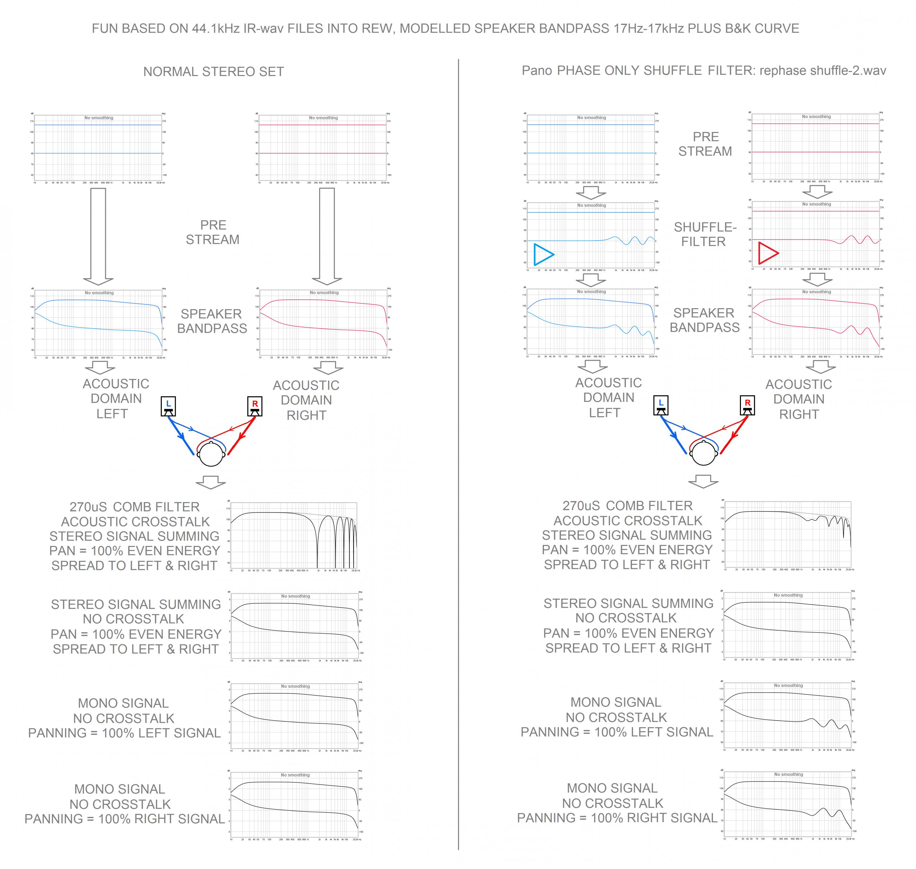

Fun from REW (based latest info what we think can happen) and this time model speaker with IRR system stopbands, picture 1 and 2 is same only resolution is difference, 1 is 50% scaled down version, 2 is full resolution if wish is study small numbers in plots.

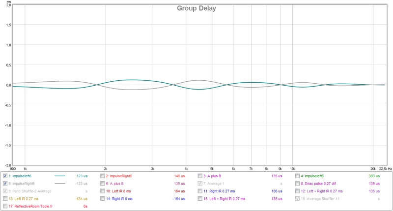

Here's the group delay over the shuffled area of interest:

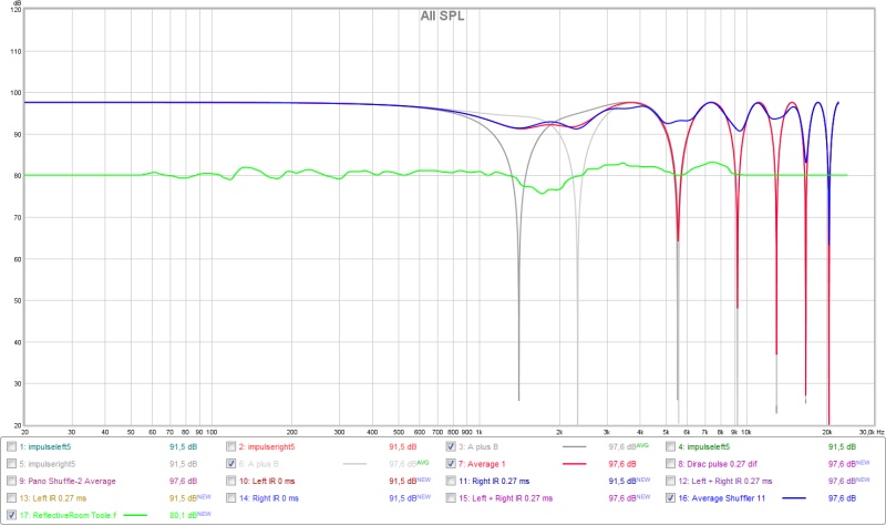

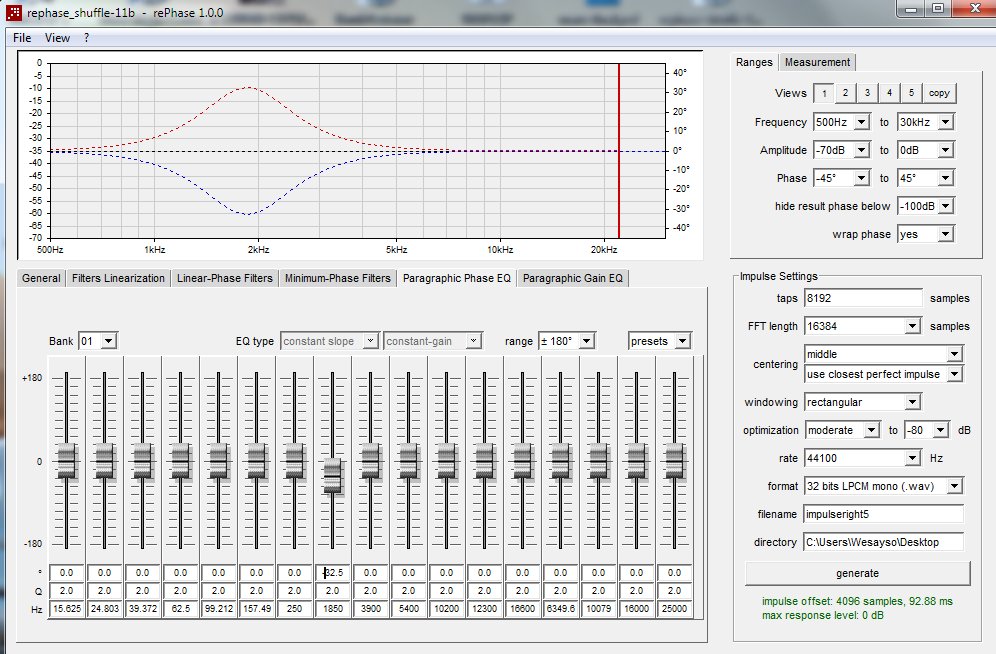

We still haven't fully explored less phase rotation. Here's one that swings ~27 degree @ 1850. About 1.5 dB difference at that 1850 Hz point in this 100% subtraction plot:
attachment.php
Real life the difference should be far less. Look how deep a Dirac pulse dip is.
The group delay plot gives less time deviation. (123 us instead of 148 us for Pano's and 164 us for my Shuffler11)
attachment.php

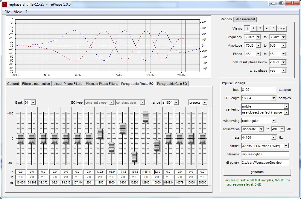

Rephase view:
attachment.php
Looks like a pretty good trade to me. Could be a good way to go.

Other thing that think can influence shuffler to be less of a problem at higher frq is speakers relative low bandwidth compared upstream device performce, HF transients influenced a phase turn already at -90º for a textbook tweeter with 20kHz BW2 roll off, where some amps reproduce fine square waves >100kHz area (zobel filter temporary disabled) speakers fade out in 5-6kHz area even B&W try hard with diamonds : )

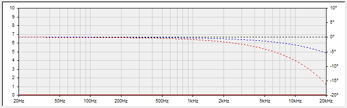

Even below examples is turning phase inside audio band window 20Hz-20kHz, we may hope for future tweeters can improve higher reach and maybe roll off a smoother BW1 verse BW2.

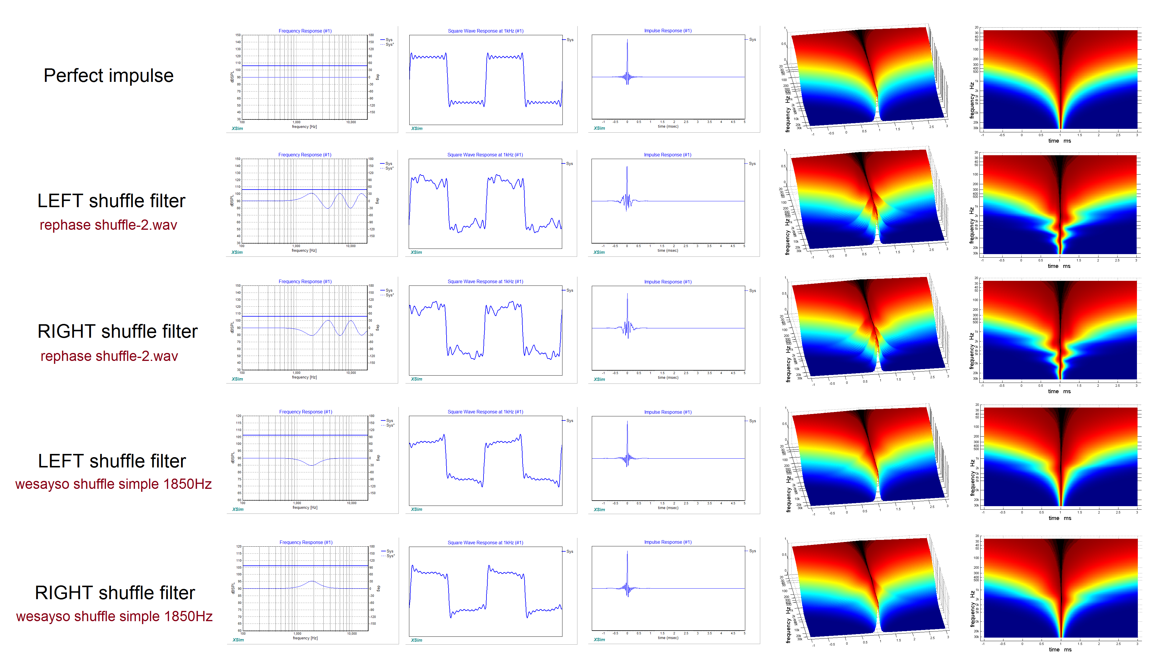

Should you wish create other sample rate than 44,1kHz settings file for "rephrase shuffle-2.wav" filter from Pano available at post 247.

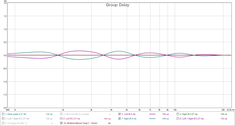

Below is timing graphs to compare perfect impulse verse rephrase shuffle-2 filter and the light 1850Hz version wesayso shared post 269.
