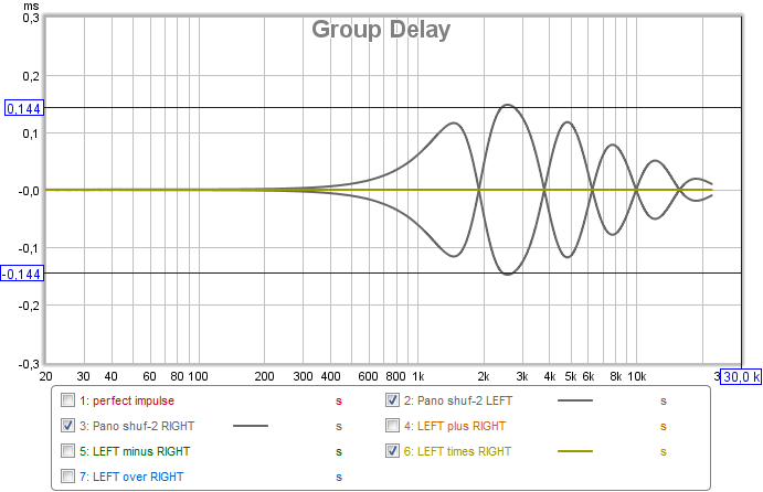

Is it so you want GD total shuffle correction to be flat +/-0,135mS to sum 0,27mS correction at all frq, that will need non flat phase correction in degrees. In below example two cursors is set close to that at ~0,28mS
Nah, I was trying to think on a bad day. The thing of importance was the signals that have the biggest phase spread. While I was trying to figure out the influence of group delay and how that sums at one's ear. At the nodes where the phase difference is zero, there is now a group delay difference. No idea what that does for the perception or summation yet. I could find out, but not today 🙂.
