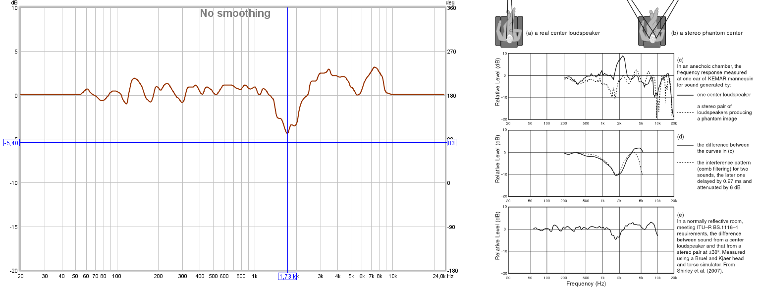

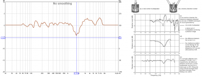

Mike, the more I'm looking at that graph that BYRTT traced, with the tiny examples next to it, the more I'm thinking of only compensating for 1.8 and 10.something...
Leave my EQ cuts at 3.7 and 7.3 (they are not big boosts anyway, 1.4 dB and 1.0 dB respectively) as that 5.4 dip doesn't even dip below the average. I'll compare that one with Pano's shuffle-2.
BYRTT, could you please send me that trace? I'd like to look at the peaks at 3.6 and 7.2. It's very close to what I've found on my own. Maybe I can optimize my cuts a bit.
It's the best shot so far for me, you have excellent hearing ...

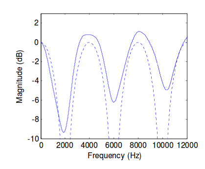

The Notches
Going back and looking at the original paper
http://www.sfxmachine.com/docs/FixingThePhantomCenter.pdf
see figure 1 (also attached below)
This shows where the notched will occur in the phantom center for speaker angles of +/- 30 degs. This is probably what I was targeting in my shuffle-2. The notch circa 2K is going to be very noticeable tonally, and the notch at 6K can reduce the quality of consonants in speech. For a stereo spread of 60 degs, those should be the target frequencies. We'd need to calculate the frequencies for other spreads.
How much phase shift is needed? I don't know. I've used +/- 30 degrees because that is what the impulse train gives us, so may be a good starting point. A good bit of testing will be needed to find how much phase shift if enough, at each frequency, to bring the tonal balance into line with a mono source.

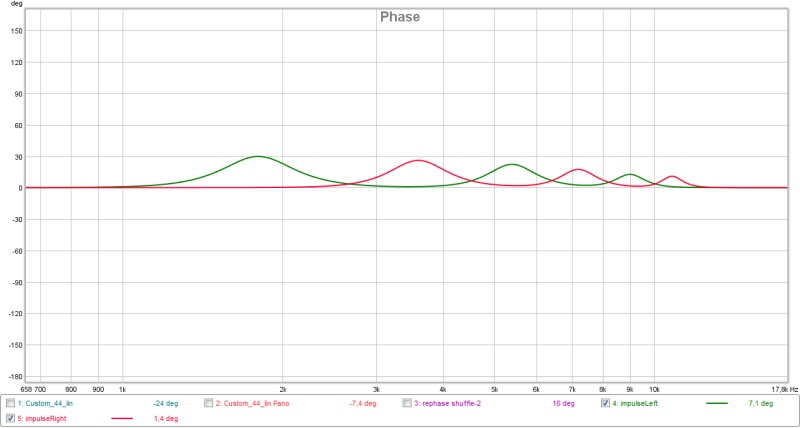

I noticed BYRTT used a Q of 2 for recreating Pano's shuffler. I was using more aggressive Q's than that until I noticed the actual phase plots. That Q=2 keeps a nice gradual flow, even in the group delay plot. By boosting close by side channels a bit you can make clean flowing deviations. I'm guessing that could also lead to differences in sound perception.

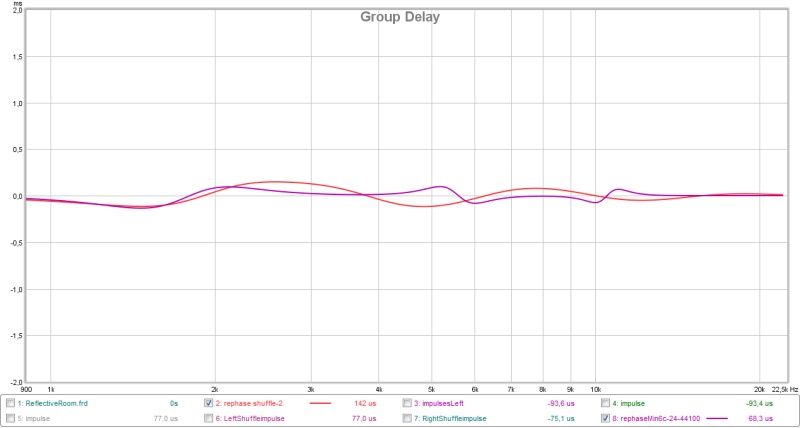

To clarify this look at the differences between Pano's rephrase-2 and Mike's 6C in a group delay plot:
This "might" explain my preference... (one can also see I'm addicted now, I've been playing a lot )

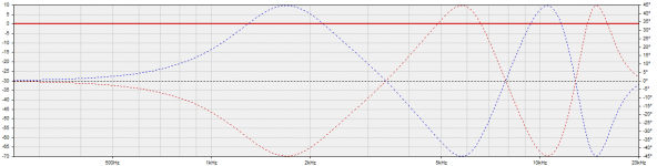

Based on that Toole plot I'm determined to try the 2 shuffles first at ~1.9 and ~10.7
an maybe add one later at what appears to me close to 16/17 KHz.
At first I thought to make the phase deviation smaller for higher frequencies. But there's no logic in that. As the phase will determine the difference in timing and it's already linked to that specific frequency. I'm sticking to 30 degree for now, based on Pano's excellent target shuffler.
Somehow it was more relaxing to listen to than the 6c from Mike. In fact I've spend most of the afternoon listening to all kinds of songs with Pano's shuffler.

I noticed the gradual movements. My new version, loosely based on Toole's plot and my own previous experiences matches your shuffler quite well, just no shuffling between 3 and 8 KHz for now. I'm just trying to get to listen to what does what. Mike might have a point that we wouldn't want to shuffle at 3.6 and 7.2 KHz. But then again, I might still try it at some point, but with more gradual shifts.
We are all targeting points close to each other. With the RePhase Shuffle-2 I moved side to side and front to back without troubles. It stayed locked in quite well. I also listened way off axis and noticed no ill effects.

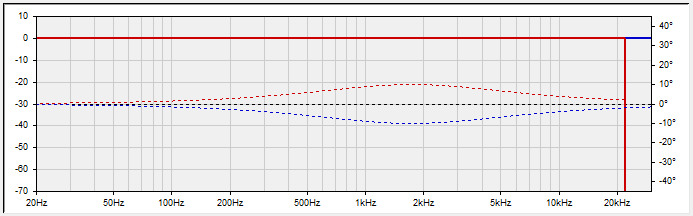

I made a smooth version that targets the dips and it is sounding good. Will post comparison files / comparison webapp so that more people can hear the differences.

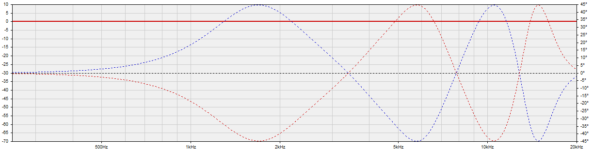

For now here is the latest and greatest filter... +- 45 at 2k,6k,10k,15k (roughly).
Sorry for filling the thread with IRs, but I learned something from each one and hope others did too.
Don't be sorry Mike, I appreciate it as a learning experience! I really think we are getting somewhere here and it's worth it to post the steps along the way.
This new one looks close to Pano's except for one less rotation, right? And the 45 degree shift of coarse. What Q did you use? This one looks smoother with less group delay even though the shift angle is bigger.
