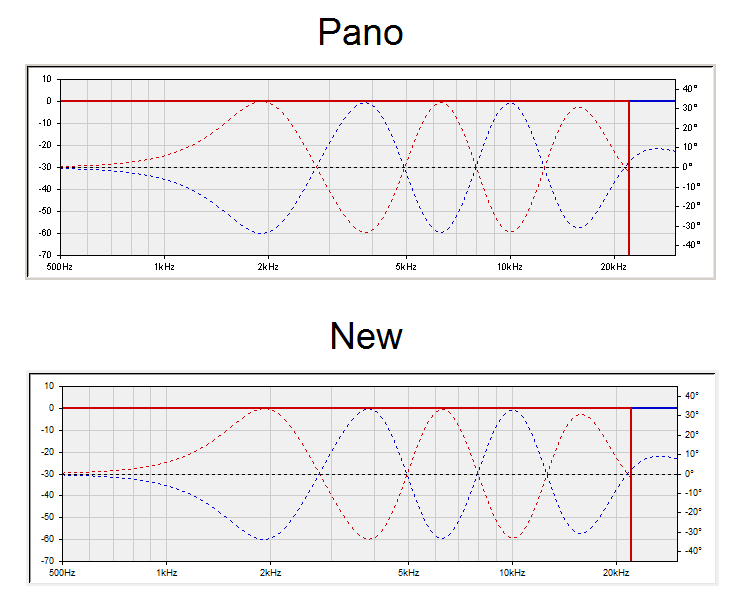

Settings file for Rephase attached below and it is created visual by comparing to Pano's posted graph, after that tried wav-file import to REW and exported as frd-file for import into Rephase to flatten phase and that way find numbers but result didn't get any closer than first try.

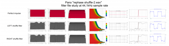

BYRTT, did you check in a loop how this shuffle looks in an early waterfall taken from a perfect signal? It's a tiny wiggle within 30 degree but it alternates in timing to left and right.
Thanks Brytt, I was not able to find my rePhase file. Looks like you got a perfect match.
The phase alternations were made to mimic the phase of the original multi-tap shuffler. Done by hand and by eye.
I exported a left and a right wave in 32 bit format, then combined them into a single 24 bit stereo file in a wave editor. Audacity will work for combining. You can leave them in 32 bit, it works fine in the JRiver convolver.

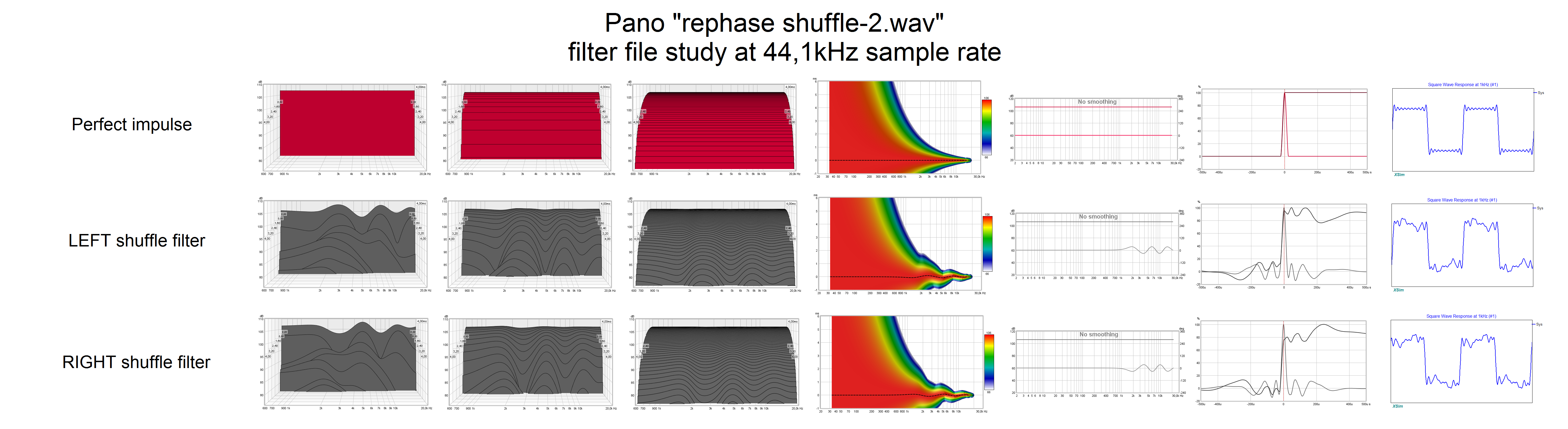

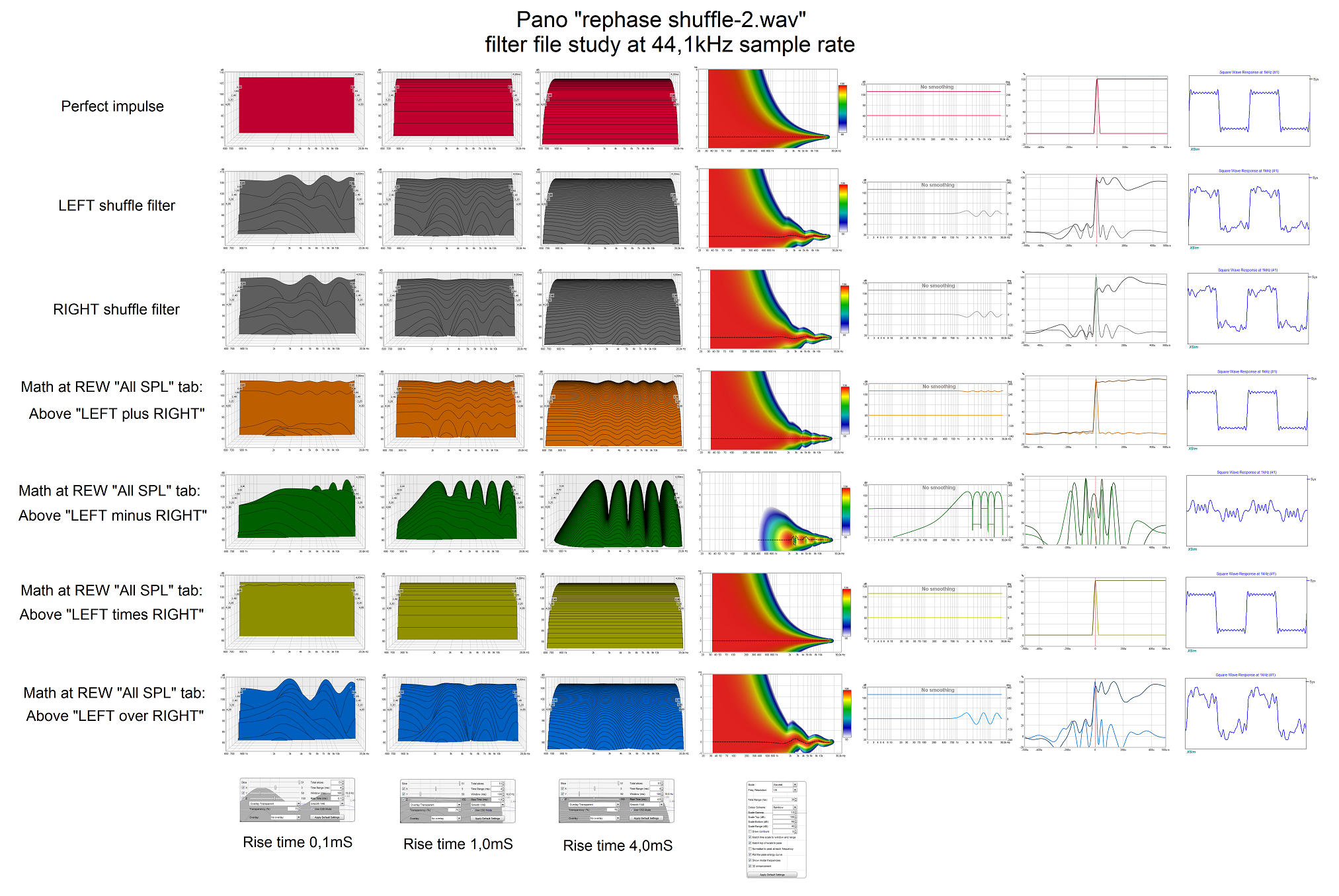

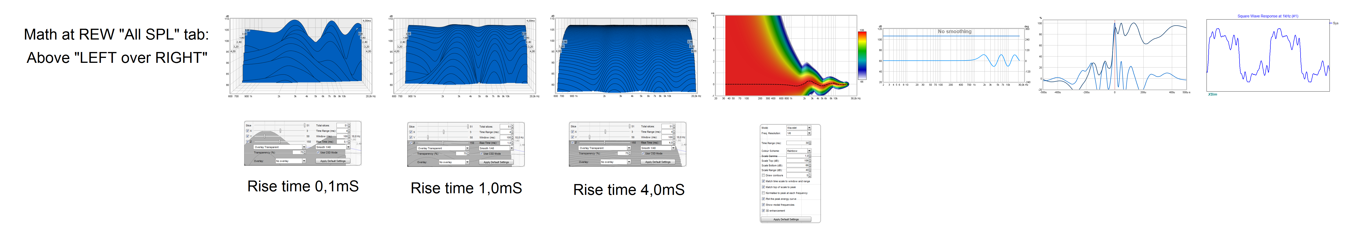

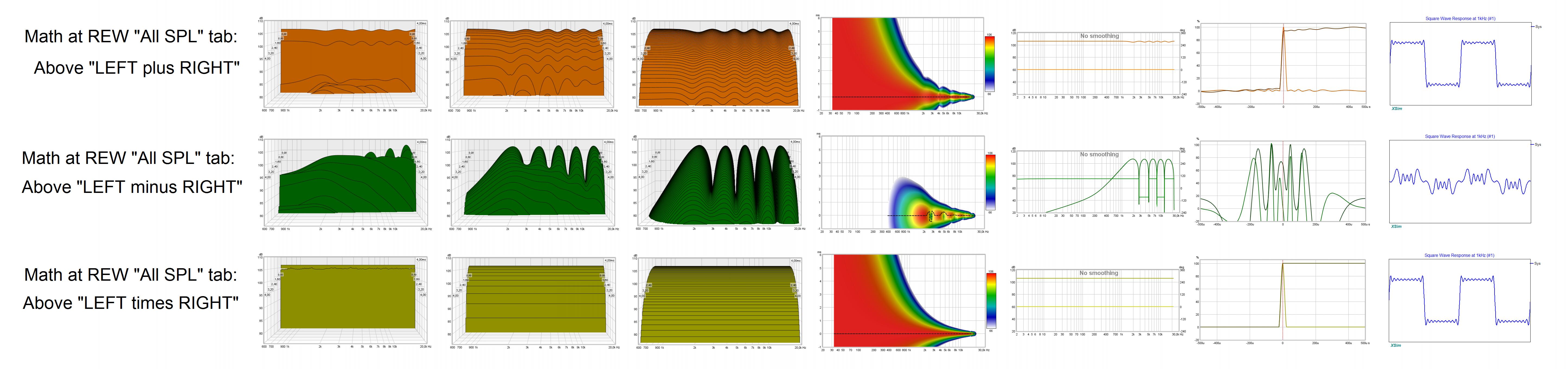

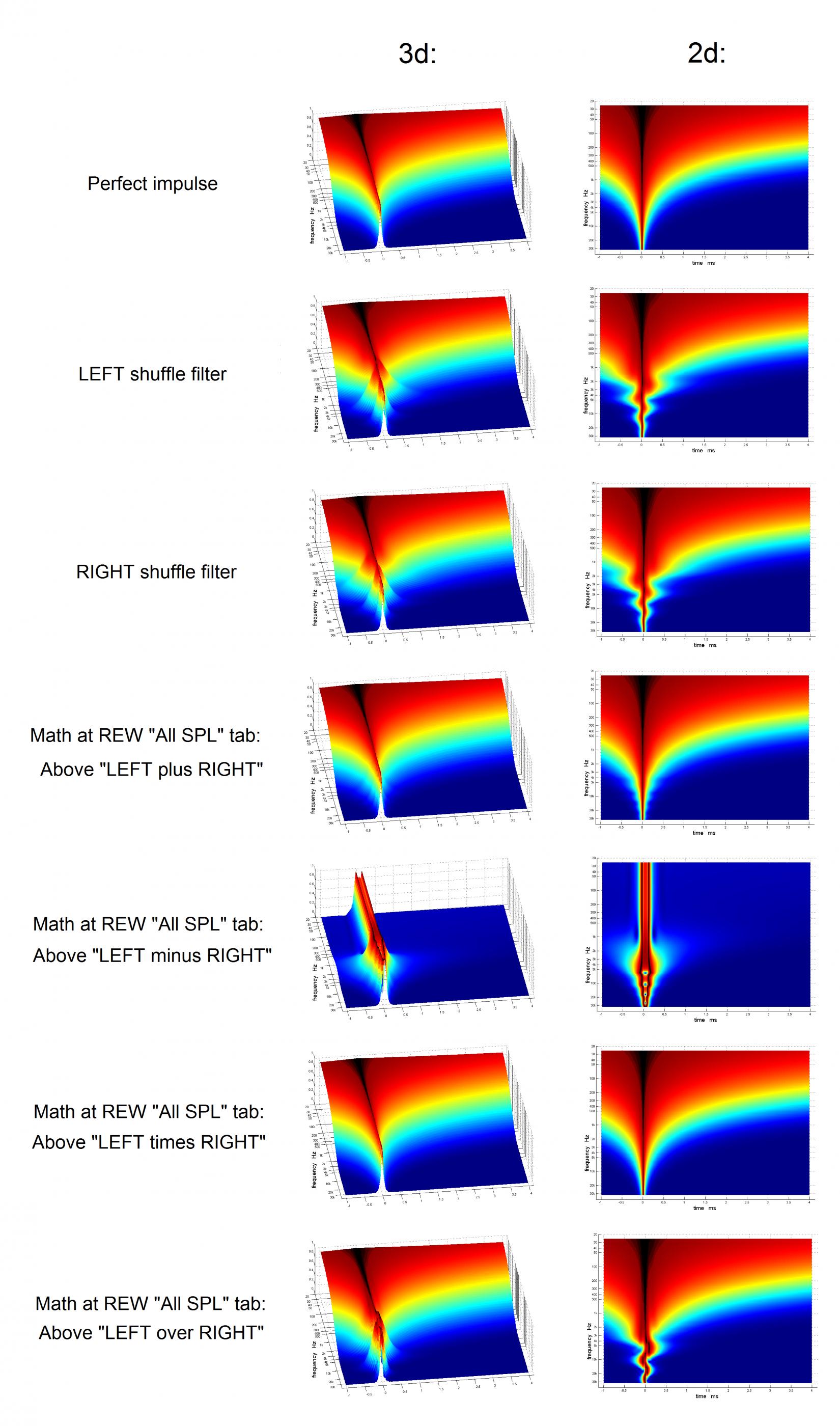

Thought i could spare some time running live soundcard SPDIF I/O loop that exactly gives perfect signal as you write verse soundcard analog loop I/O, in that we here have Pano's IR-wav file then think it's just let REW's math on "All SPL" tab do its magic : )
Most interesting result think is row five that show filter "LEFT times RIGHT" sum perfect if done in electric domain with no spacing as with real speakers and probably also at listening position in a symmetric listening environment, but in real world acoustic enviroment the other three "LEFT plus RIGHT"/"LEFT minus RIGHT"/"LEFT over RIGHT" can maybe sneak in a bit too not being at symmetrical listening position.
File size for graphs did grow therefor picture 1 is same as 2/3/4 the latter is meant to read small details.
APL_TDA is not bad as kind of alternative waterfall if setting time span from 0 to 5mS, it show visual both attack and decay ringing where in REW "Waterfall" tab only decay is visible and not what happens before first slice at time zero unless one looks into "GD" or "Spectrogram" tab. Below is what APL_TDA gets out of reading IR-wav files from previous post 258.
.....Most interesting result think is row five that show filter "LEFT times RIGHT".....
Quote myself because bummer in text post 258 😱 words "row five" is nonsense and should read row six.
