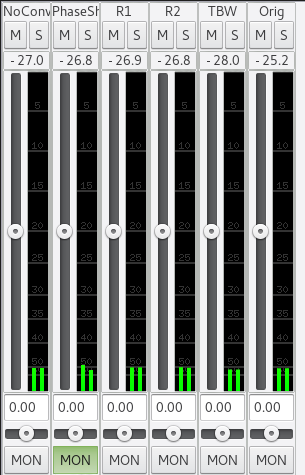

As it is about a 2 to 3 dB difference (between mid and side) at max it's smaller than a lot of variations due to room stuff in the left/right channel in a room without any treatment/care.
A picture of my left/right balance:
Well that certainly looks awesome wesayso, how did you make that measurement? Is it similar a bit off-axis? I know I know.. its all in your thread.
So you think my early reflections and/or channel matching are to blame for my perception of the phantom center? I thought these were known problems - the phantom center comb filter is quite location dependent (strongest when the speakers are exactly equidistant). . The early reflections are responsible for the changes as I make small movements, although studies show that they should actually be helpful?

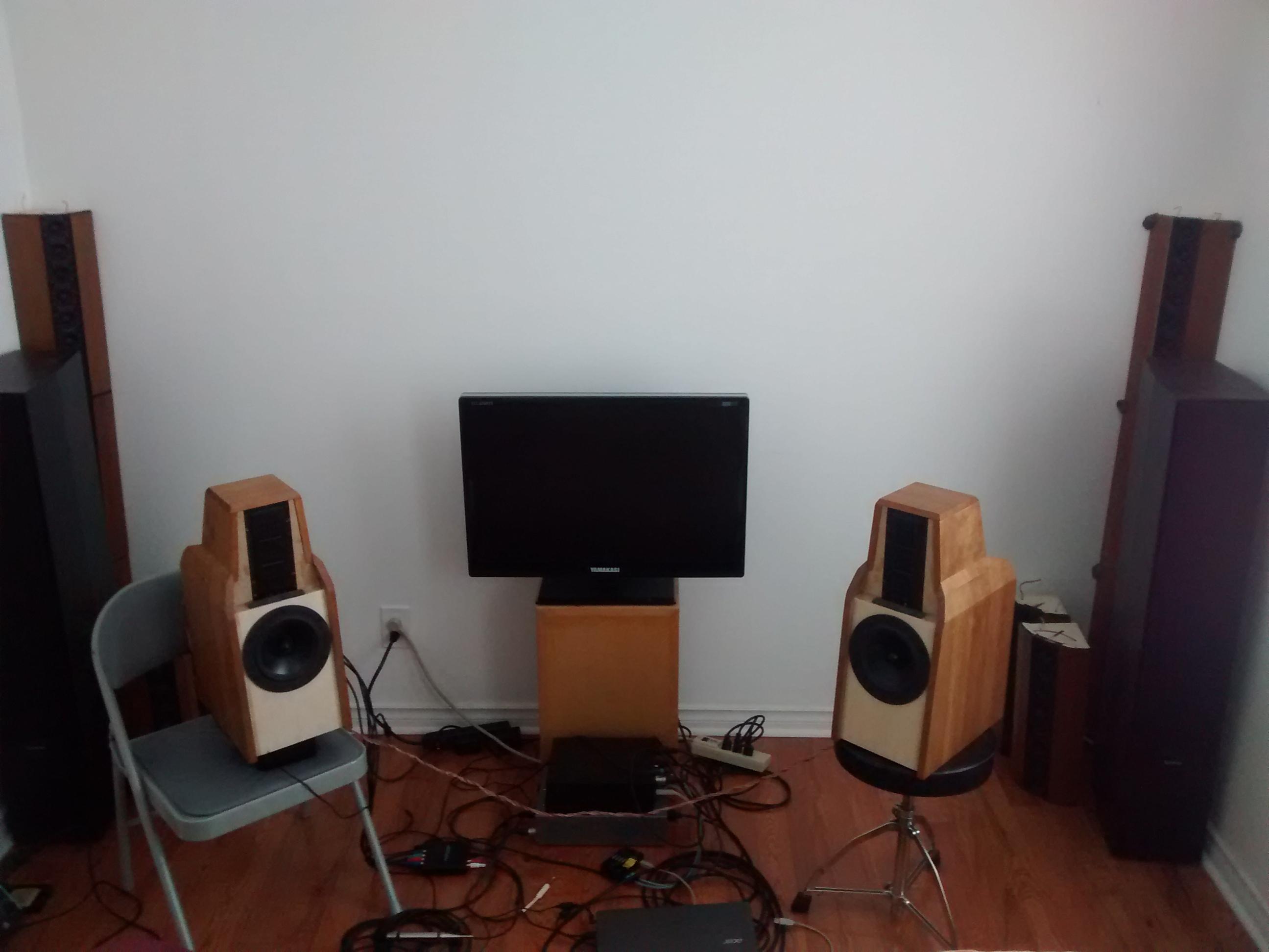

Bob, yes the phantom image is better with my corner line arrays than with conventional 2 or 3 ways placed away from the walls. In an untreated room mind you. I think the idea with the decorrelation techniques is that it isn't perceptible on a mono (L or R only) signal.

OK.. I've been listening to the various IR filters. Thanks for making the easier to find Pano!
I loaded up all the IRs in jconvolver and togged between them with jack_mixer. Without a lag between switches, it made it a lot easier. I was able to match levels that way too. (It was only the high pass version that needed boosting.)
I spent quite a few hours comparing, and I must say I'm very impressed with the Rephase-2 impulse. The imaging is often more natural with it on, then off. Mono mixes ("River Deep Mountain High", Beach Boys Smile Sessions) have a heightened sense of realism. Able to hear more details within mono elements.
Speaker setup used is pictured below. The Neo8 2-ways spaced about 80cm (ctc) and 80cm from each ear.
