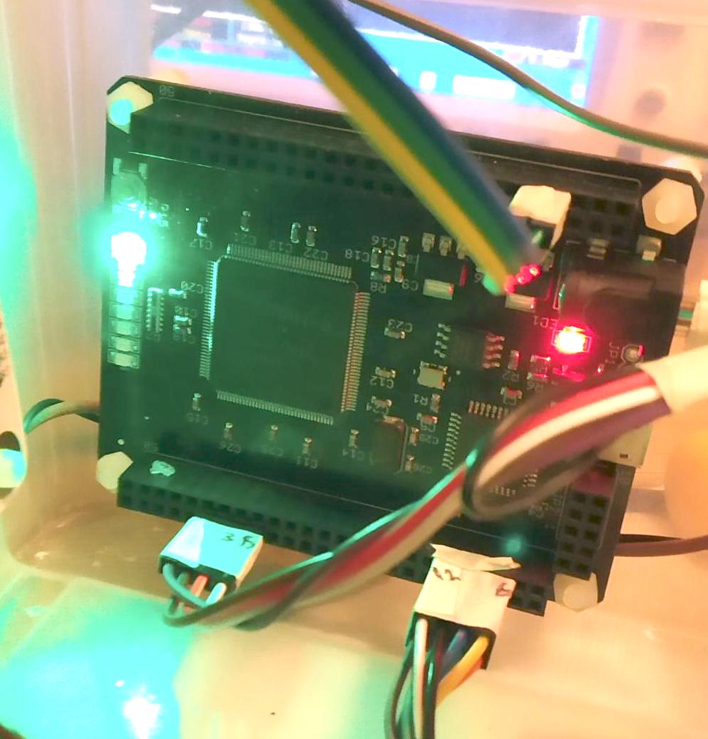

I'm not sure what you are strapping. The PCM4222 just provides either 5.6448 million six-bit samples per second or 6.144 million six-bit samples per second to the FPGA which, if it works, decimates that to 88.2 kHz or 96 kHz sample rate, 24 bit PCM.
OK. I was not sure about how it works... but maybe this is not in play if you tap the Modulator output. Maybe the only thing I need to care about is to activate the Modulator output and the all other straps are out of play... The Manual is not so clear about that but maybe it is obvious... 🙂
It is now that I ponder it. So activate Modulator and choose freq family - thats it on the EVM really.

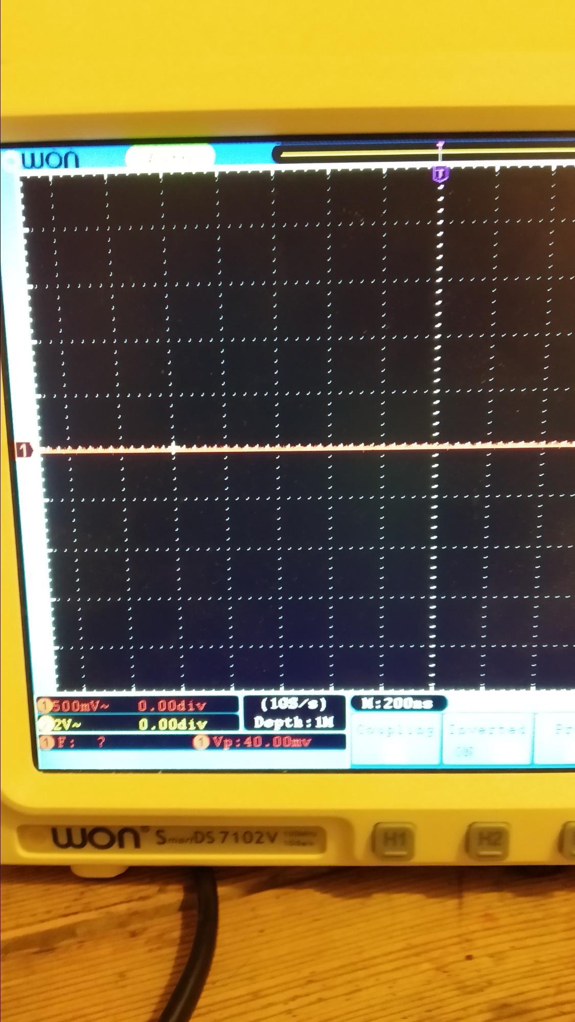

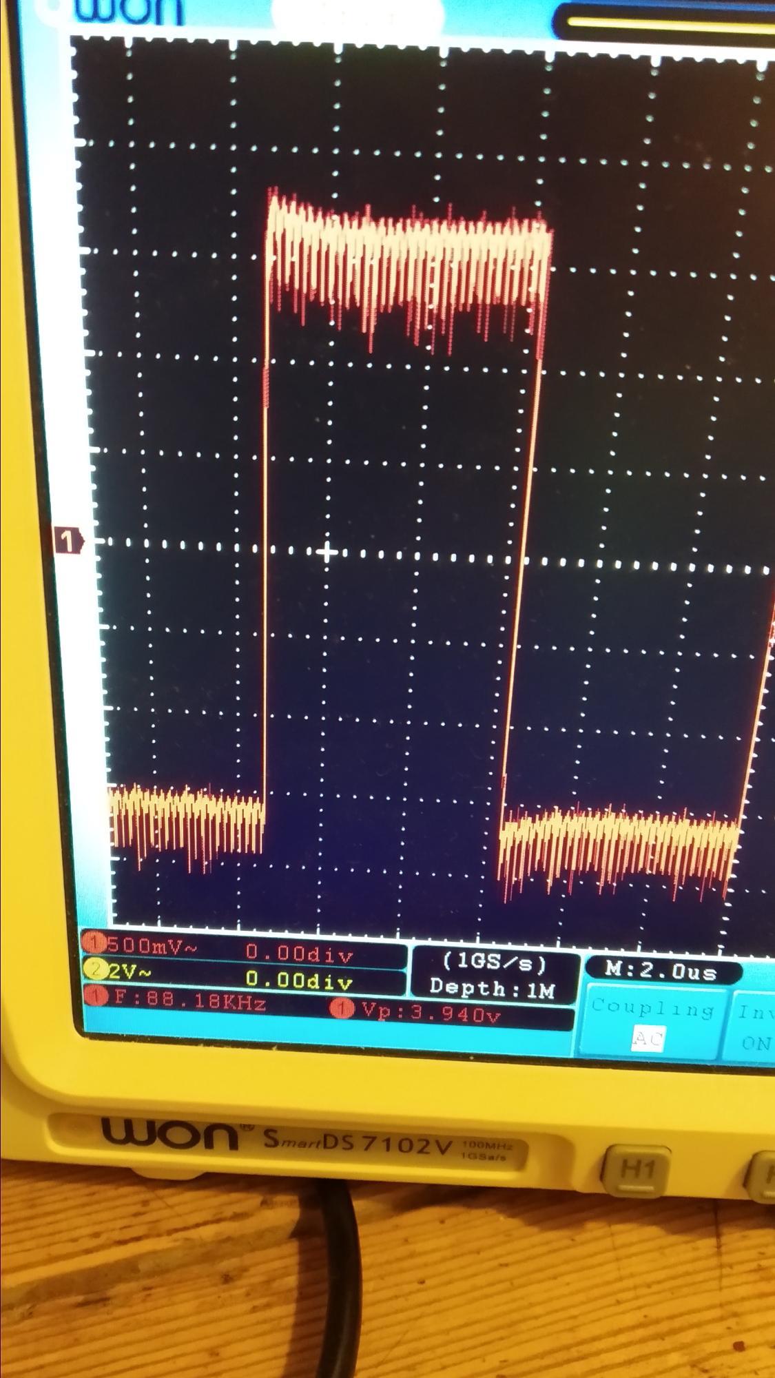

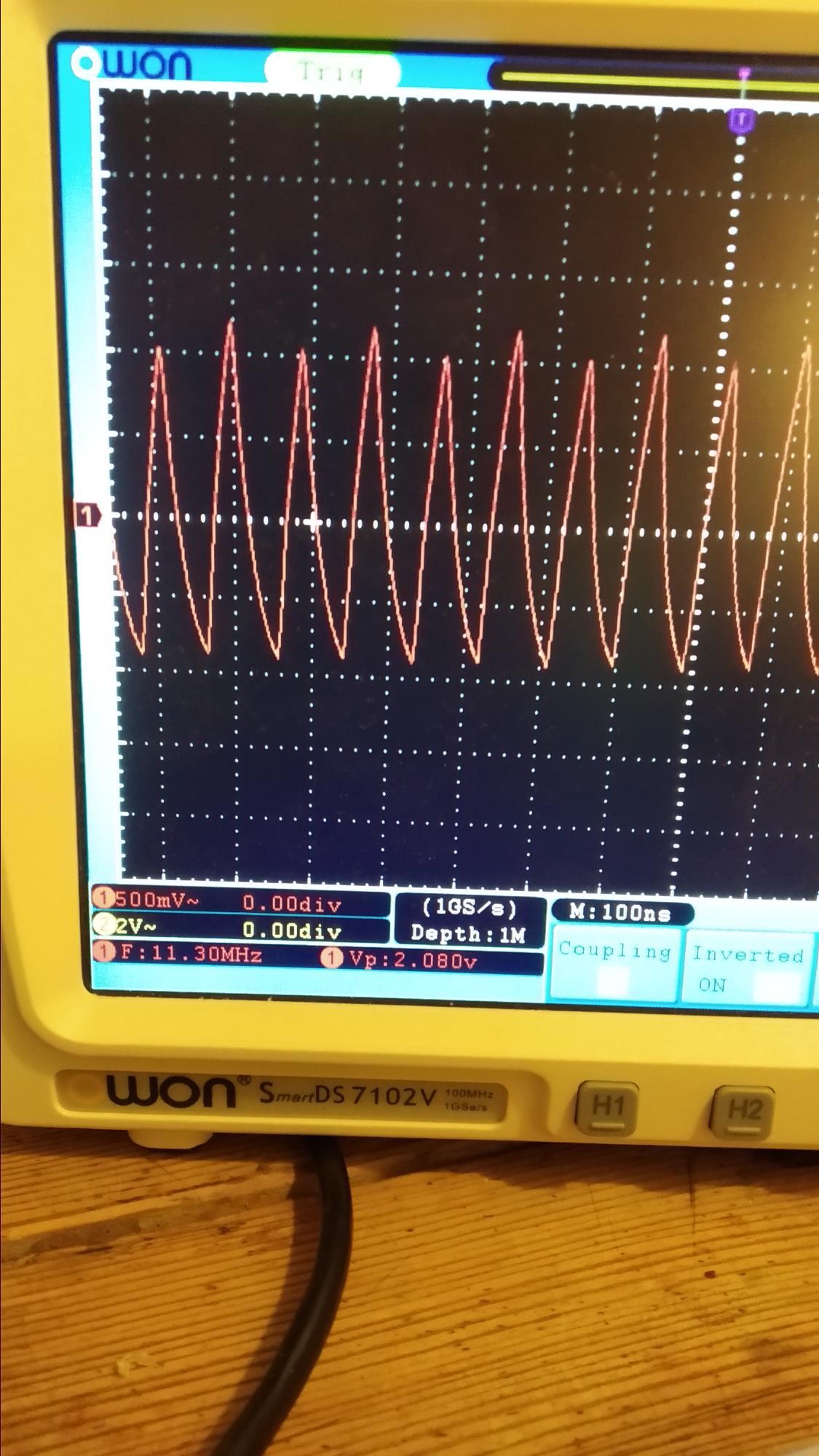

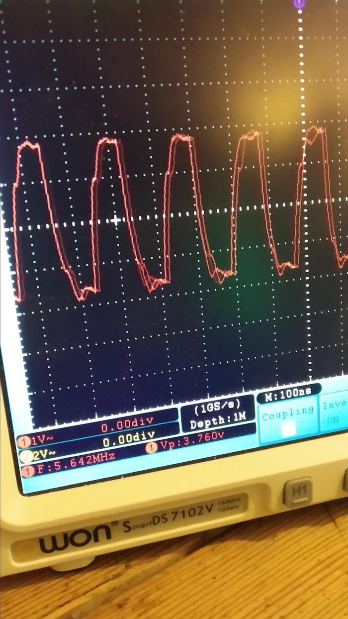

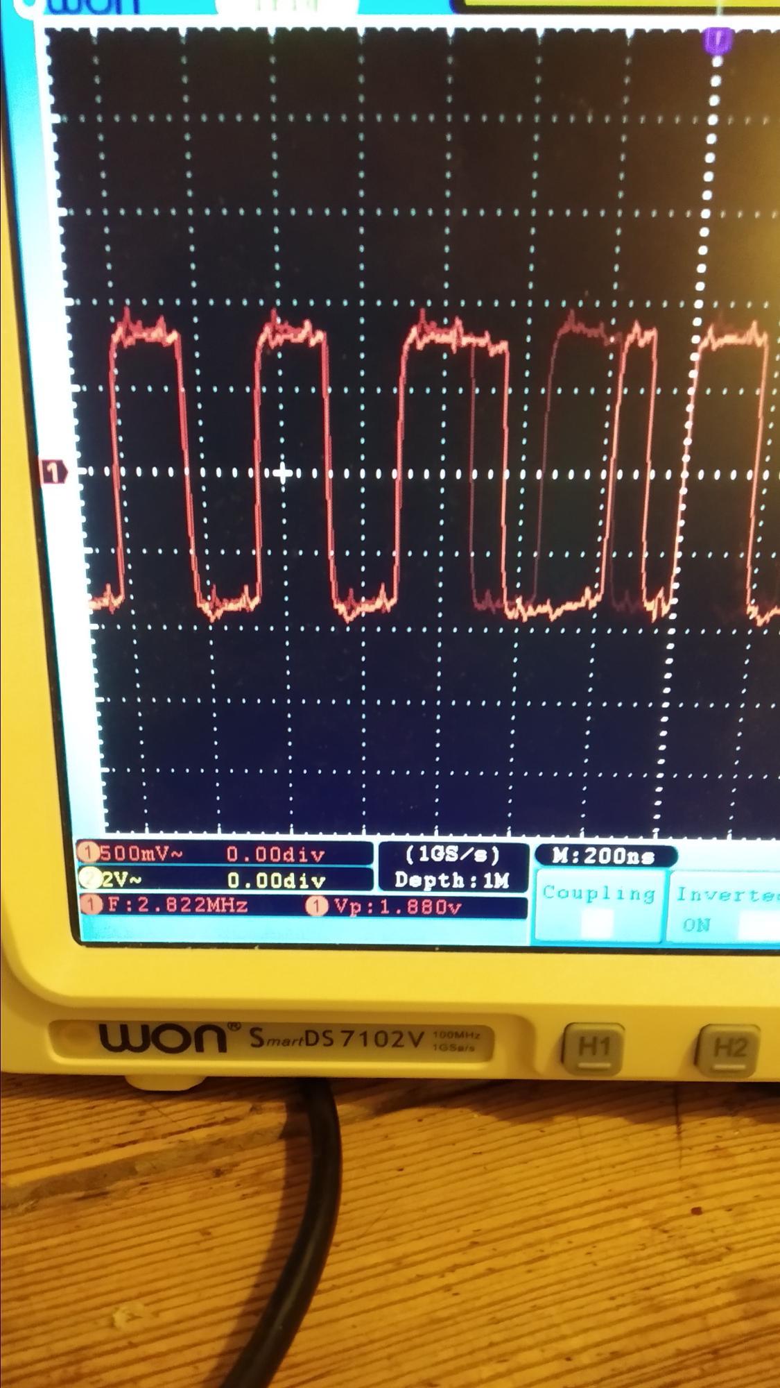

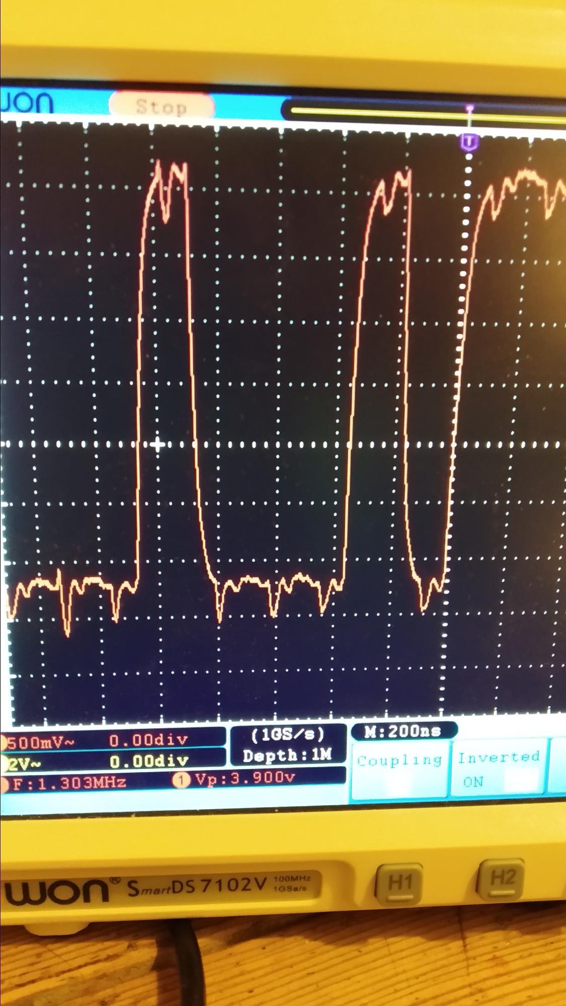

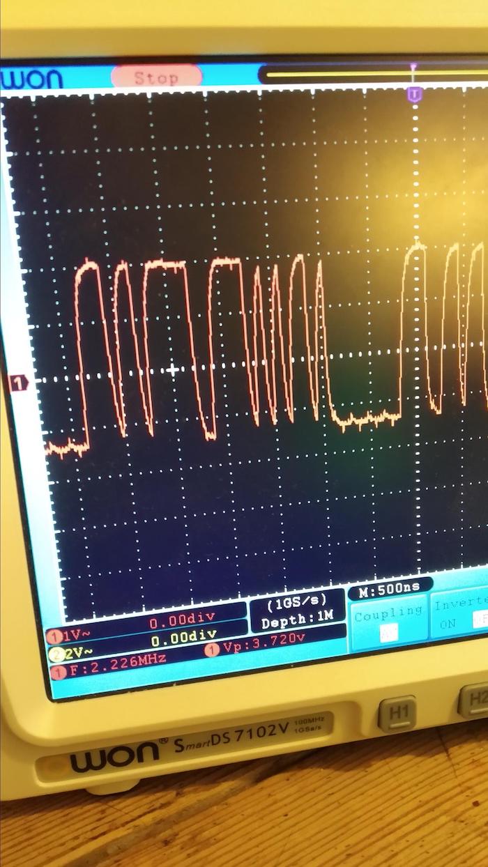

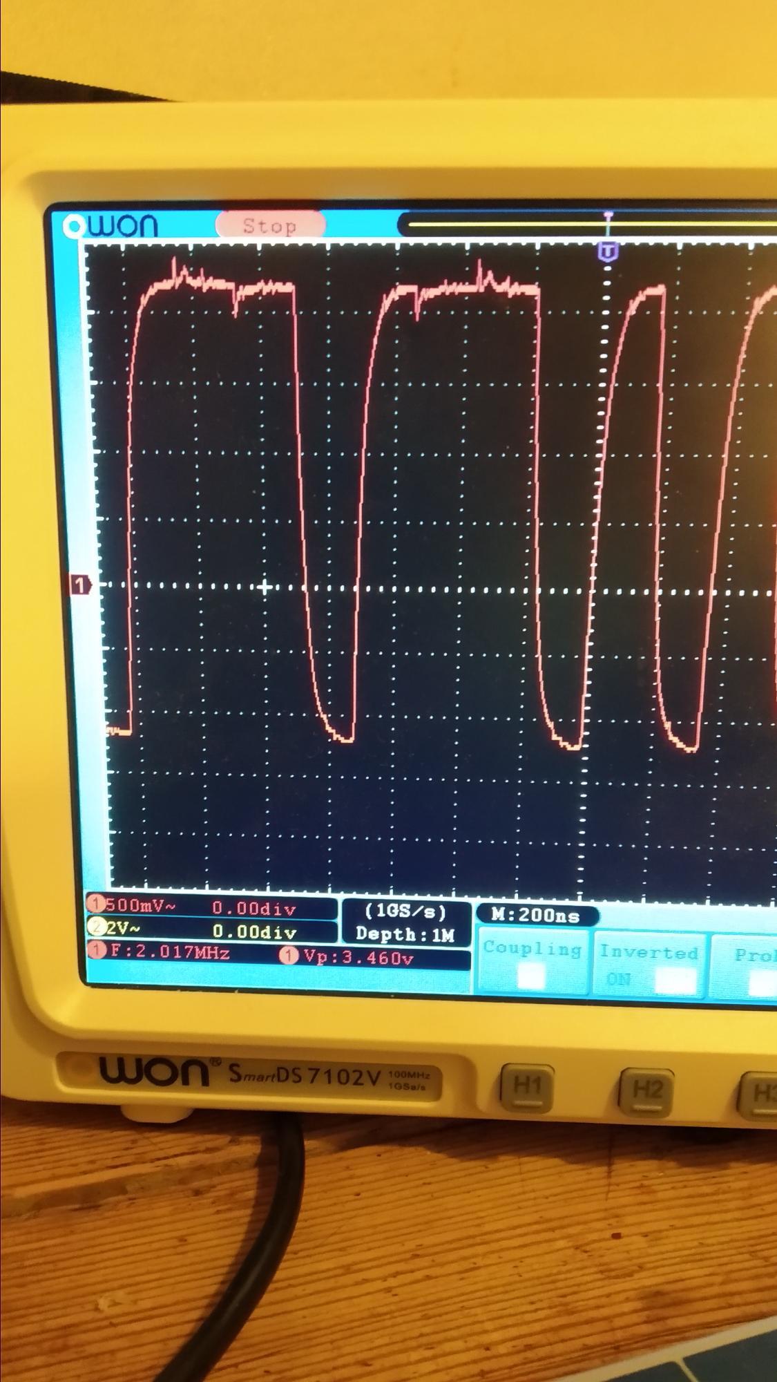

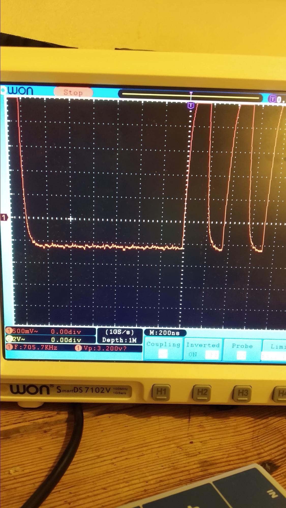

At it again... found a cabling issue but now fixed. Still no success... Here comes scope shots of the situation. Hover on attachments for descriptive file names...
Seem to be no i2s data coming out... checked connector numbering... seem OK...
Besides, the bit clock is quite irregular. I'll see if I can do some checks on my FPGA board, after all that's why you sent it to me. It won't be today, but hopefully still this week.
