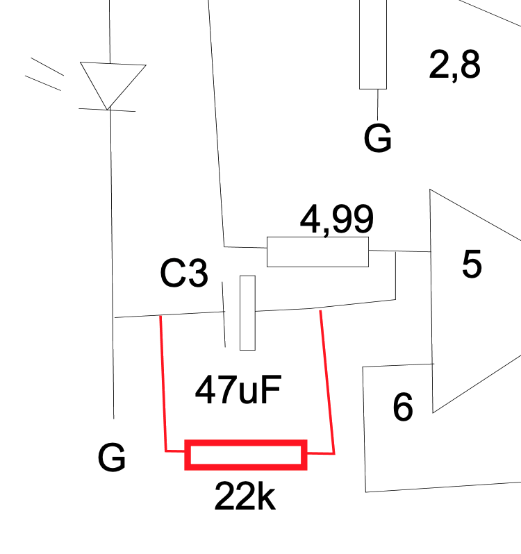

OK - so I reversed the connection so that the Mic+ goes in to the + on the board.
Then I did proper measurements out from the Mic - forget all other above.
This makes sense even for me 😉
Mic / Diod / No-Diod
+ / 2,05 / 2,05
- / 2,98 / 2,35
+ / 2,05 / 2,05
- / 2,98 / 2,35
So with the diode shorted, after a few minutes, it's + 2.05 V, - 2.5 V? If so, then a resistor of about 22 kohm...24 kohm across the filter capacitor of the diode stack should correct it. (Assuming a shorted silicon diode, so the "stack" only consists of an LED.)
Great - soon to be tested.

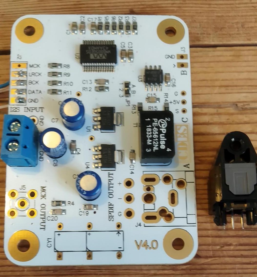

Hmm, room is limited... Ian IO board is big.
Marcel, I have an other board lying around... what say you - possible to use do you think?

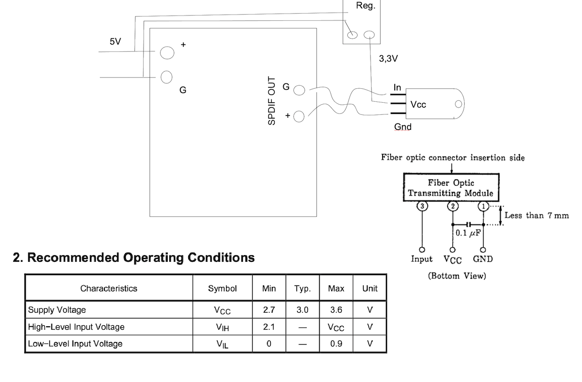

It says s/pdif out but can I connect an opto TX to that directly and if so, how?
Is this a good start? Or a working one?
Or is the problem that that board will have a signal going 5V i.e. to high for the TOTX141?
Like this...
Now that I'm getting near I don't want to break anything... 🙂
The
G
Is this for AES/EBU balanced i wonder?
Do I use only G and + I suppose?

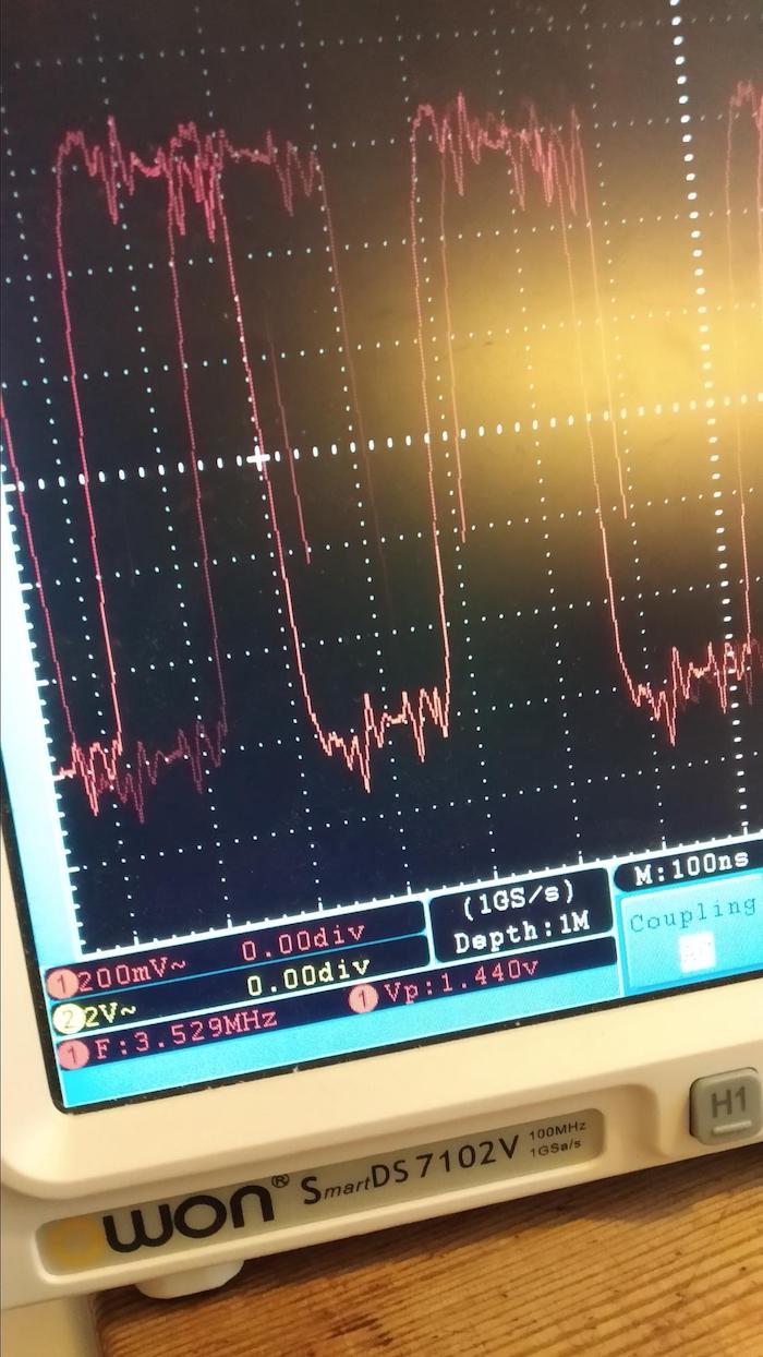

Could be, but maybe it's just transformer-coupled S/PDIF. Can you find more information about the board or measure with a scope what kind of signal levels you get?
The voltage swing and DC level of S/PDIF are not suitable to drive a CMOS input, that's why I suggested AC coupling and biasing around the trip point in post #322. Maybe it's better to use 10 times larger resistors and not terminate the output properly, then you get almost twice the swing.
