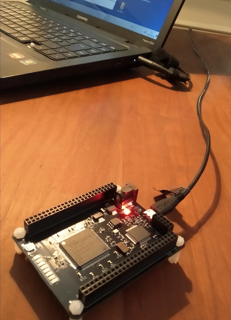

Same thing happened when I run the programming .exe file. The leds that where running as I hooked the board to a USB port for the first time stopped running and all LEDs went out. I suppose that means that the FPGA code was somehow changed. But the programming program has a progress-bar that never started to show anything happening.
What software did you use to make the program Marcel? And have you programmed yours?
I have a dual-boot computer, used ISE14.6 under Windows to generate a .bit file, chopped off the header with a hex editor under Linux, changed the name to .bin and programmed it into the FPGA board with a program of which I've forgotten the name under Linux.
The program indicated that programming and verification had succeeded and the LEDs on the board switched off. I haven't checked if it does anything useful.

When you loaded your board with the Mojo Loader, which I also use, did you indeed see the progress bar do something while loading it? How long was the duration of this programming procedure. What kind of indication did you get that it was finished?
Is there a way for me to understand if things went OK with loading except trying to start and see if it filters.
I'll start with 2. above - what is the gain by optimising this - relive the stress on the CMRR of the input of the EVM?
I think the progress indicator worked, but I'm not sure. The program certainly indicated that programming and verification had succeeded.

Took out my Win7 ol' laptop. Could event find CM & LTP settings panel... really strange... the Mojo Loader wants a COM port number but I cant find any COM ports.. on a windosw machine - world's crazy... 🙂
Yeeejj... after some Win driver language-code hacking I managed to install the driver and up came COM5 🙂 ... then watched the Marcel filter being flashed and checked what seemed to be successful.
Red small LED was lit... hmm?

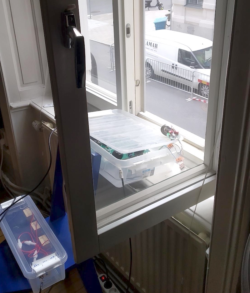

Below is a mono track of the street sound outside my window in central Stockholm. I gained it 30 dB. Even if mono, replayed on my system I'm quite happy with the "stage" and resolution.
Sound-file is in a .zip - please remove .mp4 extension...
