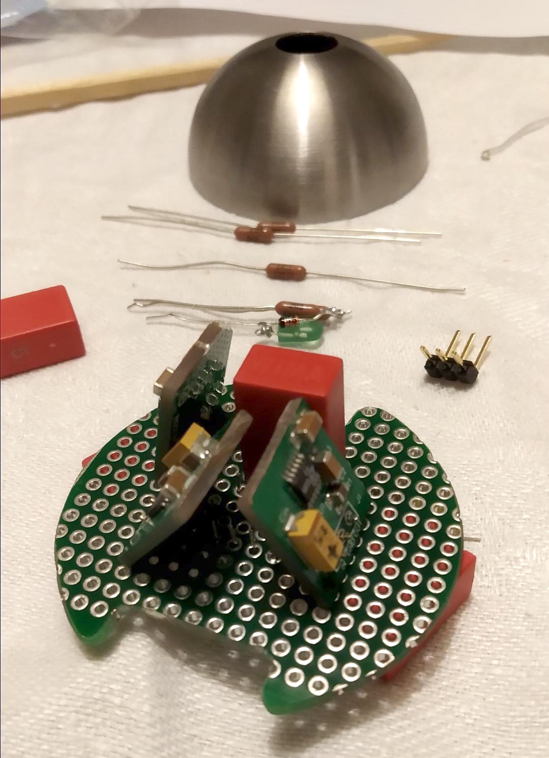

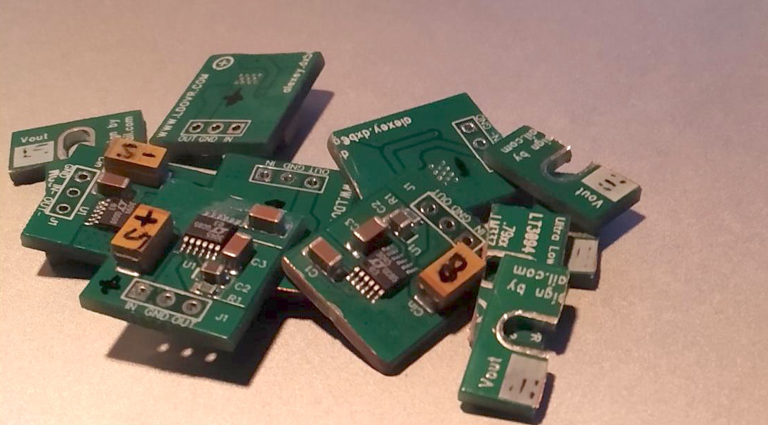

Not much happened... but I managed to decapitate the regulators in order fo them to fit in the spheres. also looking into cabling to the mics... Got some toslink transmitters which I hope can substitute one of the coax outputs on the EVM board with teh aid of some 3,3v and a cap... 5PCS NOS Toshiba TOTX141L TOTX141 TRANSMITTER MODULE FIBER OPTIC | eBay

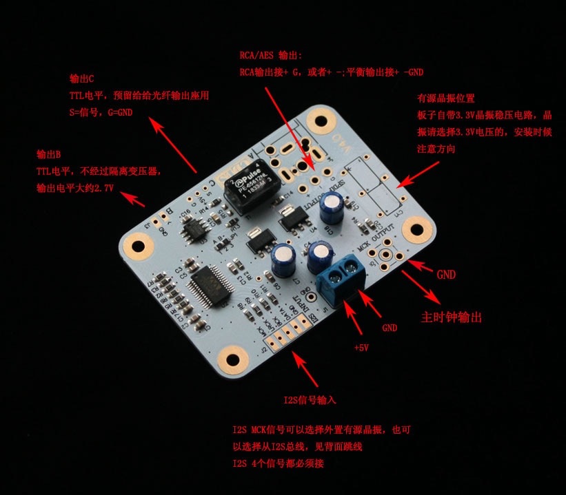

WM8805 I2S to SPDIF Coaxial, CD Player Adds Coaxial Output Support 44.1K 192K V4|Tool Parts| - AliExpress

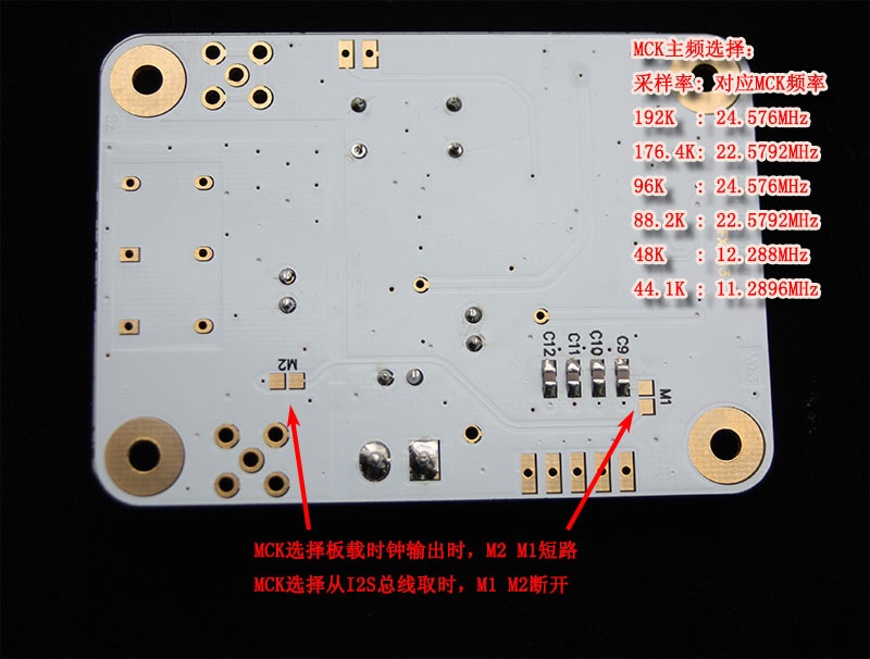

I suppose I have a Model 1 type board which has a MCK input along with the other 4 i2s signals...?
TX141L did not fit on the board... where and how to connect it?

No real manual for that board... and my chinese is limited. Maybe I have to ask for some translation help on the forum...

i wonder what master clock frequency it requires at 88.2 kHz sample rate. Apparently the WM8805 has a default master clock of 256 fs, see https://statics.cirrus.com/pubs/proDatasheet/WM8805_v4.5.pdf , while the evaluation module outputs 128 times 88.2 kHz via J6 pin 1. If you can find a way to get the undivided 22.5792 MHz out of the evaluation module, then you have 256 times 88.2 kHz.

But while I'm at it... the screen says s/pdif output and has 3 pins: "+", "-" and "G" (which is strange as s/pdif is "single end")
The TX141L has:
"G", "signal" and +3V.
How do one combine these I wonder...
G:G
+:signal
don't use board "-".
It says RCA/AES, so it could be that the signal is between + and -. I guess you need help from someone who is good at Chinese.
You need a trick with a capacitor and two resistors and a bit of luck to couple a real (rather than a TTL or LVCMOS) S/PDIF signal into an optical transmitter, but we discussed that before.

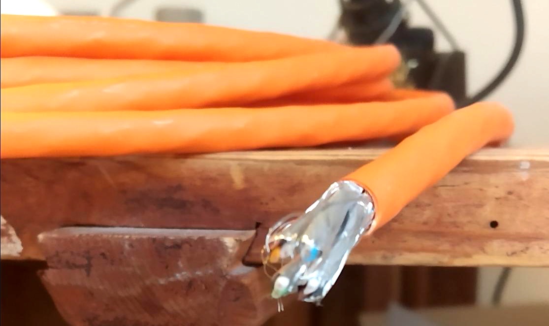

Did some necessary cutouts on the boards. Got cat7 cables with solid core pure copper (no alu ply) - stiff... usable... maybe...?
Set me out to have one functioning mic and the ADC box power on when Sunday closes... 🙂

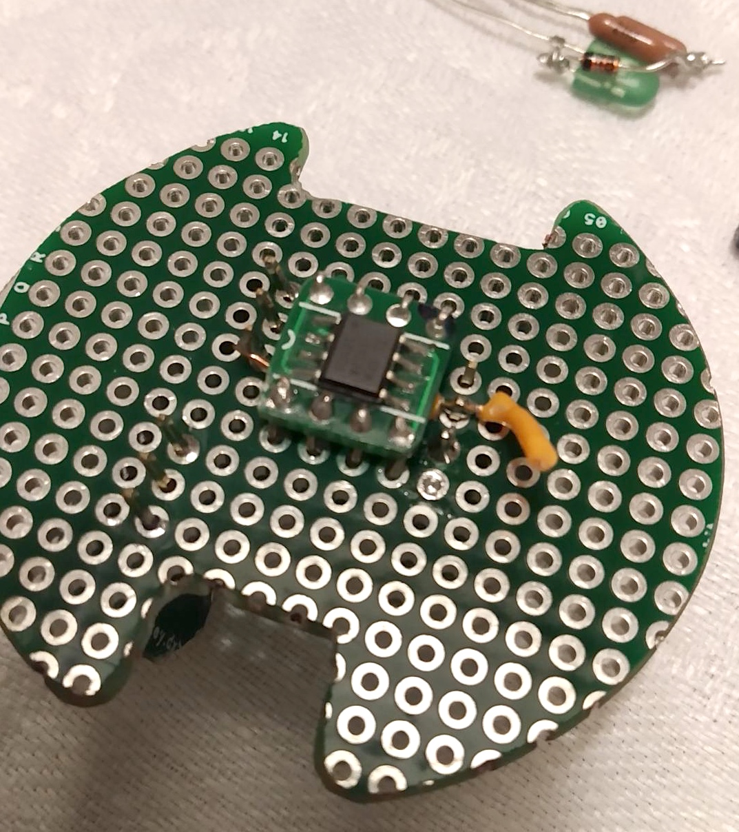

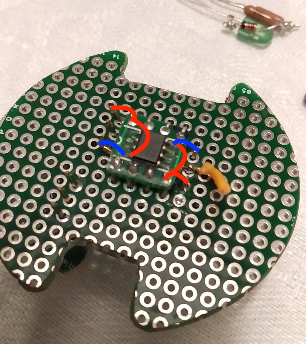

It's hard. 🙂 ... geting both miffed and psyched that I have such a struggle to build this simple schema. It is double side and a bit of 3D but still.. I gave up on trying to do a drawing and rather sat the OP amp and arranged the voltage feed to it in the best way acc to Marcels recommendations. The SOIC adapter twists the OP amp 90 deg and there is a "long" trace to leg 4 and 8 to the pins. I could save 3-4 mm by rotating the regulators and do short cuts from the regulator pin straight up to the OP amp smd leg (blue instead of red) - worth it?
I'm tired. More tomorrow...
