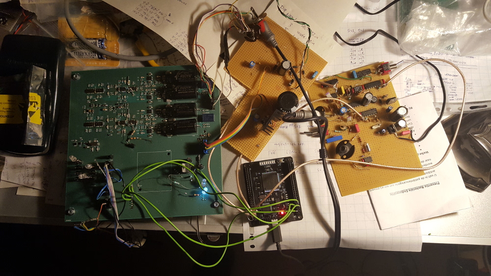

I did have a short of sort... it was the probe clip that touched 2 pins as i hooked it in... now I soldered to leads out from the pin header to hook probes to. OK - same level on both mod5 and 6.
No sound. To me, looks the same as before. 5 and 6 looks similar/identical...
Ah OK - no clipping LED lit now with new bin file - sorry!!! forgot about that improvement of the situation 🙂

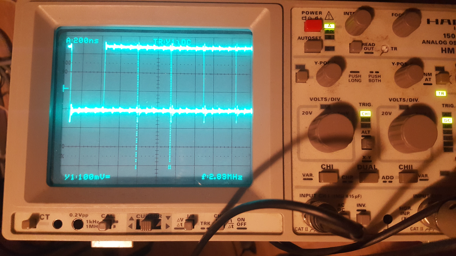

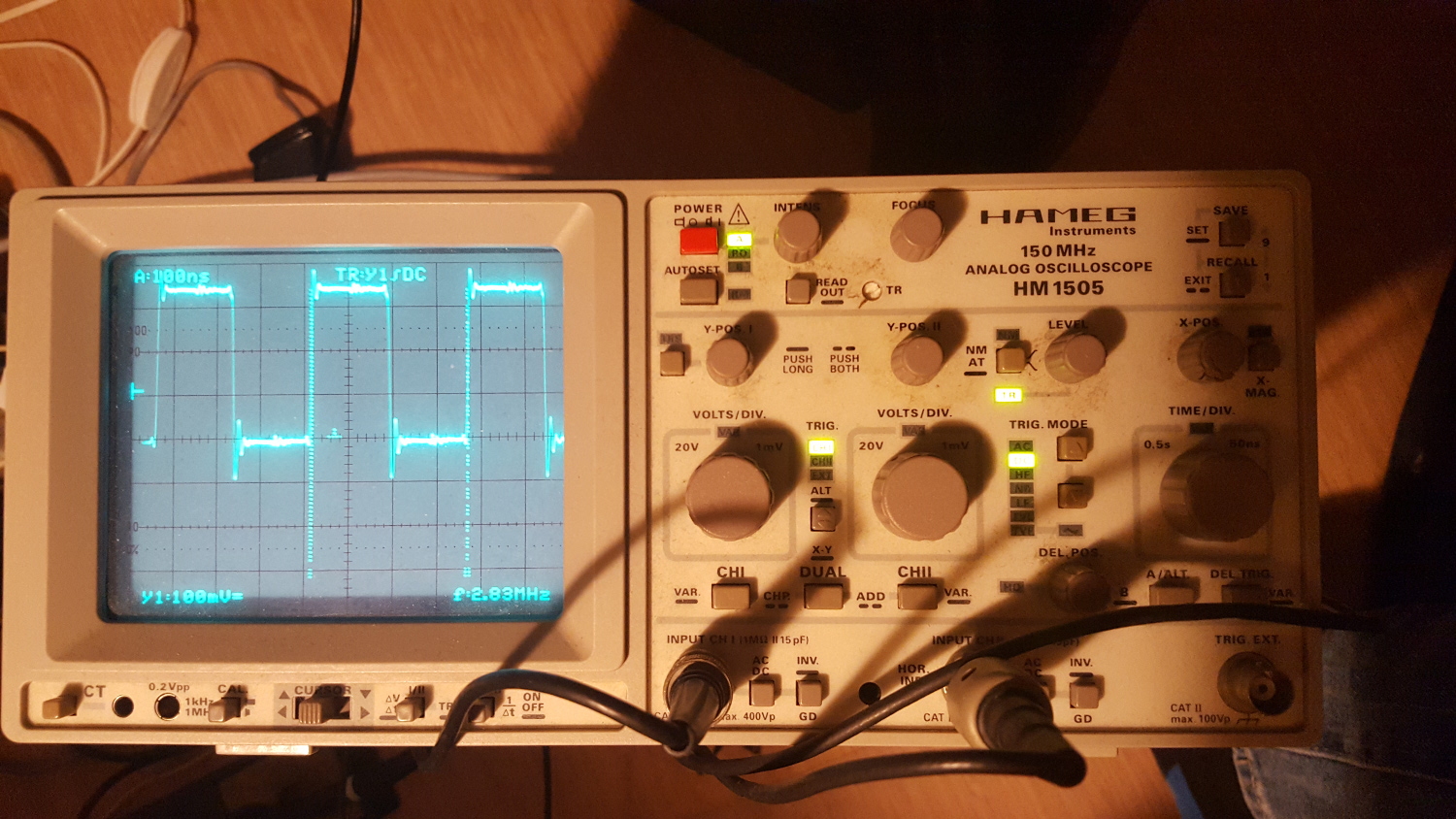

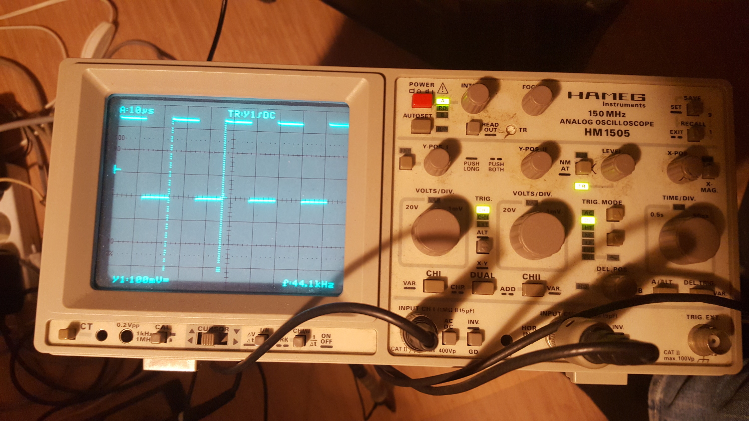

I'm doing the experiment with the sigma-delta modulator and it works, provided the clock is up and running before the FPGA module is powered up. It does not recover from clock interruptions.
I first checked whether pins 66, 57 and 58 of the FPGA make contact with pins 10, 8 and 7 of SV1, as they are supposed to, and whether there were any shorts to neighbouring FPGA pins. On my module, it was all fine.
I then hooked up my sigma-delta perfboard to the clock inputs and to data inputs mod4...mod1, with mod5 and mod6 tied low (as it's a single- rather than a six-bit sigma-delta modulator). I checked if the FPGA module produced an I2S wordclock, bitclock and data signal. Scope plots are attached. All frequencies are a factor of two too low because my makeshift sigma-delta modulator runs at half the speed of the PCM4222.
I then hooked up a DAC and checked if I could get audio through. This also works fine. Disconnecting the FPGA module's supply stops the audio, it continues when the red LED turns on after reconnecting the FPGA module's supply. When the supply of the sigma-delta modulator perfboard that provides the clock is disconnected and connected again, there is no sound until I disconnect and reconnect the FPGA module's supply. That is, the FPGA does not recover from a clock interruption.
The speed is half of what it should be and with my set-up, I inherently get the same audio left and right, but to the extent that I can test it, it works.

The clipping LED works, so apparently the clocks from the EVM and the modulator signals (or at least the most significant ones) reach the FPGA. On the output side, you have a word clock that looks fine, a bit clock that looks like a serial data signal and no data. If that were due to a wiring problem (or connector problem or FPGA module soldering problem), the data signal would have to be connected to the bit clock wire and the data wire left open.
If it were due to transmission line reflections between EVM and FPGA, I would expect the digital clock module inside the FPGA not to lock. It shouldn't do anything at all then, except turning on the red LED.
If it were on the edge between working and not working due to reflections or crosstalk between the digital signals, then the extra ground wires should have helped to some extent.
