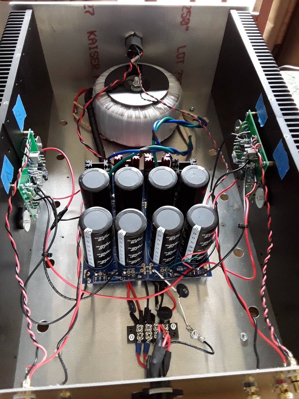

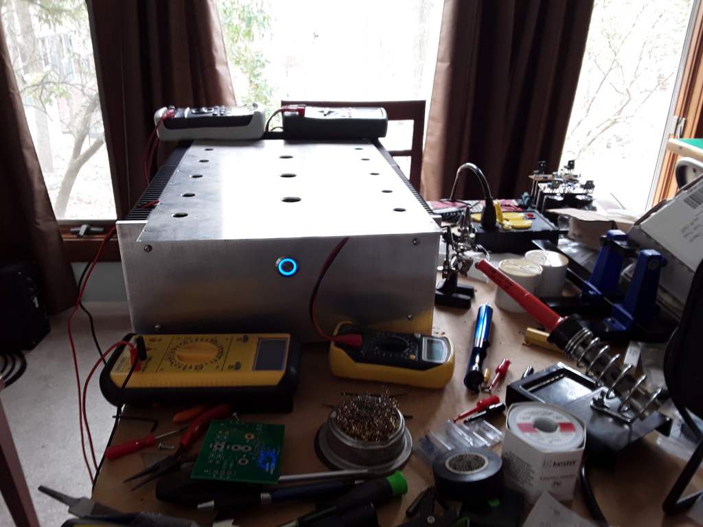

Joined 2000
Finished it less than a hour ago.
Still processing it.
It's the one with the blue button on the front.
I'll take more pictures when I put it back on the bench.
The matched quad p-ch jfets were 11.4 idss and the ccs jfet is 10.4 idss.
Is that a big problem?
When setting the offset, I had to make micro adjustments as the offset would jump in large increments. The trimmer is 10k. Used four semi-south R100.
Listening to it now and beginning to see what all the fuss is about. ;)

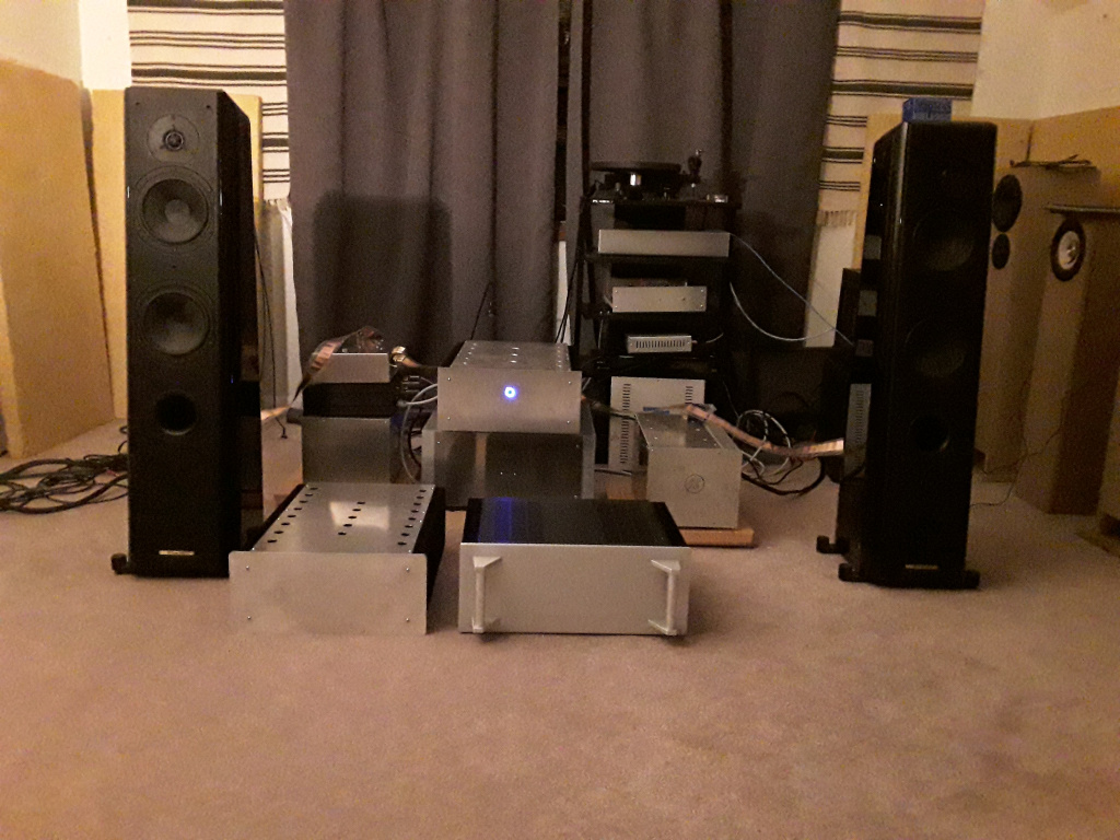

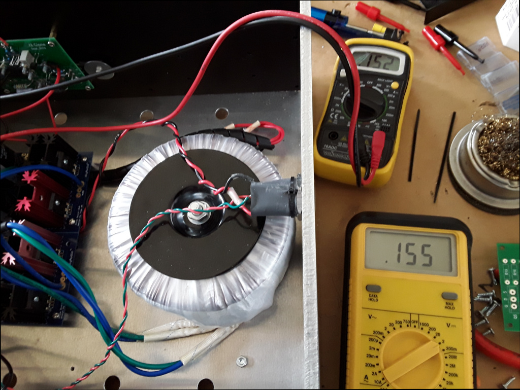

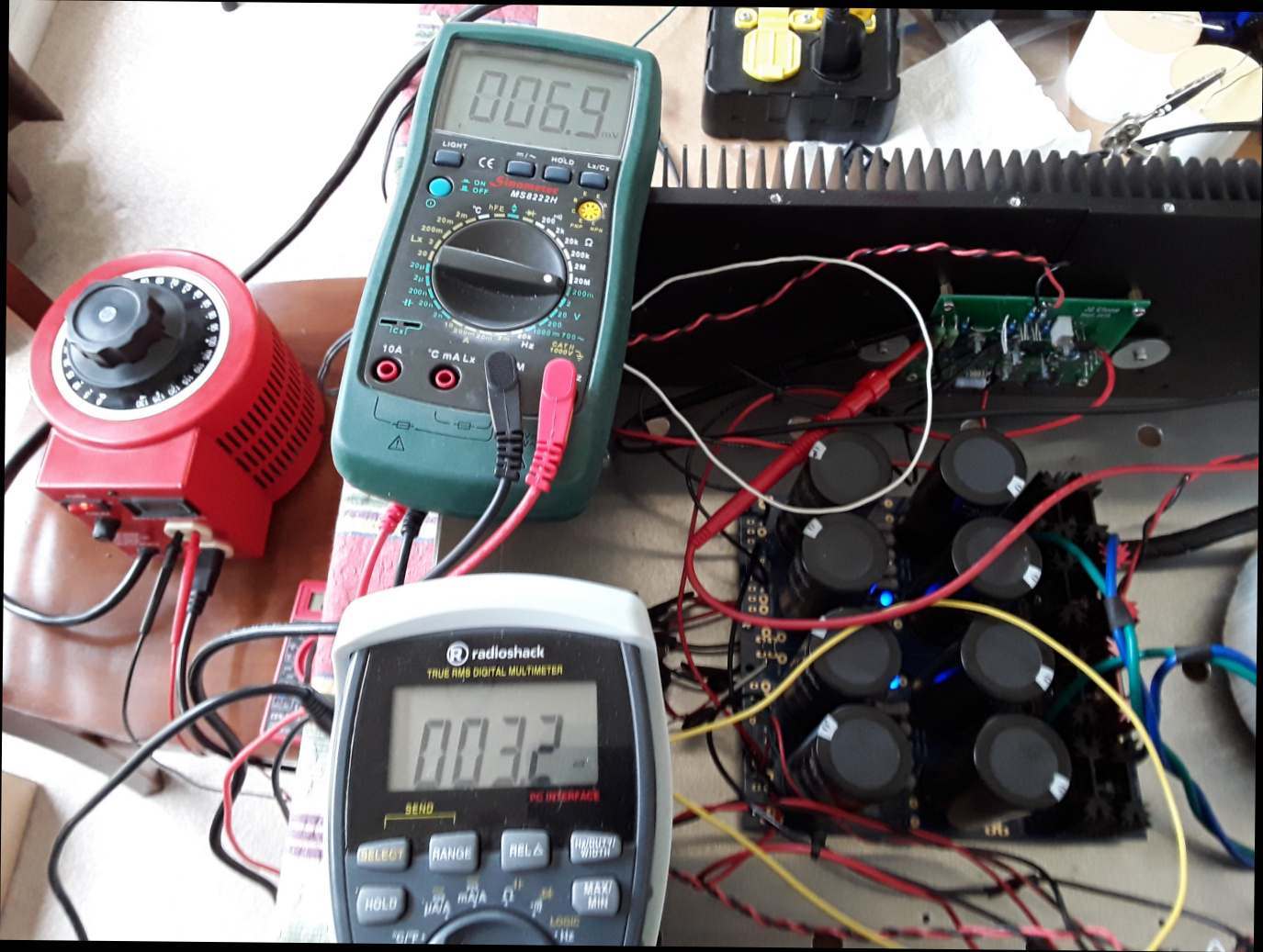

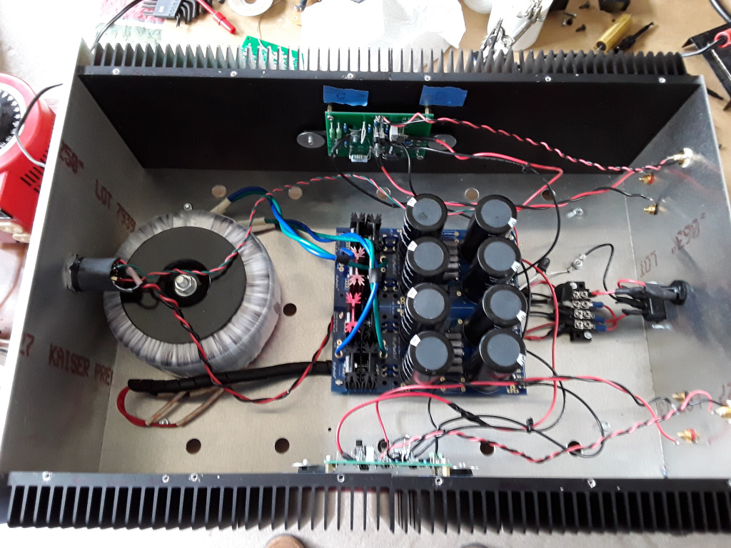

It's working. :)
First, Patrick thanks for putting this together and for Mr Pass for letting it happen.
Also, I very much like the screw connections. Negates the need to find odd connectors and it's a solid connection.
Really happy to finally getting to hear a J2. Sim, clone, exact copy or not, doesnt matter, it is a special amp.
Thank you Zen Mod for the trimmer value, setups like a champ! :D
The offset was dropping as the amp warmed up. Nice!
Thank you,
Vince
