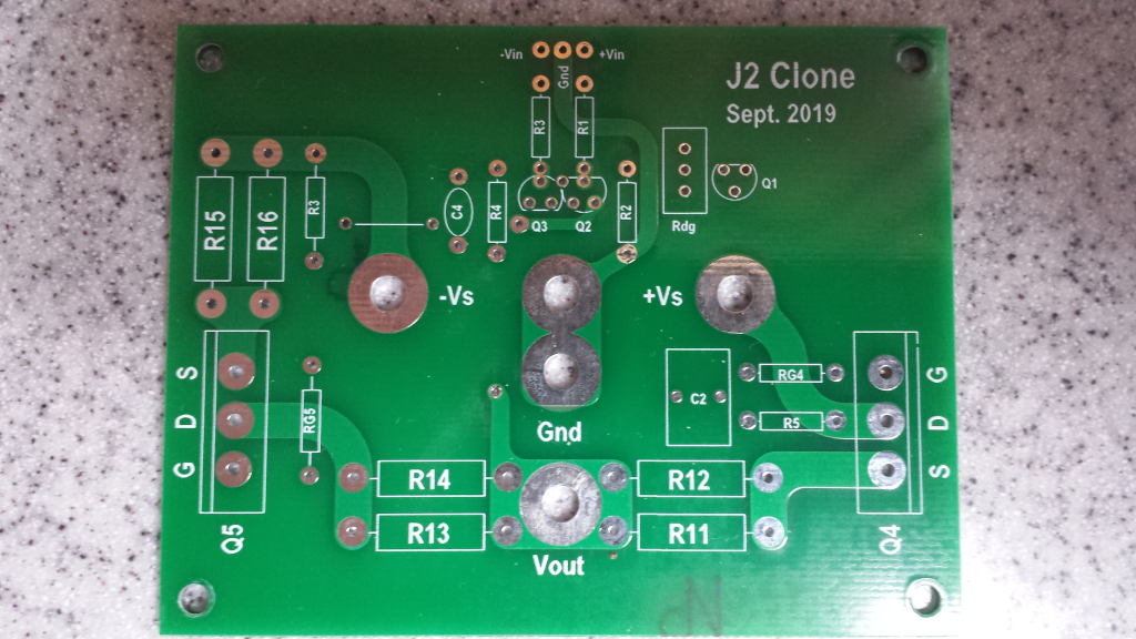

FirstWatt J2
This is the board. R3 next to R16 is now R33.
R33 value is 300 ohm 1/4w.
Finally my J2 clone is up and running
After many years of collecting components, I managed to find the time and courage to take the plunge to complete the J2 clone.
When I began, I wasn't sure if clone design would even work. It was a leap of faith and was willing to sacrifice the precious SemiSouths if something went wrong.
Managed to measure the IDSS of J74 and K170s in my stock and got the required matches. I was quite intrigued by the low part count in the design. Read lot of posts and figured out how to measure the current through the SemiSouths and how to use the matched pairs.
I had to dismantle my Aleph J build for the chassis and powersupply. Everything measured and worked like a breeze. Not a glitch or debug. First with cheap speakers and then my Tannoys.
Works beautifully with rich and detailed sound.
Shut the lid and start using. Will reopen if Papa publishes an official circuit.
Thanks to this forum for such a wealth of info, which helped me build the amp.
Cheers
Anil

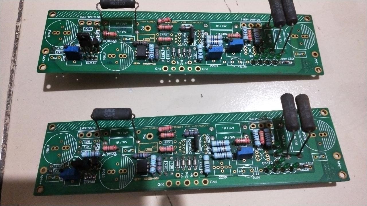

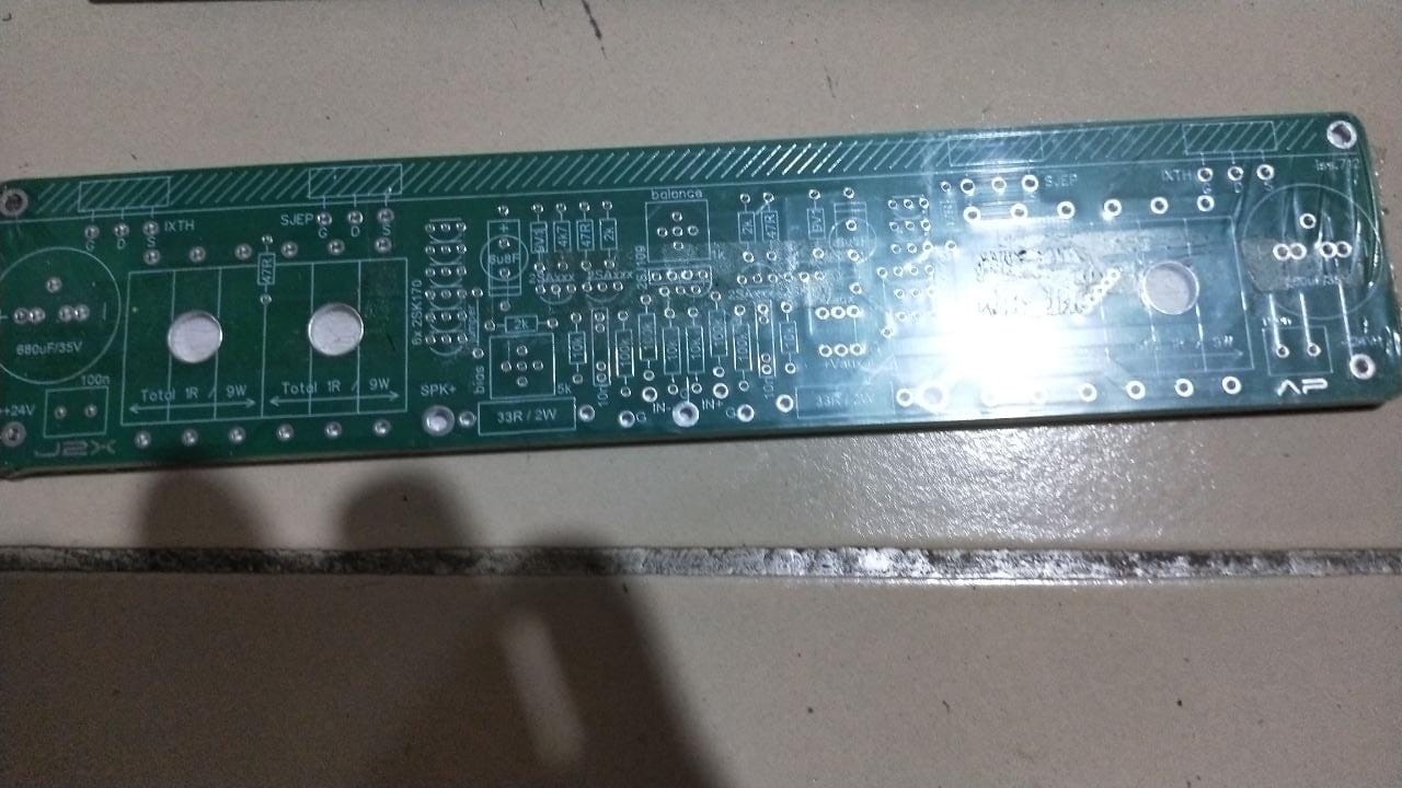

Anybody got some ideas of this 2 pcb what is the background?
Friend got a set but not sure how to complete it . Viable to continue work on it? Jfet semisouth is available
