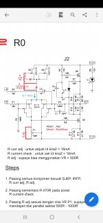

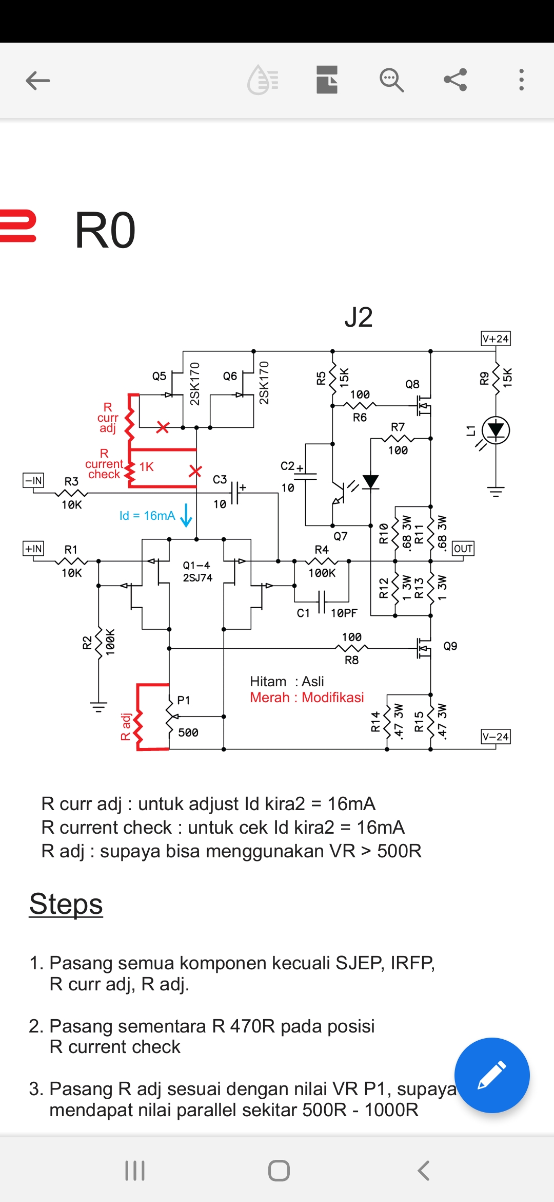

I'd like to compare my EVUL based J2 with a mosfets based J2. Here's why.
The J2 is a very satisfying amp.
I could get into what I hear, but I'm sure no one cares.
I think that if a mosfet based J2 were available, and comes close to the J2, more people could built it and enjoy it. I thought I might have been too ambitious in wanting to build a J2. I mean, how different could it be from a F3, F5 F4, F7? It's different, and it's fun listening to it
So my question is, can mosfets be dropped in place of the R100 jets without blowing up the output stage?
How much circuit tweaking would be required?
Thanks in advance.

Not sure if this helps but as per Nelson himself... See Post 1127 & 1130

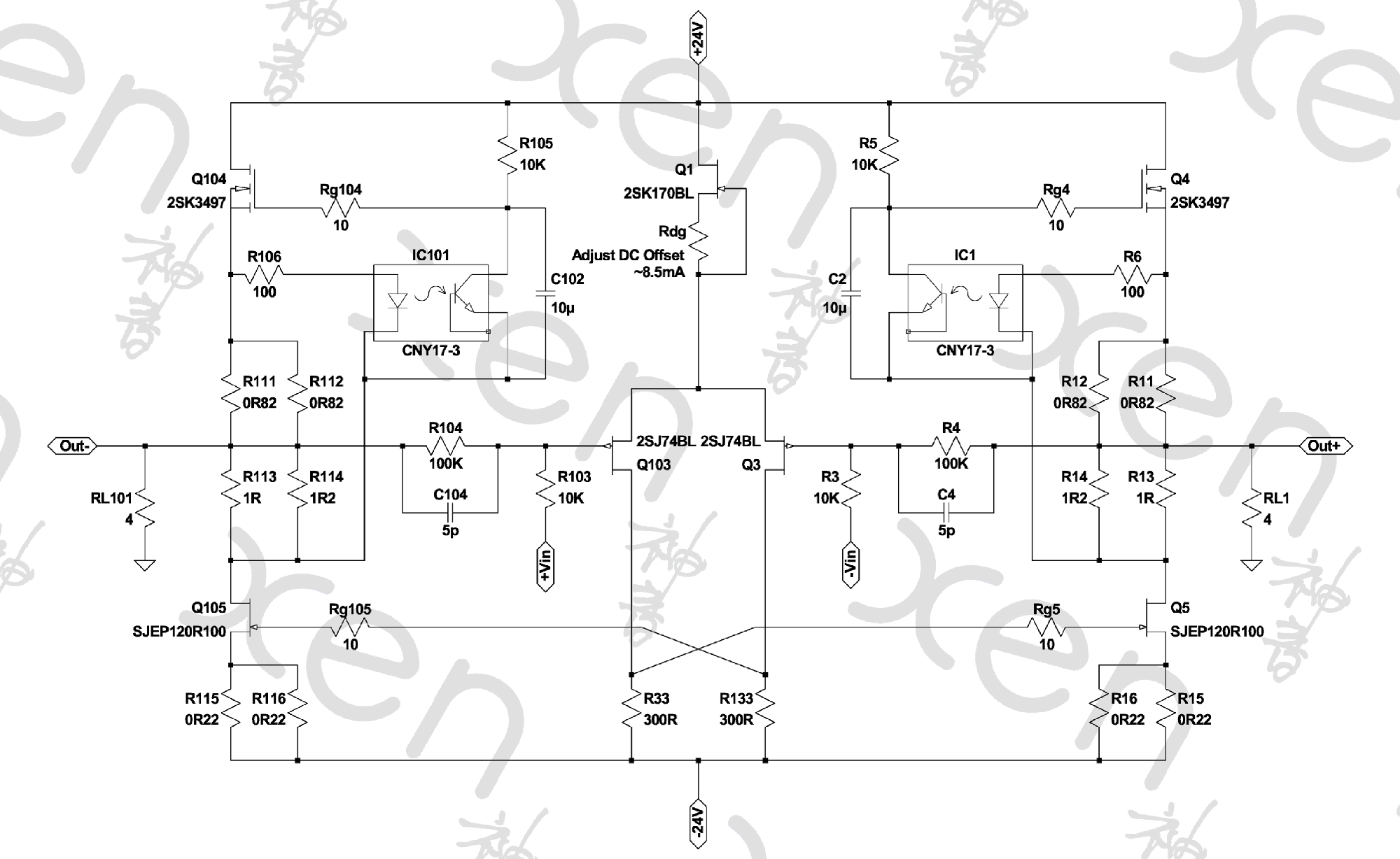

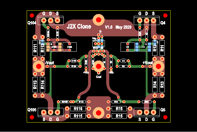

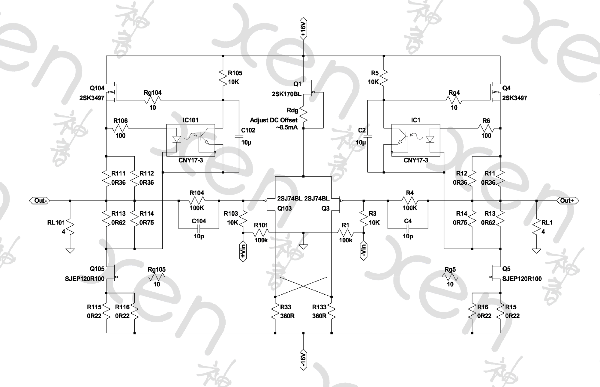

doing balanced UDNESS fix Issue with unobtainable part
would you please briefly describe 3rd and 2nd harmonic sound
> I think we were hoping for the J2X version.
Spiced that a long time ago.
It only works well if you have very well matched parts to cancel 2nd harmonics.
But the whole point of J2 is about 2nd harmonics, right ?
So why would you want to get rid of that by going balanced ?
And of course it will double your costs for SJEPs.
Patrick
