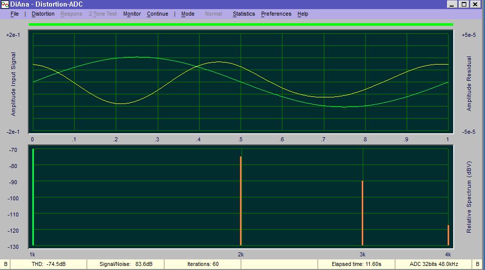

After 8 years trying to make nearly perfect J2......
You see in the first picture the state in the last years, h2 over h3 is o.k. with around 12-14dB higher.
But since the program Diana is published and we can see the residual as well, I saw that I have h2 with positive phase, second picture.
After some fumbling today with the source and drain resistors between the Semisouths I finally got the negative phase....what a moment!
Picture three.
The four SS were bought some time ago from Semisouthfan, as quartets. It seems they had greater differences in transconductance than I thought.
Now I must elaborate how the OLG changed, because the sound depends a good deal how much loop gain (difference of OLG and CLG) exists.
Maybe I have to change the feedback resistor and the CLG value.
I can only recommend to check your builds with Diana.

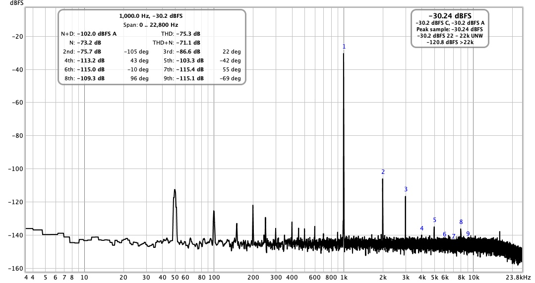

Yes, I use Diana for the residual and phase presentation and the REW for the distortion pattern. REW has more functions and the better presentation of the THD pattern itself.
As you know, I suppose!
:cheers:
Soundcard is a Focusrite Scarlett.
Indeed! I need to have a look at Diana - seems like a very nice solution. I ask because I noticed the higher order harmonic details looked very similar to my build of ZM’s babelfish J2 and I was unsure how much my sound card (Focusrite Solo) was at play.
Your measurements and discovery are impressive - well done!!
