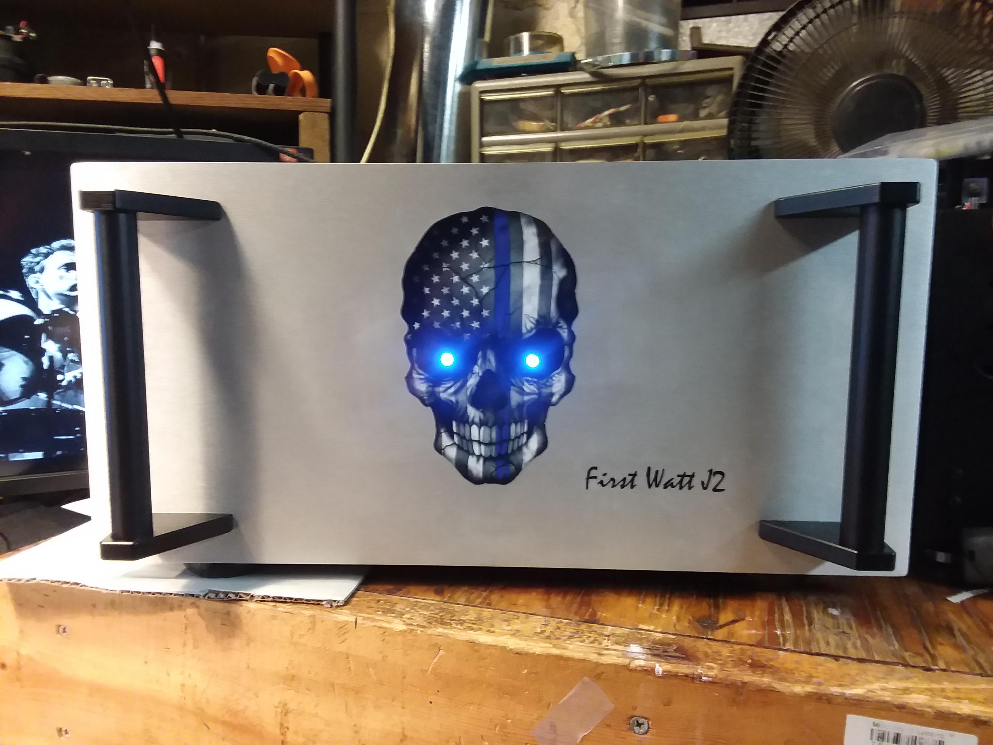

Love this J2, running it out of the PC to Singxer and HoloSpring Kitsune to DIs and they are singing even built for 8R running around 6R probably dropping to 4R.
Near field 80db half volume from PC
It's the little amp that could!
